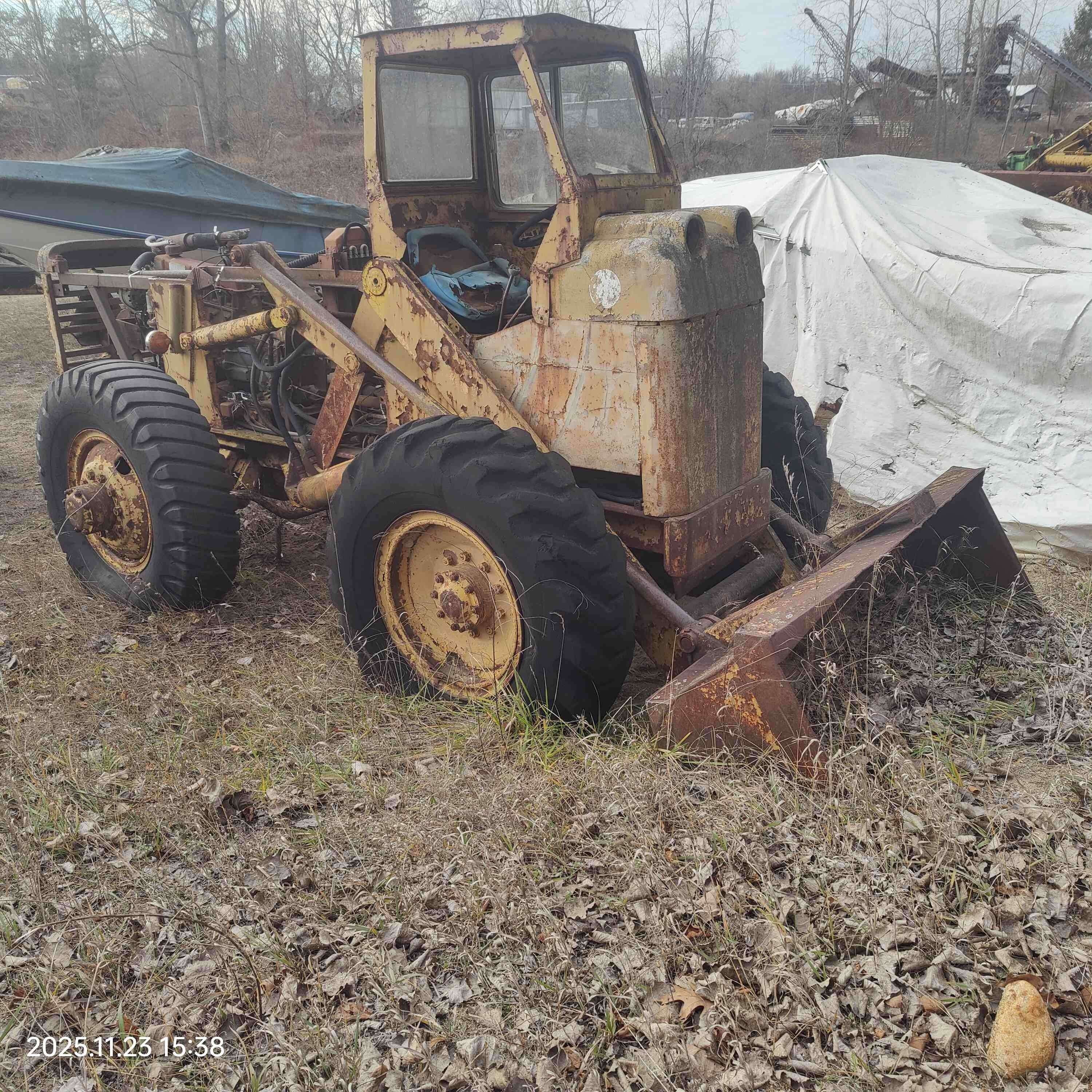

I have a modified TL-12. SN#50 I also still have a TL-20D I'm scrapping.
I've owned my TL-12 since 1979. It's seen a lot of work. The original engine broke a crank in 1980 and the torque converter was damaged because someone didn't install the thrust bearings in the engine. I changed it to a 240 Ford with a C-4 transmission. I installed a new 30 gpm  pump. I fitted a self contained power steering pump from a large truck. The 240 engines were too high a compression for full throttle while digging and beat them selves up with detonation so I built a low compression 300.I was working with the engine when they all seemed to have vacuum only advance so built a distributor with centrifugal advance. After fighting with electric cooling fans for several years I switched to driving the engine cooling fan and power steering pump with a line shaft. The original cone clutches could not handle the power from the 300. They had to be adjusted so tight that it required too much effort to shift fwd/reverse. So I eventually deleted the cone clutches and use the auto transmission for fwd/reverse. The spline shaft inside the cone clutches is the same as a tractor PTO so I only needed to make as steel disk with the clutch mounting bolt pattern and weld a PTO shaft adapter inside the disk and bolt in place to lock the clutch shaft to the drive gear. I built a selector for the auto transmission shifter that allows choosing gear stops for rapid shifts into preset fwd gear ranges. The Ford engine and transmission with front mounted hydraulic pump are so long that I had to make extensions to mount the counter weight.
Had an employee really reef on the steering wheel and broke the ball nut gear on the steering shaft about 1985. Bought a new one.  I rebuilt the lift cylinders with new tubes and shafts back around 1990. I've repaired the steering knuckles and relined the brakes. It needs the wheel cylinders bored and sleeved or replaced. I'd like to add a hydrovac for more braking power.
I had to buy a replacement differential assy some 25/28 years ago. Conroe Tractor in Conroe Texas is where we got an absolutely great differential assy. From what little wear I saw on the differential, I wished I owned the rest of the machine.
