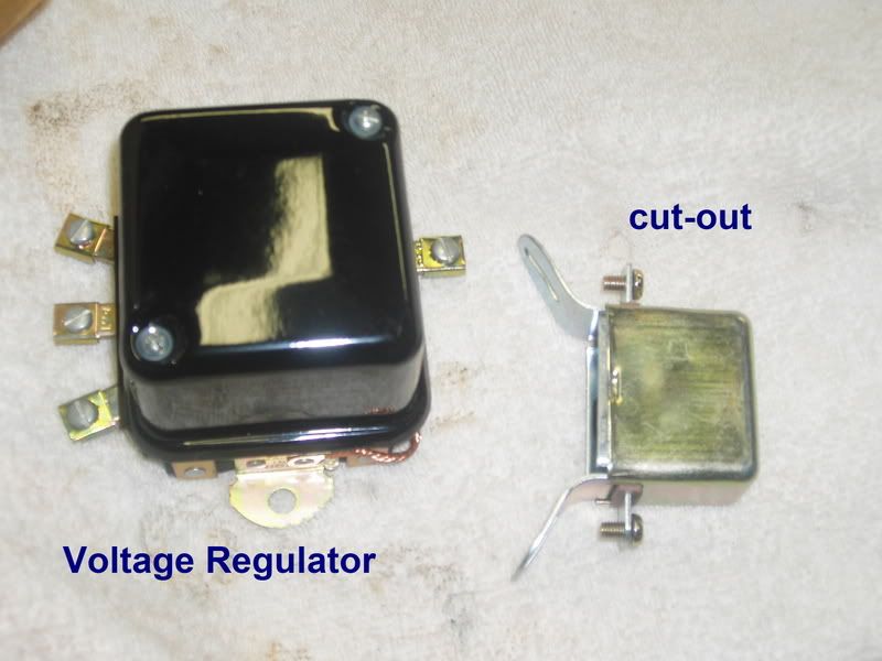

 There was no voltage regulator on a G Allis. If you have one, the whole system has been changed so there is no way for anyone here to diagnose the problem.
 As mention previously, the cut out relay CAN weld itself shut, causing the generator to act like a motor any time the the battery is hooked up. Remove the fan belt and hook that wire back up that caused the spark. Does the generator spin then?

Ok....it is a cut out relay. They both visually look the same. My bad.

JoeM(GA) View Drop Down

Joe I clearly see the difference there but the farmalls use one that looks like a VR. Pretty sure mine looks original except someone added a VR. I can get pictures soon
