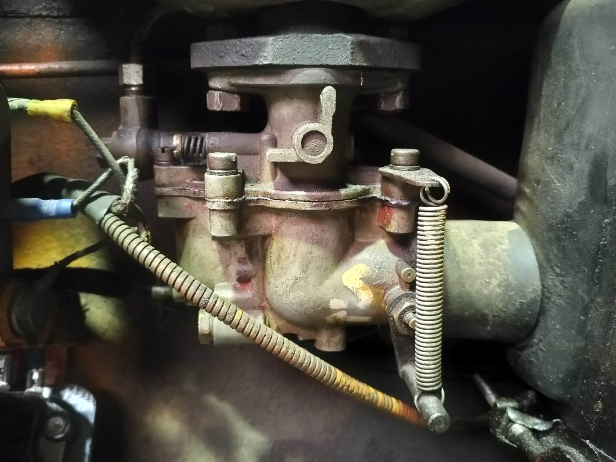

I only have one small problem with it now, the choke has to stay a little bit closed to keep it running, when I open the choke completely the motor drops dead
I hope a good clean of the carburator will help
Or the felt air seals for the choke shaft...Wink
Do you have a parts number for the felt air seals please?
Is it any of these:
It looks like they are there, the 2 items to the right of the gold colored shaft...Clap

No letters/numbers on the carb, can anyone tell me if this is a Zenith or a Marvel Schebler carb?

Zenith

That is a Zenith, but I have never seen that style on a B. If you look at where it mounts to the manifold, it looks smaller than it should be. I wonder if it came off of something else and is not the original carburetor... Unless that is what Bs built in the UK used?
According tot Google the UK build B's have a Zenith 24T2 carb, and mine looks like it think

that model is popular in the USA, but was not used on the Alllis..... Several sites list the carb..
