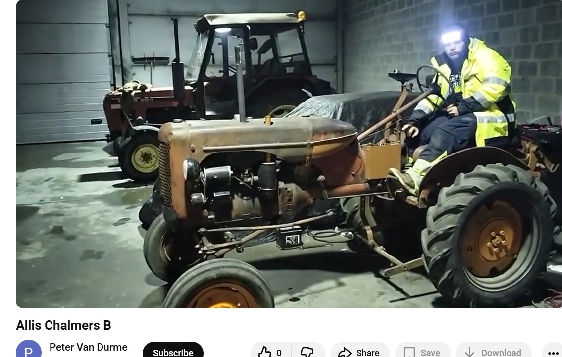

I'm Peter, 54 years old and located in Belgium.
I started a rebuild project together with my 18 year old son, an Allis Chalmers B
It runs and drives, but not as it should, so we got a little bit of work in the future
It's already converted to 12 Volt
When I find out how I will post some pictures on the forum
I don't know if this works:
http://youtu.be/sx1m97ZFVPk" rel="nofollow - http://youtu.be/sx1m97ZFVPk

thats a good looking little tractor.. You have the optional 5  bolt rear wheels / hubs... Most of the Bs had a 2 inch spline shaft that the hub was mounted to..
Good luck.. This is a great place to ask questions..

Interesting rear wheels,has the center nut like the older B's but the centers are different from anything I have ever seen.Maybe something offered in Europe and not in the USA?Very neat tractor.
Posted By: steve(ill)
Date Posted: 11 Jan 2026 at 8:27am
your right Gary.. I had to blow up the photo to see the nut.... I THINK there were 3 versions of the axle... one had the center nut, one had the 5 bolt flange, and a third was an ADAPTOR hub with 5 bolts that slid onto the original taper spline shaft... That is apparently what he has..
normally the 5 bolt flange came with the straight adjustable front axle as compared to the wishbone axle.. hard to tell in this movie..

here is a snapshot of your You Tube video...

It is a requirement back then that tractors sold in Europe had to have flanged axles to bolt to the wheel.
I wish I could find the source of that info now.
