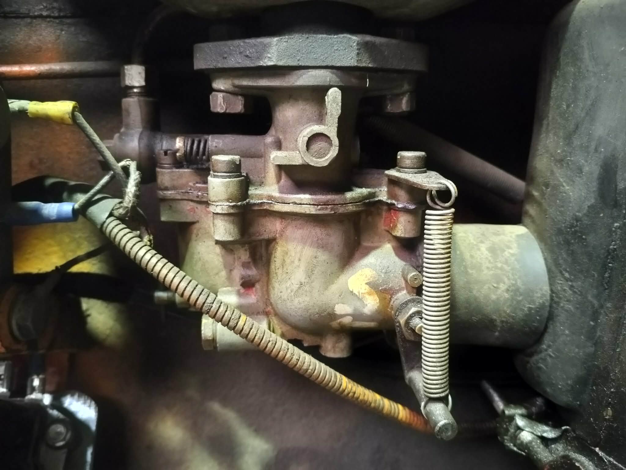

Post Options Post Options   Thanks (0) Thanks(0)   Quote PeterVD Quote  Post ReplyReply Direct Link To This Post Posted: 1 hour 45 minutes ago at 6:31am
No letters/numbers on the carb, can anyone tell me if this is a Zenith or a Marvel Schebler carb?

Post Options Post Options   Thanks (0) Thanks(0)   Quote Gary Burnett Quote  Post ReplyReply Direct Link To This Post Posted: 31 minutes ago at 7:45am
Zenith
