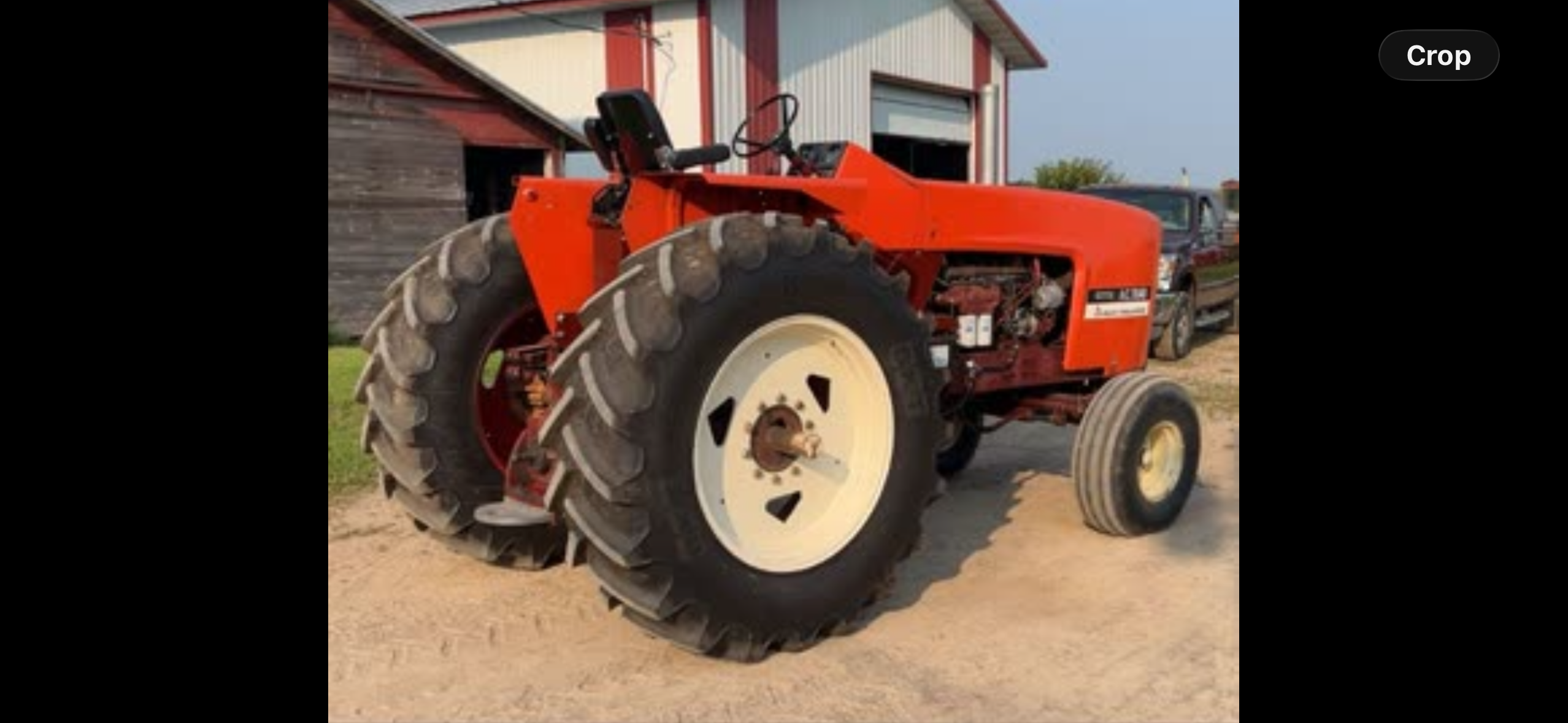

Good morning Orangemen. I am doing some research in hopes to find a powershift clutch pack for my 7040 that I could swap into my pulling tractor in case of failure. My tractor is a 1976. Any assistance is appreciated.

Torque limiter has bolts to prevent slipping. I've pulled it 5 or 6 times successfully. I have not turned up the PS pressure yet. I did test all PS pressures and they were all around 200 psi.

I don't know if you have Facebook but here is a link of me pulling. Wasn't the greatest pull. I lost boost at 200 feet because I slowed down when I broke 6 mph limit. I was pulling at 10,500. I also need to shift more weight to the rear.
