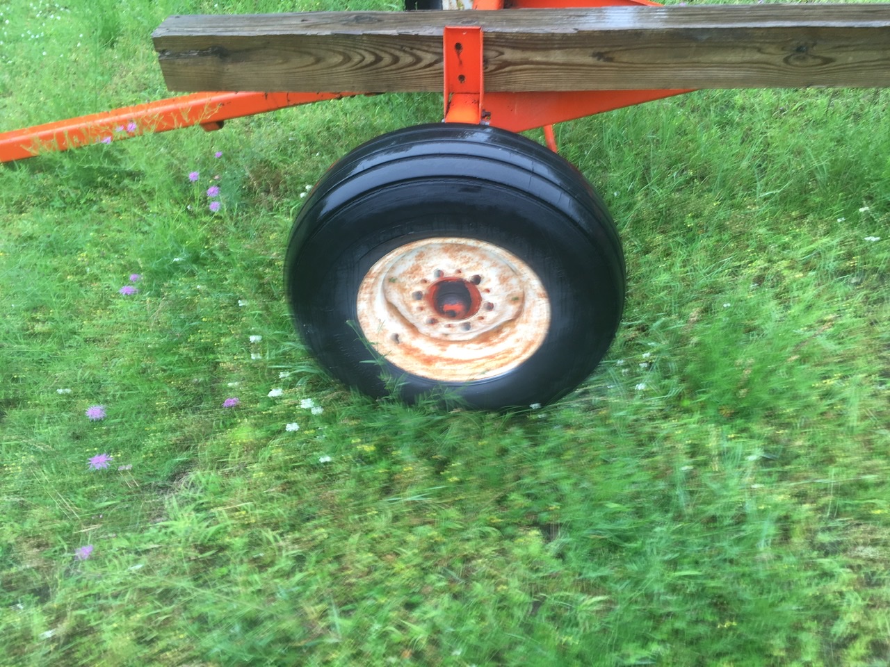

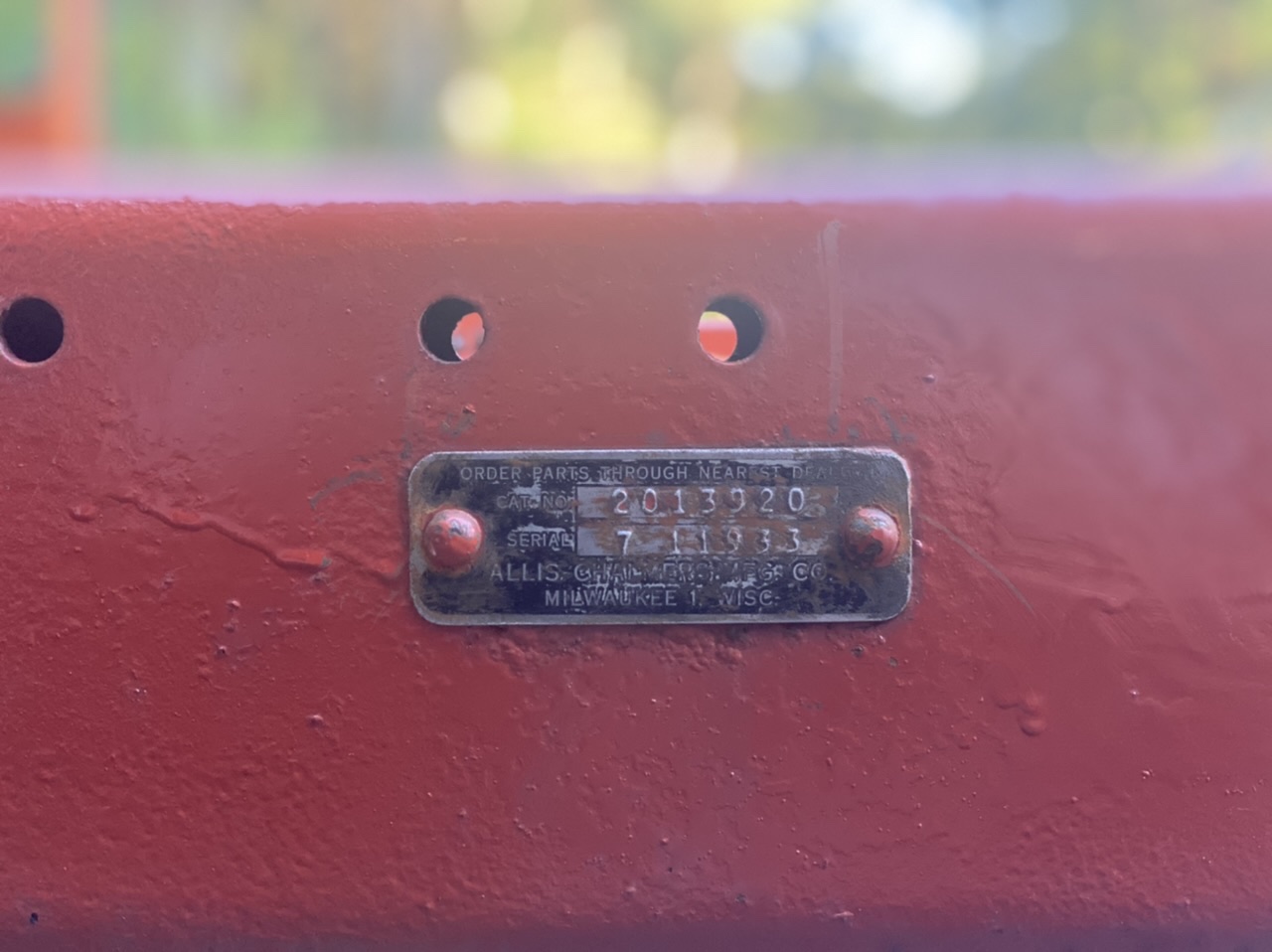

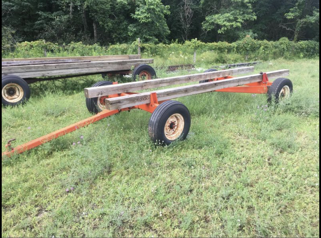

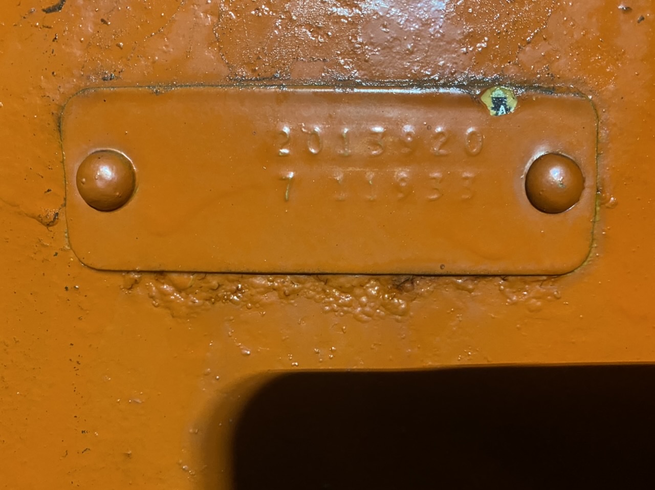

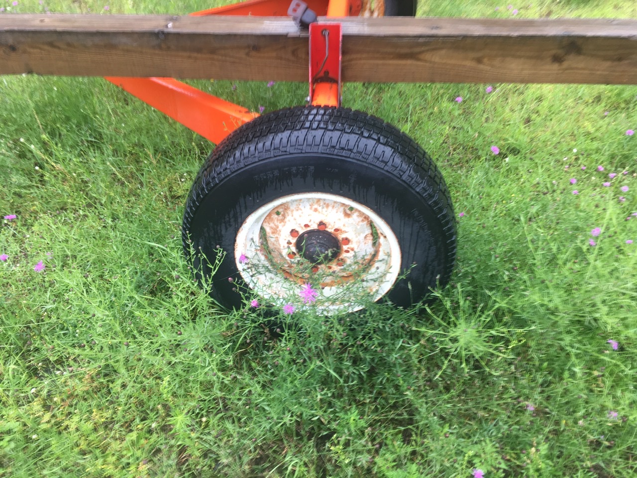

I’ve enjoyed learning a little bit more about the Allis Chalmers’ running gear models. I came in to one quite by accident. When I got this home I found the ID tag under several layers of paint. Trying to learn more about it and want to try to bring it back to its original condition for use in hayrides. Not quite sure how I’m going to build it out. I am curious about what style/brand tires would’ve been original. Only two of the four wheel hubs have zerk fittings in the caps. Not sure if that’s original. Also one wheel was replaced. The stem comes out from the inside on that one. Any thoughts would be appreciated. Thank you – Ben

4847v
Stockman (Ben), your wagon gear’s ID tag reads, “cat no, 2013920” which corresponds to an AC 701 model. It’s ID’s other info reads, “serial 7 11933” corresponds to it being a 7 ton size with sequential number of 11933 which positions it near the beginning of its production run (11482-14042) which began in 1965ish or there about? I say that because it received the “newer AC triangle logo” decal which debuted in 1965.
The AC 701 gear could have been supplied with a number of tire/rim options. It's August of 1966 sales brochure list the following wheels(rims) sizes (Inch diameter x inch width) then probable tire sizes;
14 x 6, (G78-14s,8.5-14?)
15 x 6, (9.5-15?)
16 x 6.5, (7.5-16?)
15 x 8, (11-15?) flotations
15 x 10, (11-15,12.5-15?)flotations
15 x 5.5 (6.5-15?,7.5-15?)
Your grease zerk hubs would have been an add-on as I don’t believe that to be original.
All hubs & wheels should include a common “EWC” stamped ID.
EWC Q709 is their hub ID.
Their spindle size is 1 3/4” welded into their frames. The Q709 bearings are as follows;
1 3/8” LM48548/LM48510,inner
1 1/4” LM67048/LM67010,outer,
N41461S(National), CR 15190(Chicago Rawhide), 901283, hub seal.

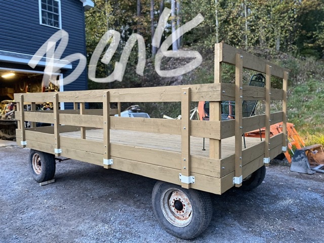

Appreciate that information! I did build it out and currently have the same wheel configuration as when I bought it. If I ever have to change the tires I’ll probably double back on the wheel question. Thanks again for the input

Nice!  Thanks for sharing the pic!  Stockman is correct, I never saw any hubs with zerks.  Those would be an add on or a replacement. Not original.    Luv seeing these wagon gears brought back to life!  It is appreciated!!

You're welcome Ben. Congratulations on your nice AC 701 wagon build. Is it setup as a people hauler? Here is a photocopy of the 701's spec sheets per its 1966 brochure. It list most of it's wheel options.

Post Options Post Options   Thanks (0) Thanks(0)   Quote Stockman Quote  Post ReplyReply Direct Link To This Post Posted: 26 Dec 2024 at 7:36pm
Yes, a people hauler. Kept under cover except the month of October.

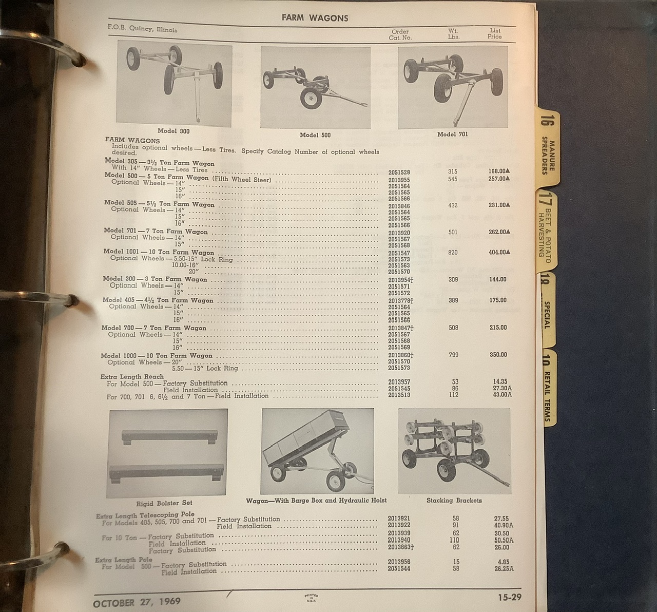

Post Options Post Options   Thanks (0) Thanks(0)   Quote Mikez Quote  Post ReplyReply Direct Link To This Post Posted: 26 Dec 2024 at 9:16pm

Mikez, Thank you very much for sharing your AC dealership’s 1969 wagon list sheets. That is fantastic! 5542v

Points: 8901
Post Options Post Options   Thanks (0) Thanks(0)   Quote Mikez Quote  Post ReplyReply Direct Link To This Post Posted: 27 Dec 2024 at 7:06pm
Your welcome.
Can you read it ok.

I’ve been studying Mikez’s 1969 EWC Quincy IL Farm Wagon price list offered to AC dealers.
Trying to figure customer’s final charge for a new 1969 AC 701 gear. Assume in 1969 that a set of four 14” implement tires may have cost $80(20ea)? If so, then a 1969 dealer may have had the following fees associated with it;
AC 701 gear @ $262,
Shipping from Quincy @ $50 ?
Set of tires @ $80 ?
Shop labor assembly @ $40 ?
69’ shop labor @ $10/hr,
Dealer’s total cost : $442. ??
What do you think?
