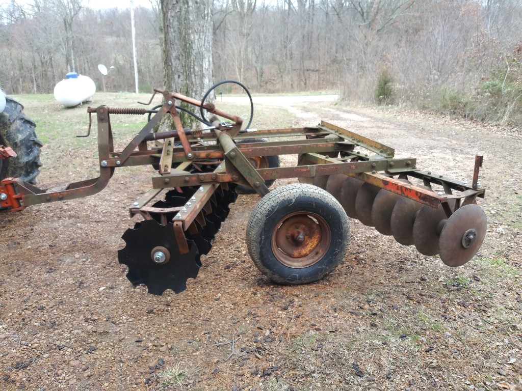

That's coming along nicely!

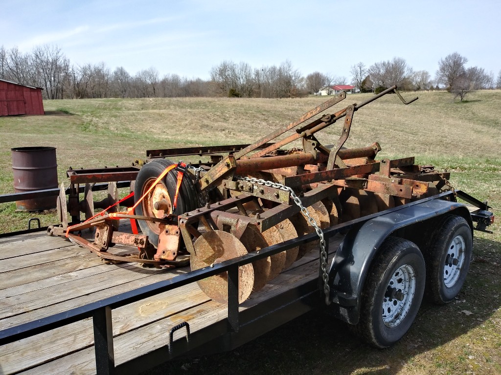

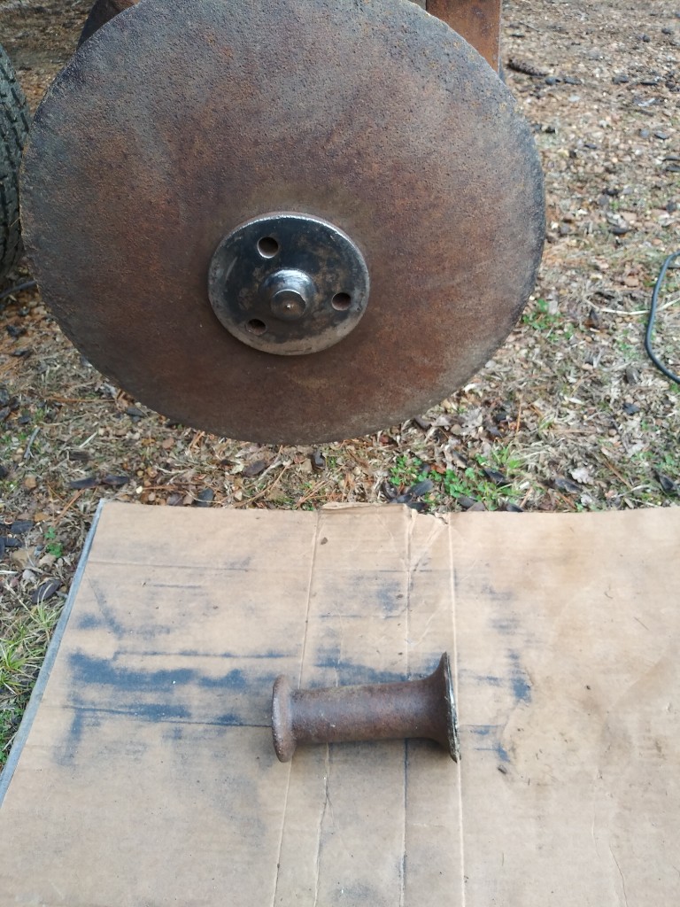

I don't think I have any choice but to carefully cut these off. I don't believe these are real furrow eradicators anyway. Look nothing like the ones in the parts book.

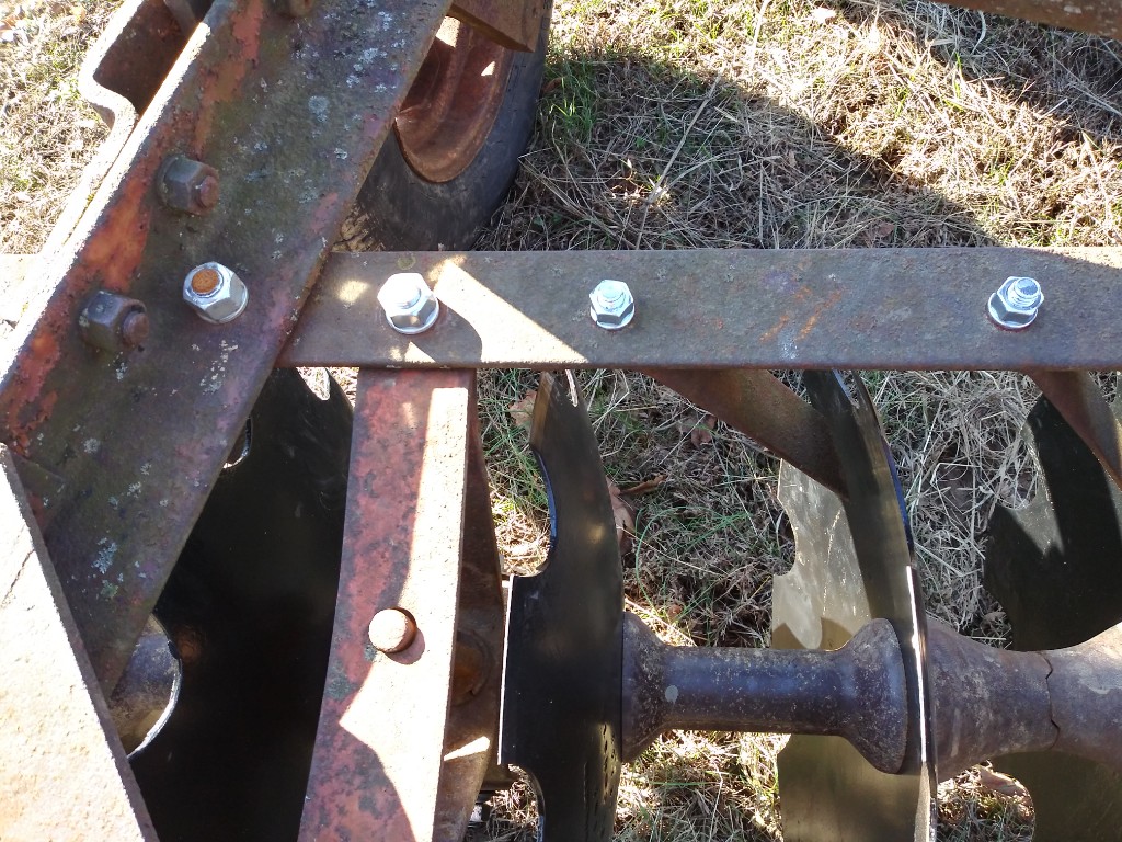

Blake,
 That front gang is new and ready to go! Great job bringing this set of discs back into working order. That weld on the rear looks pretty good. Not all goobered up like some things we have seen.

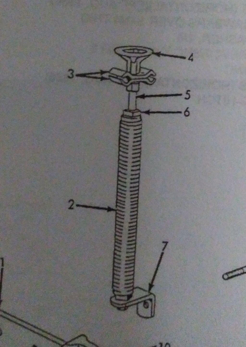

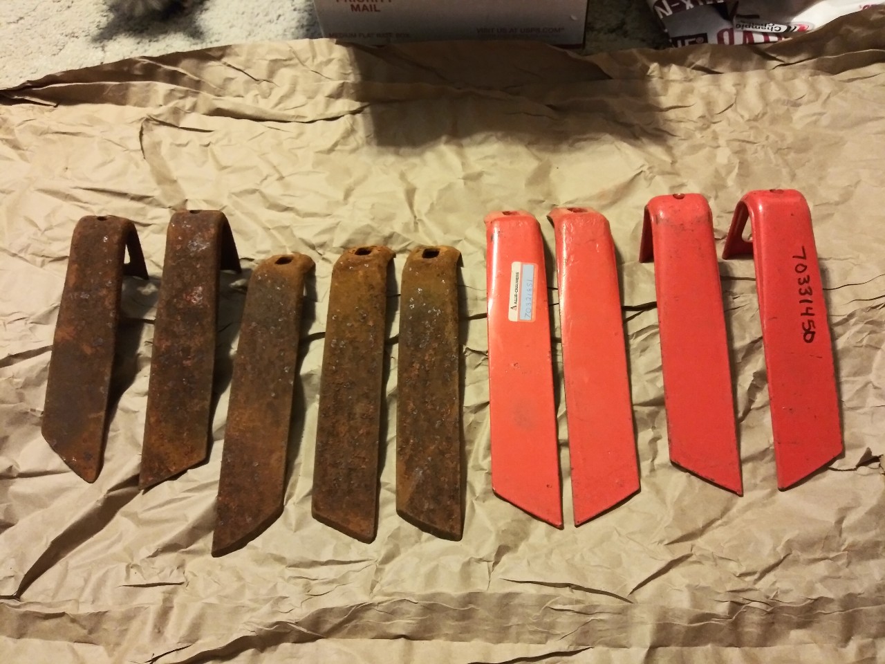

Went out today and straightened and adjusted all the front scrapers. I need one each of #5 in the picture for the right and left. Left #70331450. Right #70331449. I also need 3 rear scrapers. (2) left #703211851. (1) right #703211850. [IMG]uploads/3175/20200119_133856

Found some good used ones from L&L Parts in Minnesota and some NOS ones from Sandy Lake Implement in Pennsylvania.

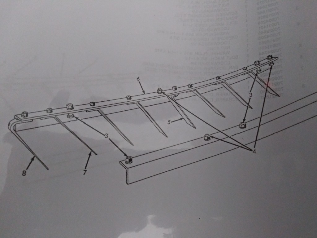

Here's what I have for ridge reducers on my Snap-Couler #109 disc.  I've got them on both sides on the rear gang.  They are bolted on and appear to be OEM.  It was like this when I bought it.
Right side...

Brian those are correct by the parts book. Mine are not except for the parts to the scrapers. Somebody welded these on. I'm cutting them off tommorrow if weather is good.

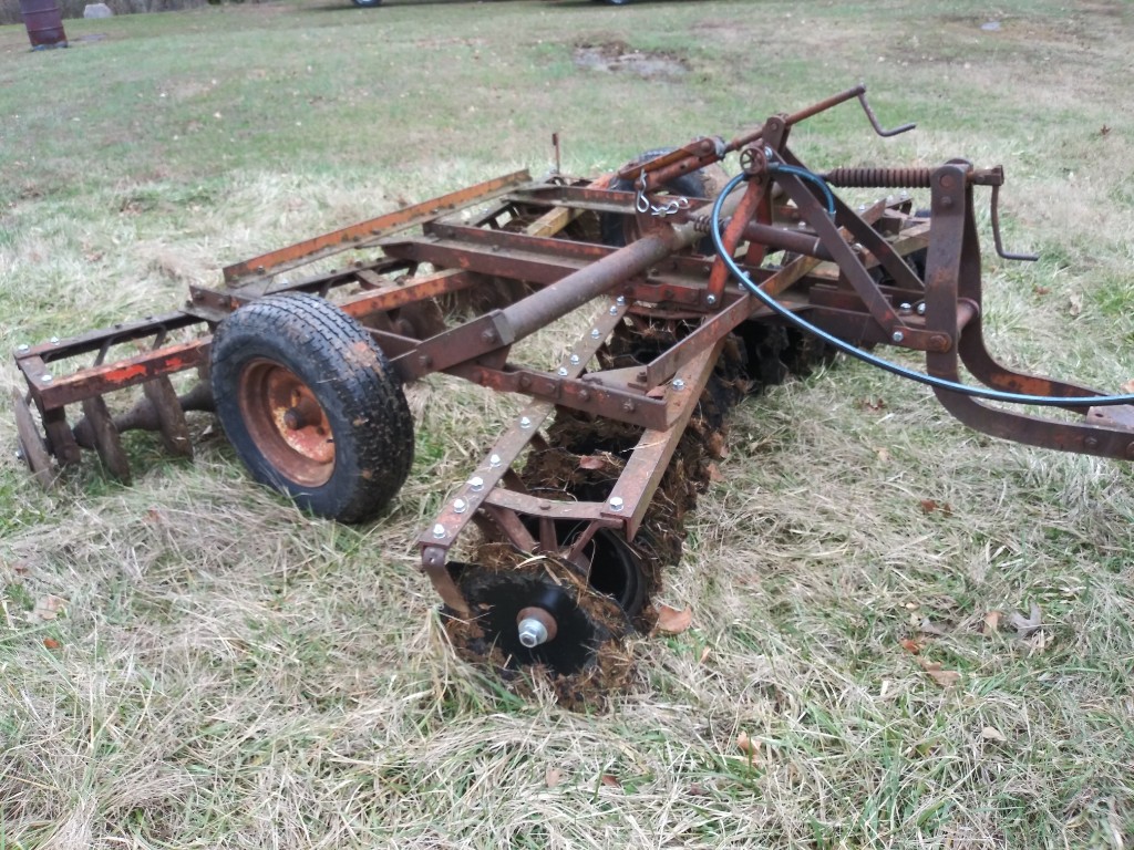

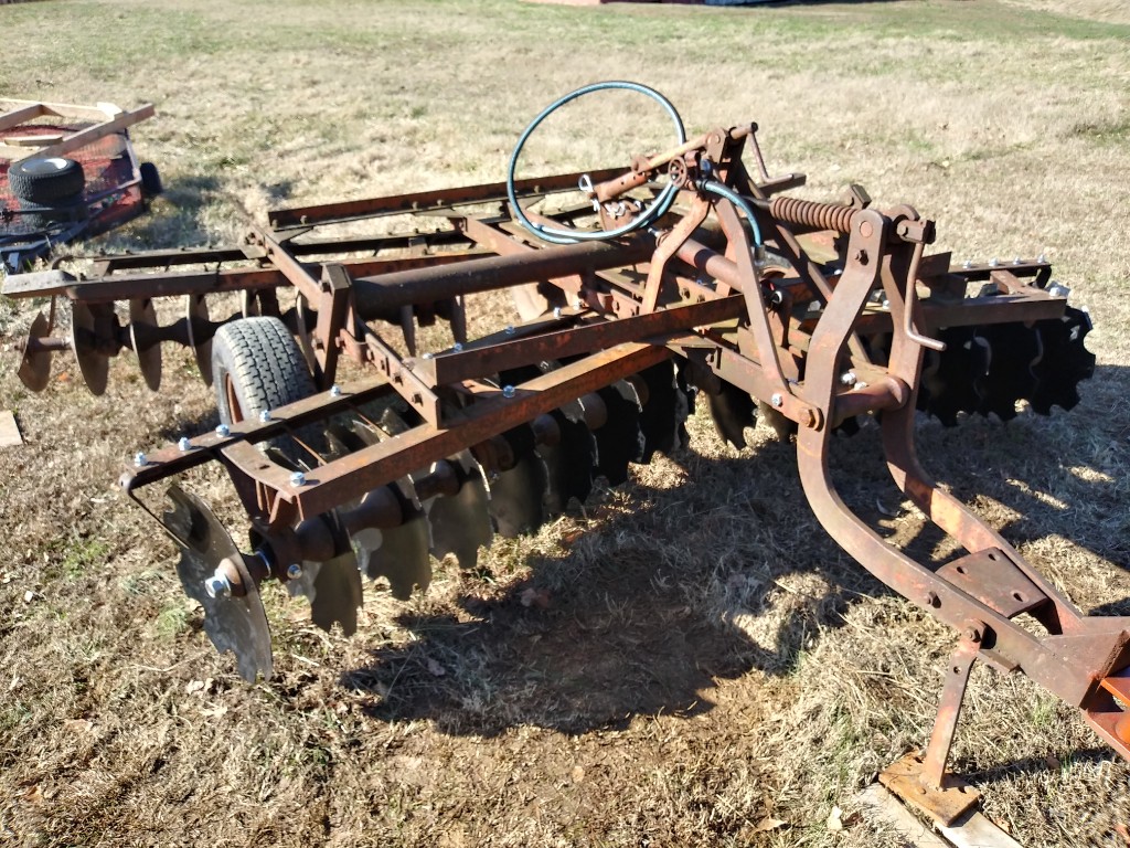

Well I got the makeshift eradicators cut off today. What a pain in the butt. Looks a lot better. Very wet out today but I decided to make a few passes in a grassy area. Looks like the new 18" notched blades on the front will cut just fine. They are 1 3/4 concavity. Little more than original but after walking back and looking through the ground the brush and grass was chopped very well. Now on to rebuilding the back gangs...

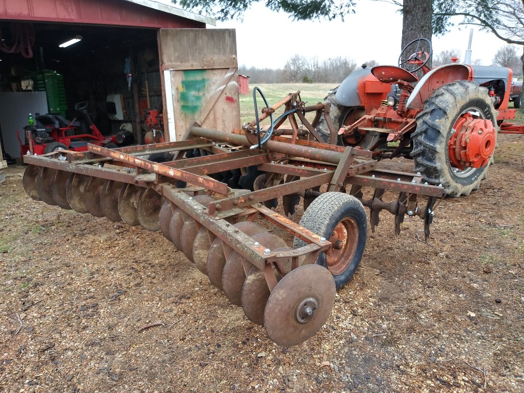

Just curious, but what size tires do you have on that disc?
I've got a SC pull-type disc also, but it's in need of major repairs.  Figured I'd get it on its' feet first so I can move it around.  It belonged to my father-in-law but I saved it from the scrappers. I believe its a #215 disc with wings.  But I'm sure the wheels and tires would be the same as yours.

The tires are 215/75/14 and seem to have worked out just right. To tighten the gangs I used a large pipe wrench on the end backing plate to hold it still. After I snugged it up some everything quit spinning and it tightened up. I tightened the nut with a 1 1/2 wrench. I ordered some more NOS parts today for the hose support. I'll post pics when I get them in.

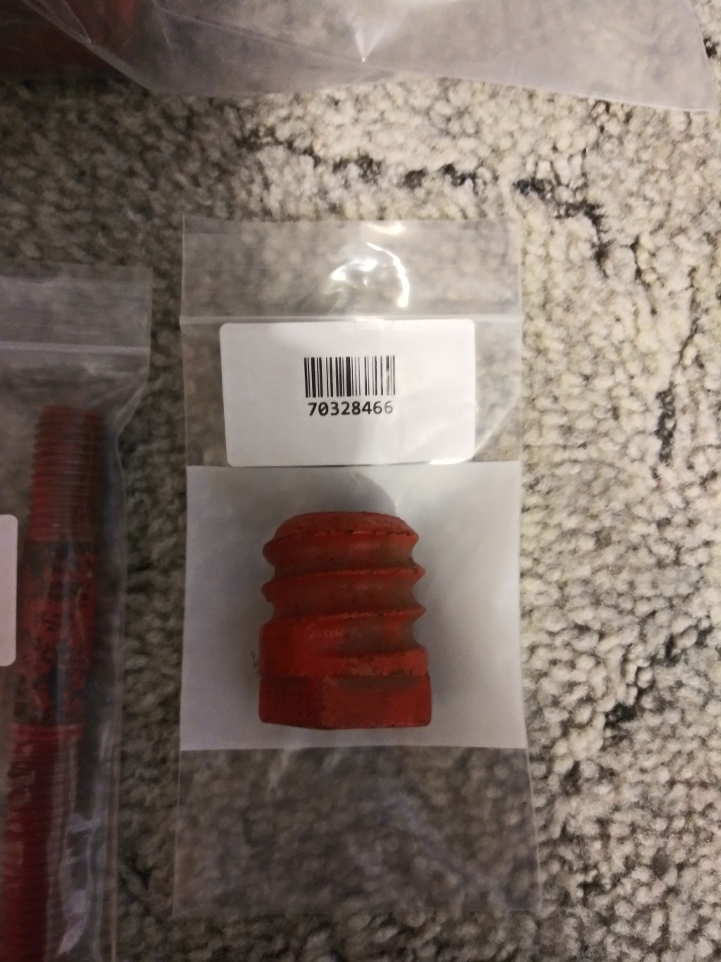

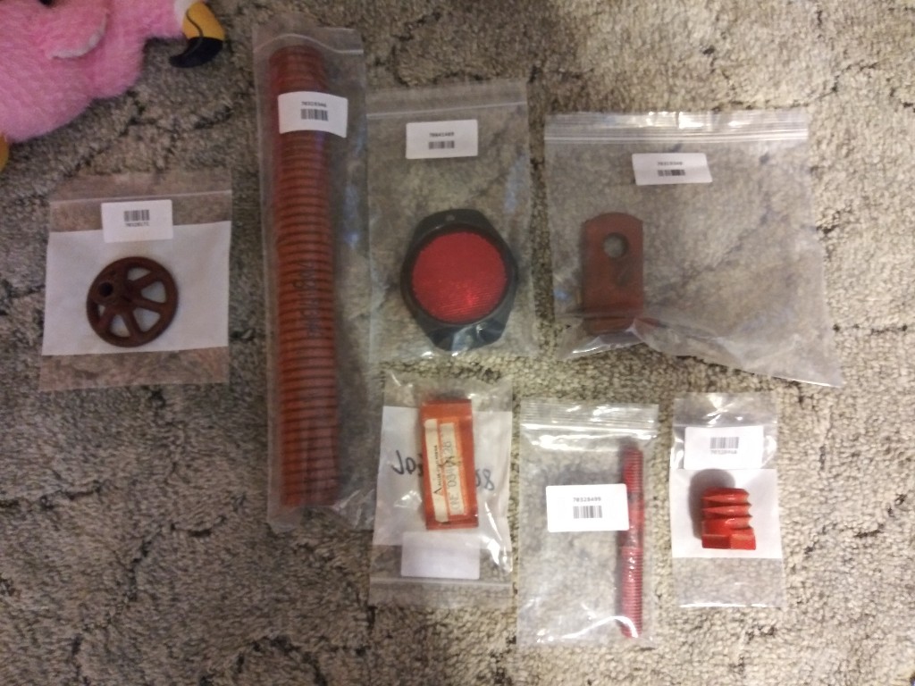

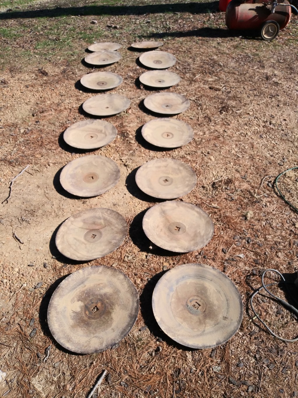

Received more NOS parts today. I need 1 more of #70328466. Don't mind the dog's flamingo in the top left.... Lol.
Brian F(IL) View Drop Down
Location: Paxton, IL
Points: 2728
Post Options Post Options   Thanks (0) Thanks(0)   Quote Brian F(IL) Quote  Post ReplyReply Direct Link To This Post Posted: 31 Jan 2020 at 8:06am
Okay, I'll bite.
What is the purpose of part #70328466?  Does it fit into the end of the spring for some reason?

Yep that's correct. Hopefully I can find one more somewhere.

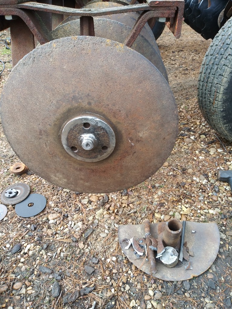

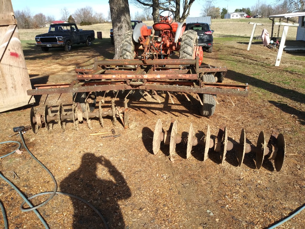

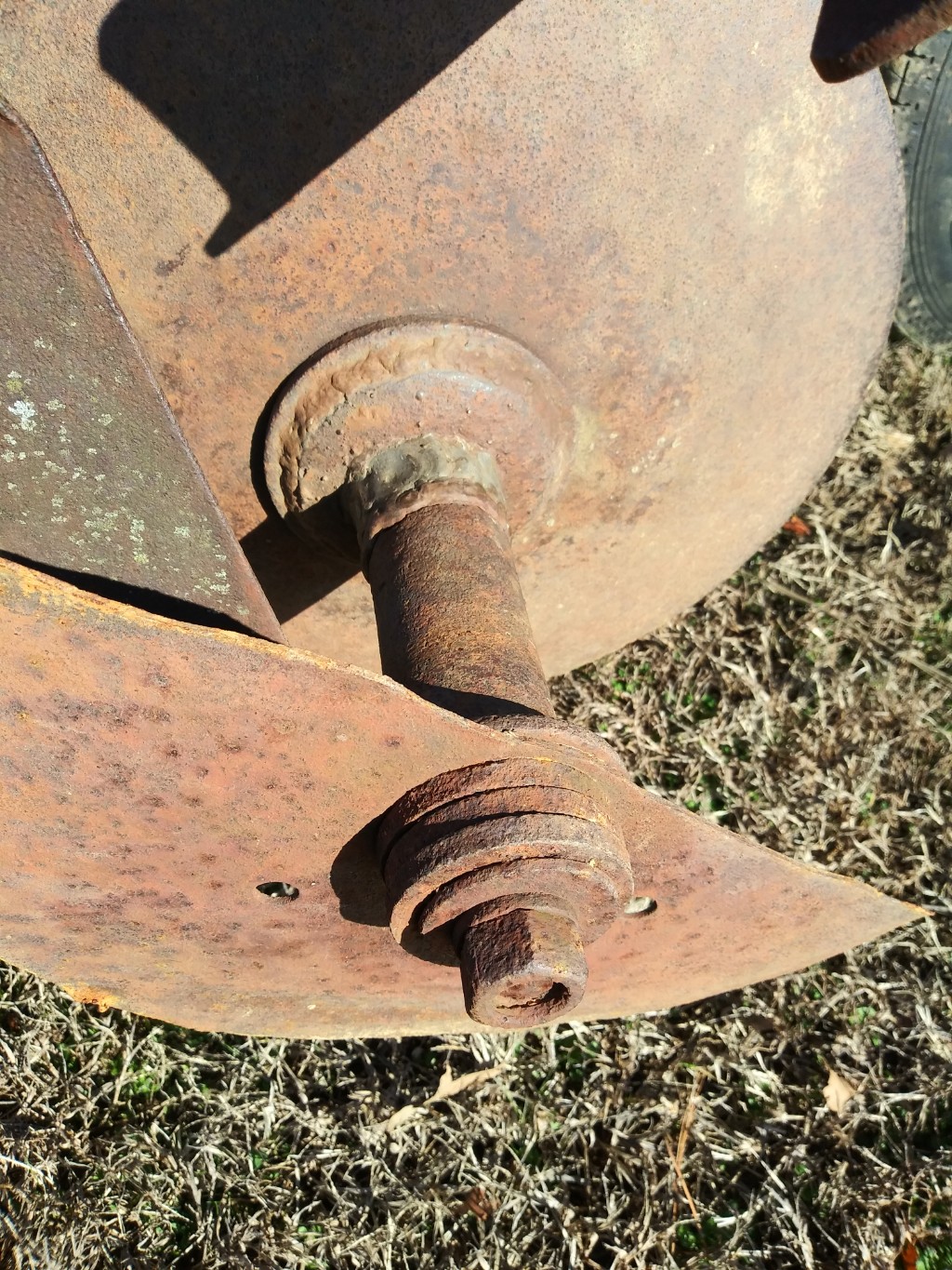

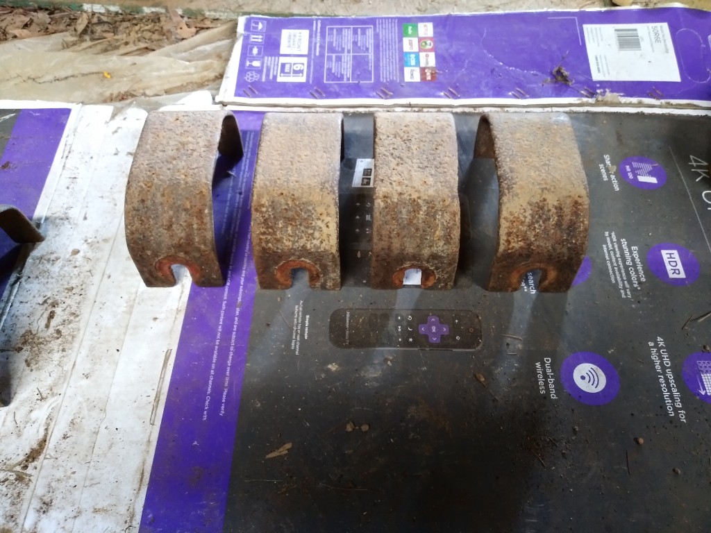

Got the back gangs apart today. All bearings good but one. Anybody need the old blades?

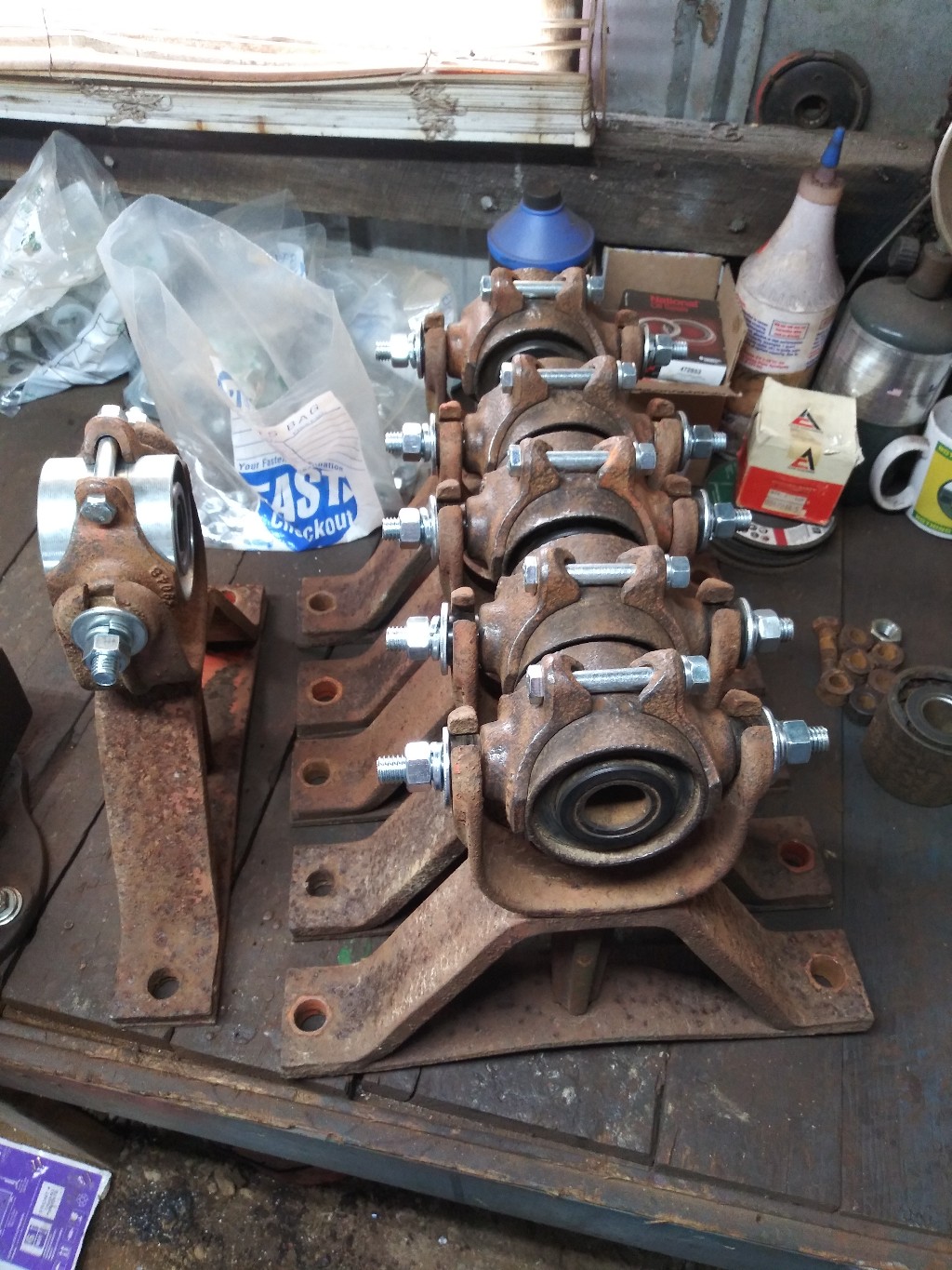

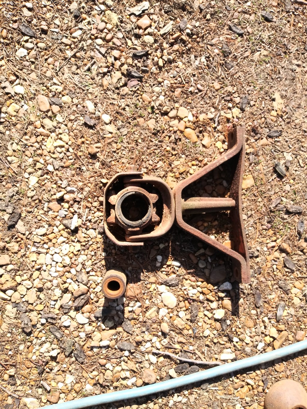

All the bearing assemblies for the rear gangs are back together now. Now just a few parts left to find and it will be a 100% complete disc and I'm never doing this again.... lol. I have all the bearing proctectors but I want them to all be in the condition like these 4 I have. The rest are very worn.
