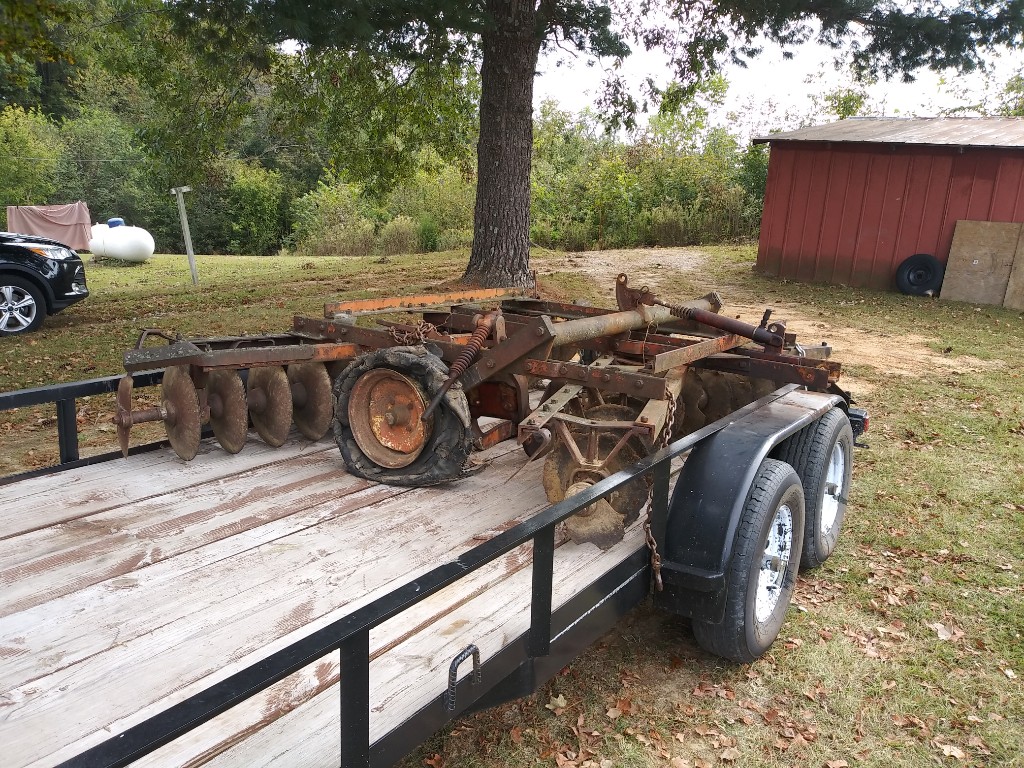

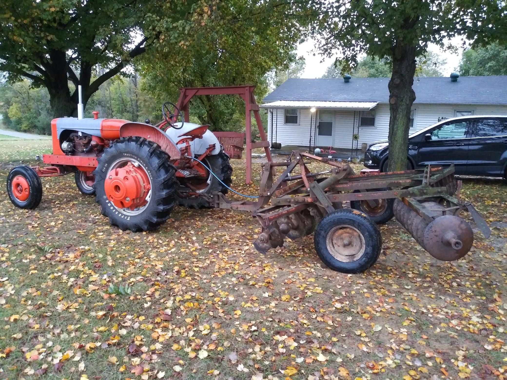

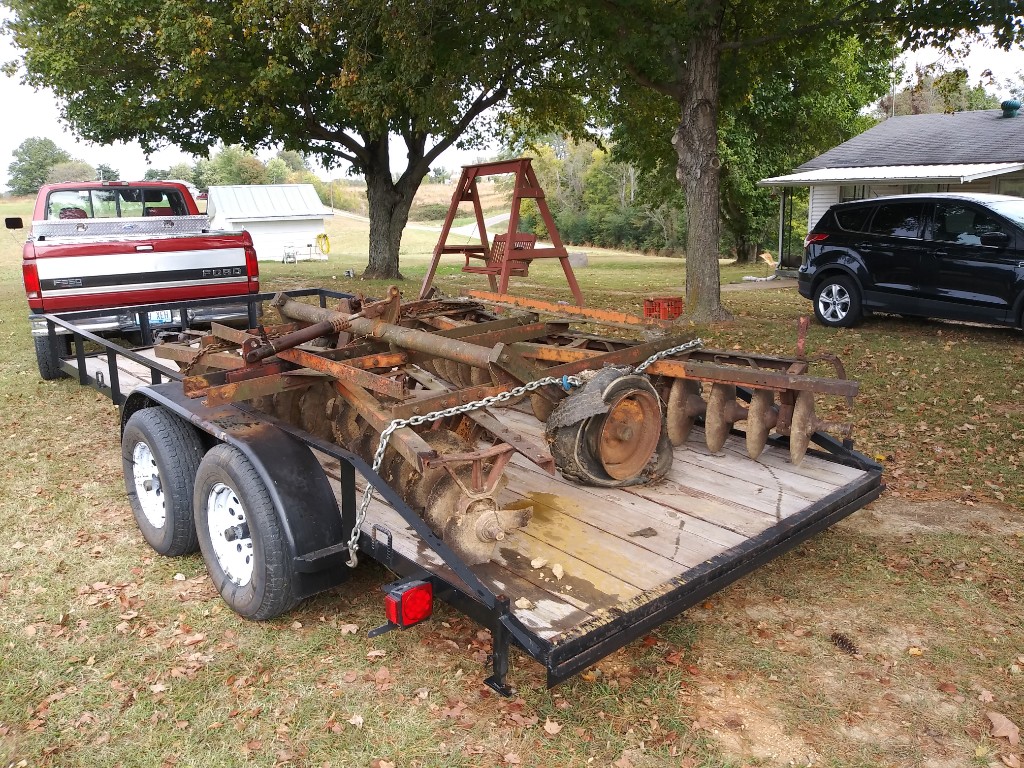

Bought me a new project last weekend. From the manuals I've been looking up it is a model 211 10' Disc. New tires/tubes and hydraulic hose this weekend so I can move it around. 8 blades per gang plus an extra small one on the back. I'll probably replace all blades. All bearings are good but one. I know it will be expensive but I'll just work on it a little at a time. Where will I find correct blades? I've been looking at shoups and I believe I found the correct notch blades I want on the front. Will need various other parts as well. Thanks for any help.

I think we have a nos snap coupler hitch that your missing.
I like the tires on the tractor. Do you have any other toys for it.

I see you have the 13.6-28's How do they dig? Your sure have the old girl weighted up for workin!

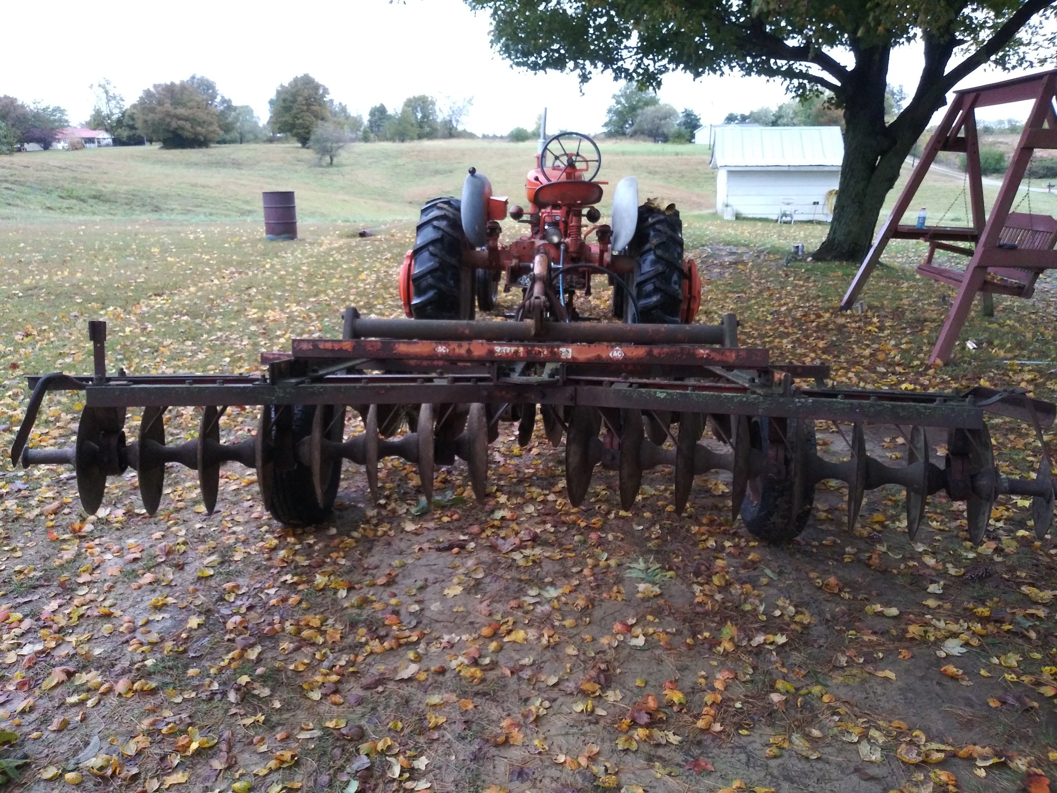

Chris, it use to have 14.9-28 Goodyear shortbar/long bar tires. The 13.6-28 Firestones pull way better. Still need a full set of front weights. Everybody seems to love seeing the weights when I take it somewhere.

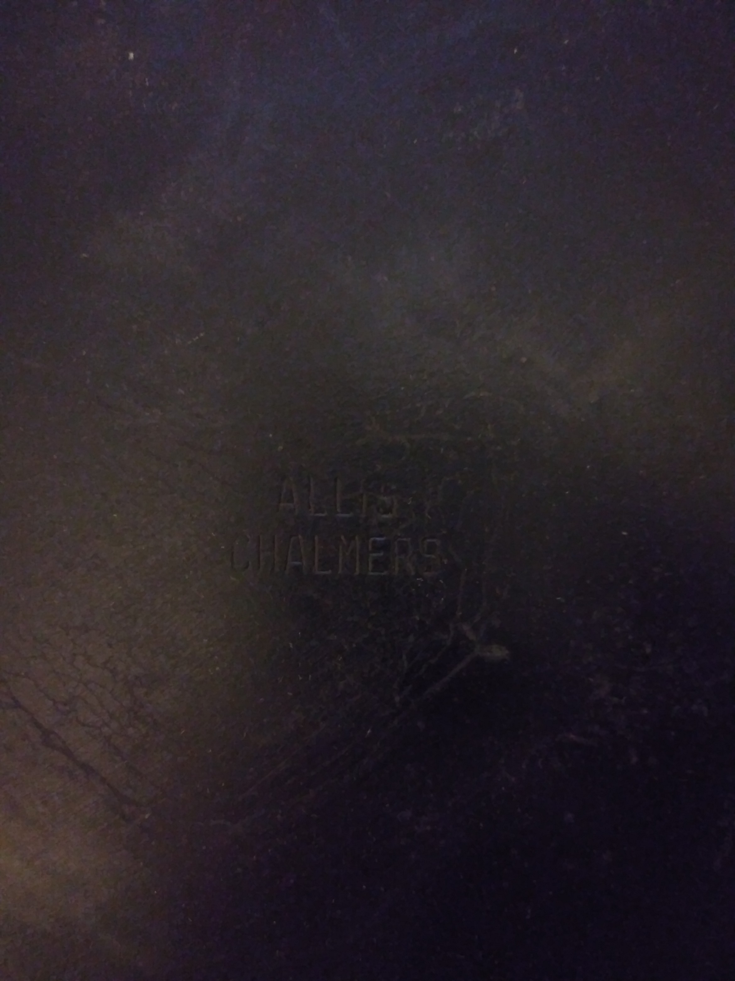

I for sure want to find the correct blades. I don't see the point in fixing it up without them. I want this thing to be nice. I'm sure it will take some time.

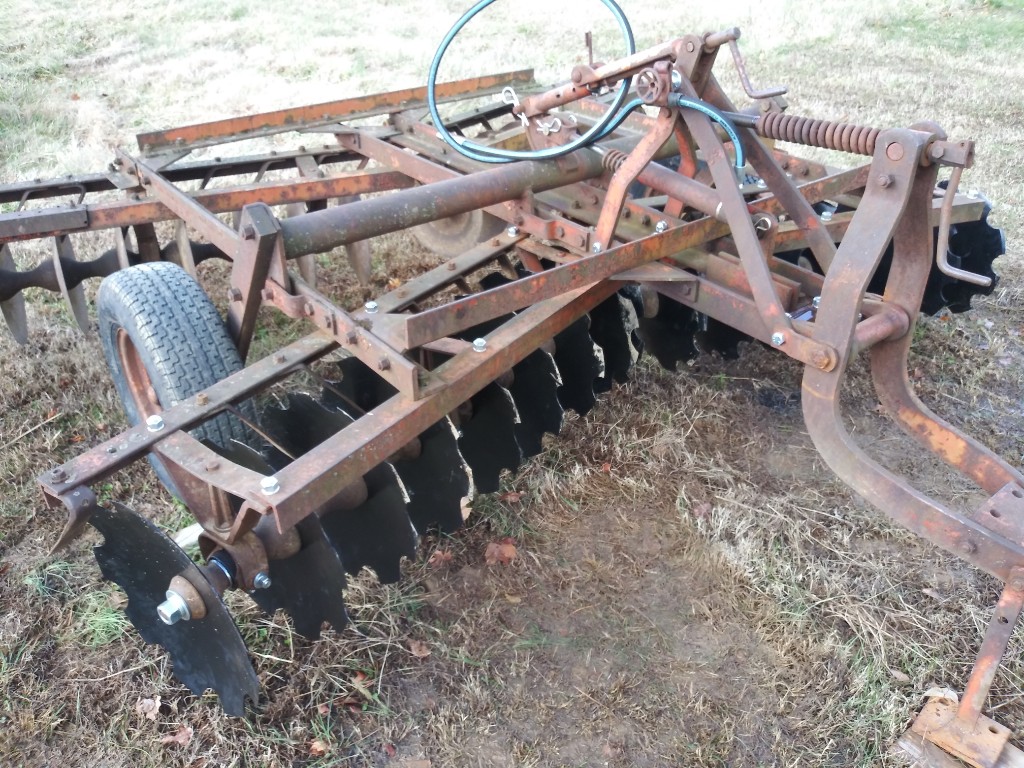

Been tinkering with disc some. Got one gang on front apart. It appears none of the blades were original. Tightened and packed the wheel bearings today.

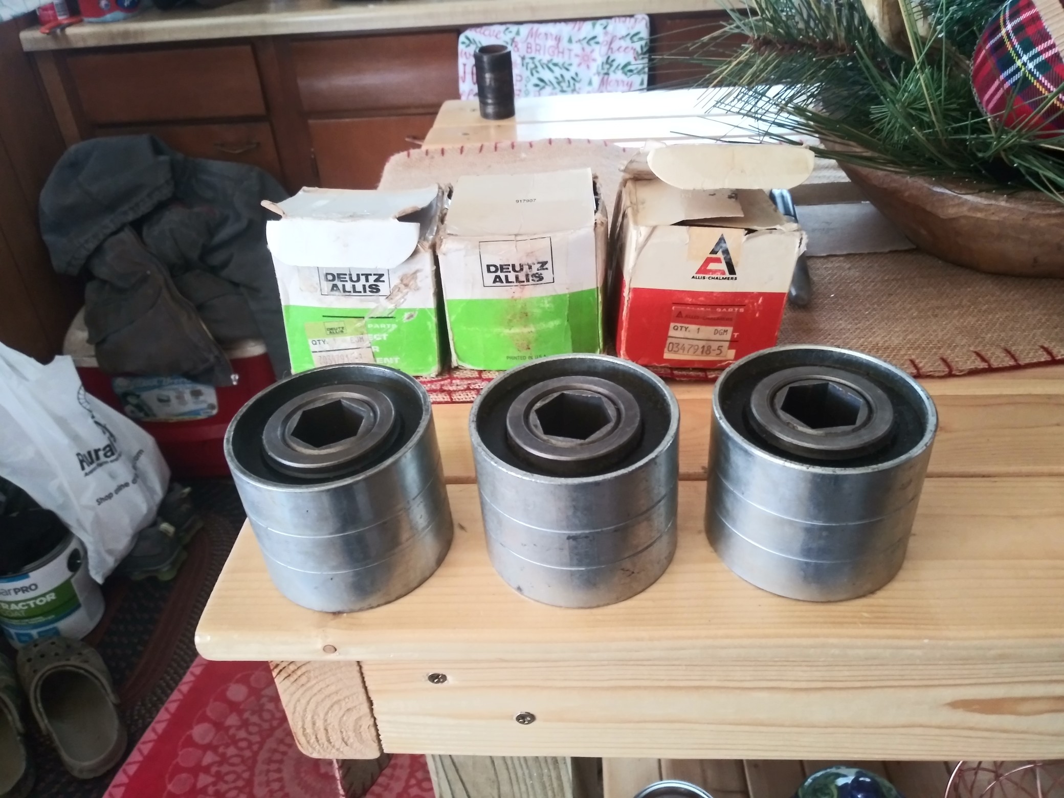

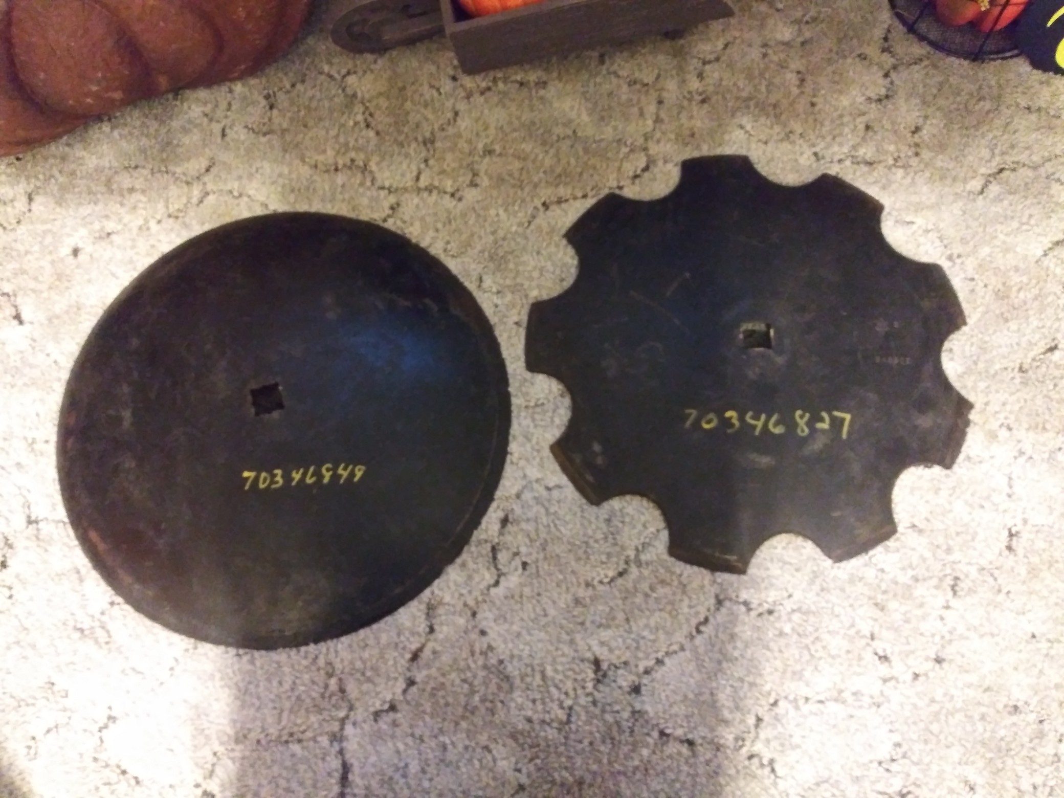

Received both of these NOS blades from Sandy Lake today. Now I'll know for sure exact measurements I'm looking for to get replacement blades(there wasnt enough NOS for a set).

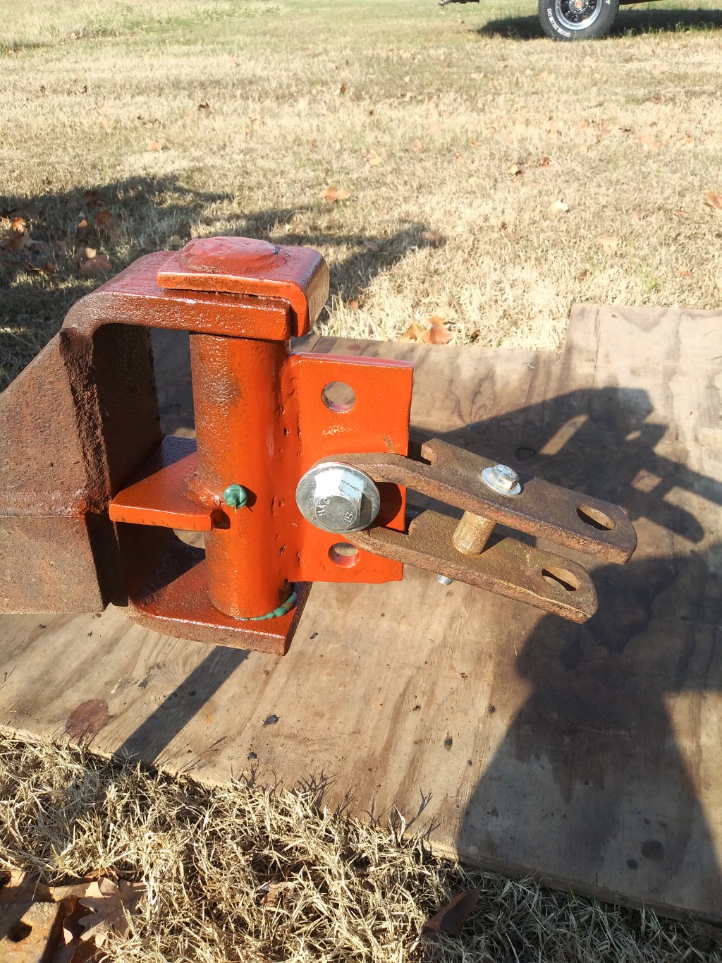

Removed hitch and had a buddy of mine weld up the wore out holes and redrill them. Also came across 3 NOS bearings. I took one old one apart today. Bearing feels good but sounds dry. Hopefully I can get some grease in it and put it back in. Also bought a big bag of bolts and nuts from Rural King over the weekend lol.

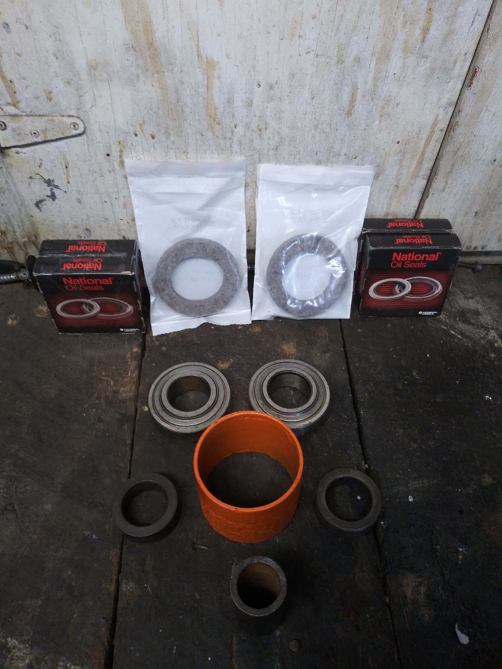

Not much progress today cost myself money mostly. Found 2 NOS bearings by theirselves online. I pushed one into a shell today. The WD wheel felts like in another post would not work for me and I ordered 4($31).I greased them up good and finally got them in. It made everything so tight I couldn't turn the side bushings with it in a vice using vice gripes to try and turn it. Took those back out filled void full of grease and installed the outer seals. I've never had a proper seal driver and never had a problem installing seals until today. I bought 6 seals I ruined 4 of them(and they ain't to cheap).

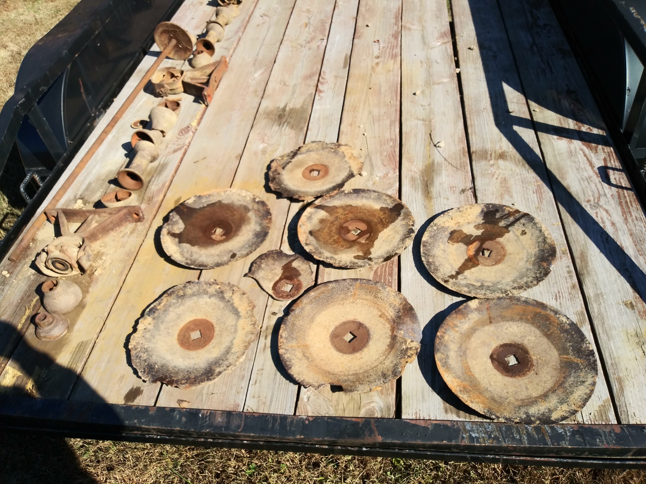

Good idea. I'll look around this weekend for some. I also got the other front gang apart today. 2 locked up bearings....ugh. I'm already in this disc over 1,000.

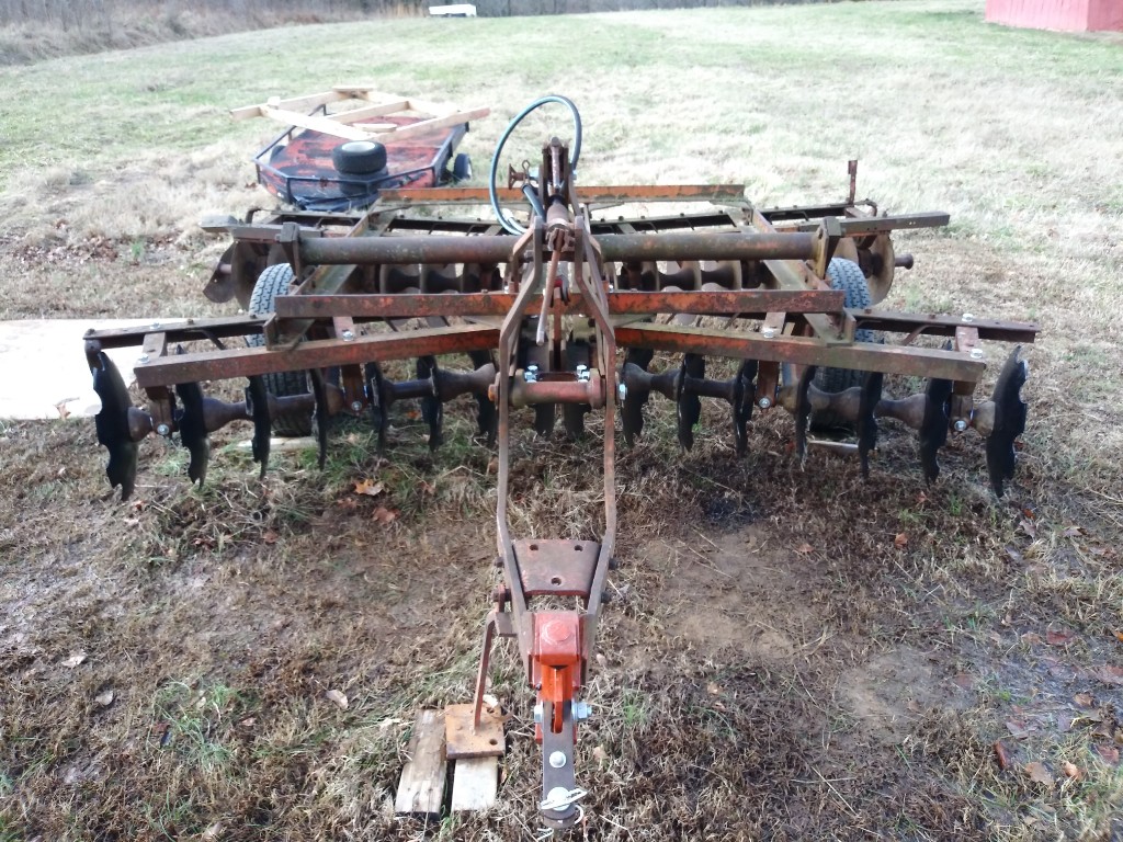

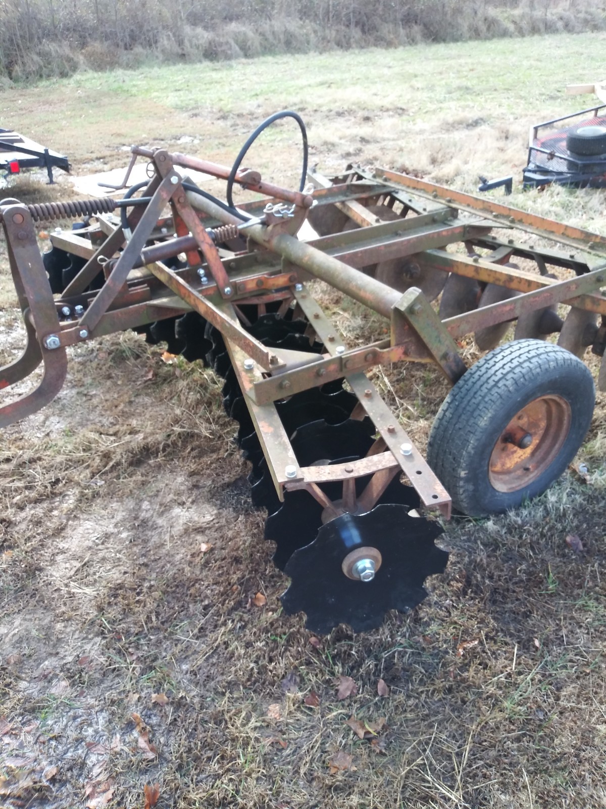

Well I have both front gangs back together finally. New blades, bolts, 4 new bearings.

It was a mess when I first brought it home.
