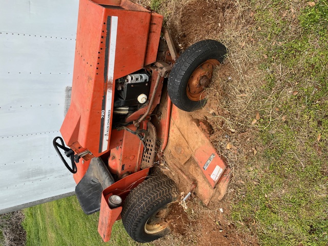

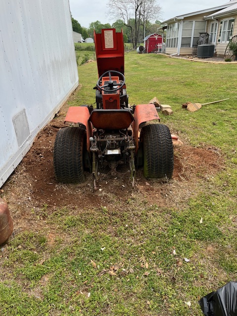

Some pictures of my upcoming project...
Been sitting for awhile...

Air up them tires, hook it to you truck and yank that puppy right outta' there!  A 720 for 200. or less is a steal. Robbie will be right down to pick that puppy up!   Thumbs Up

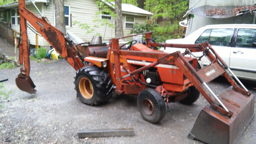

I just brought one home myself a week ago. I'm pretty new to the tractor game. I had a 1967 Case 580CK and it worked great but it was huge to get around here in the woods and honestly scared the crap out of me on any kind of hills. I sold it off and found this with enough left from selling my Case to hopefully get this one right. ALL the hoses for sure will be replaced. Engine was locked up, soaked cylinders with ATF a few days and it came loose pretty easily. Got it running and moving. Both PTO clutches work. Loader will lift but the bucket curl hoses are blown already. Haven't tried the hoe yet. Charging system is only putting out 5.5 volts and seems like the voltage regulator is buried somewhere behind the engine. It's better than I was expecting though. It sat for years. I figured on pretty well everything being a wreck but I was prepared. As I go I'll probably find seals, valves, cylinders etc that need doing but so far it's turning out better than I expected.

Voltage regulator is mounted on the frame behind the engine. 2 nuts through the frame hold it in place. Service manual gives good steps to diagnose charging issues. Unfortunately I had to replace mine as well as the stator.
