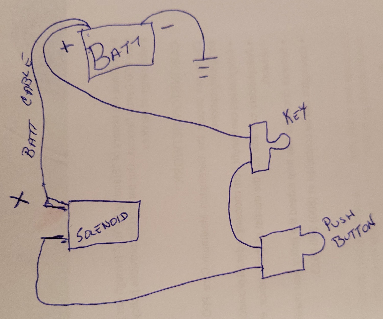

I have an Allis Chalmers 175 diesel, that has developed a problem.
I went out to start it, and got nothing when I pushed the start button.
I assumed the button was my issue, but it's not. New button, same issue.
I can turn the key on, and short across the solenoid, and get the tractor to start.
Does that tell me that I have a wiring problem?
If so, is the attached schematic correct on how the wiring would be?
Thank you so much for your help.

Post Options Post Options   Thanks (0) Thanks(0)   Quote Les Kerf Quote  Post ReplyReply Direct Link To This Post Posted: 28 Jan 2025 at 3:34pm
Ummm... the way you have it drawn in your schematic you are sending Positive (+) voltage to both sides of the solenoid; no current will flow because both sides are at the same potential.

Post Options Post Options   Thanks (0) Thanks(0)   Quote 8070nc Quote  Post ReplyReply Direct Link To This Post Posted: 28 Jan 2025 at 3:56pm
The the negative is supplied through the frame of the solenoid and starter

Post Options Post Options   Thanks (0) Thanks(0)   Quote ekjdm14 Quote  Post ReplyReply Direct Link To This Post Posted: 28 Jan 2025 at 4:04pm
More than that, the starter is missing from the drawing.  Best way would be get a cheap multimeter & find out where you're losing power.

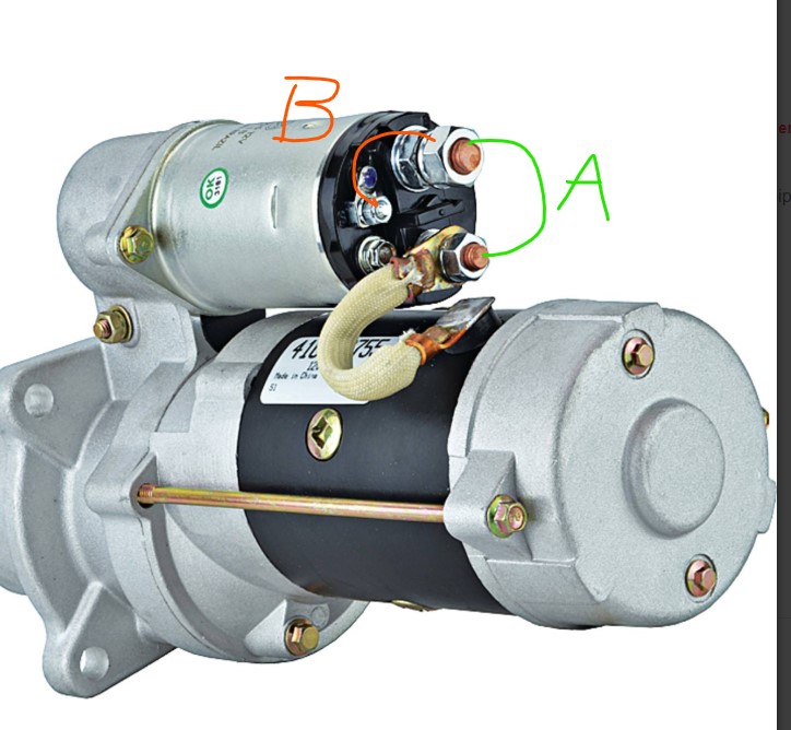

Post Options Post Options   Thanks (0) Thanks(0)   Quote DanielW Quote  Post ReplyReply Direct Link To This Post Posted: 29 Jan 2025 at 12:35pm
Which way did you 'short across' the solenoid? If you went across the two main terminals ('A' in picture below) and it started, that would have bypassed the solenoid and jumped the starter. Which tells you your solenoid is bad/sticky (very common). Or that the solenoid is energizing a field and sucking in, but not making full contact across the two terminals inside. In either case, that would imply a bad solenoid.
If you went from the solenoid terminal connected to the battery to the small solenoid excitation wire ('B' in picture below), that would imply the solenoid's working and you're losing power to the solenoid. In which case, verify with a multimeter and start tracing wires and checking switches.

Post Options Post Options   Thanks (0) Thanks(0)   Quote tongy66086 Quote  Post ReplyReply Direct Link To This Post Posted: 29 Jan 2025 at 1:50pm
Thank you so much.
I jumped it like B, in your picture.
I was suspecting a wiring issue, but at the moment, I don't feel like standing in 6" of snow and a windy 20 degrees.

Post Options Post Options   Thanks (0) Thanks(0)   Quote Les Kerf Quote  Post ReplyReply Direct Link To This Post Posted: 29 Jan 2025 at 3:59pm
Well, you know that, and I know that, but we don't know if the original poster knows that. We are dealing with an unknown person on the internet and we don't know much about his level of expertise other than the obvious fact that he asked for assistance in troubleshooting a basic DC circuit. There is no shame in that, as we all had to start somewhere, but when I see an incomplete schematic I immediately presume that we need to address the fundamentals first.
