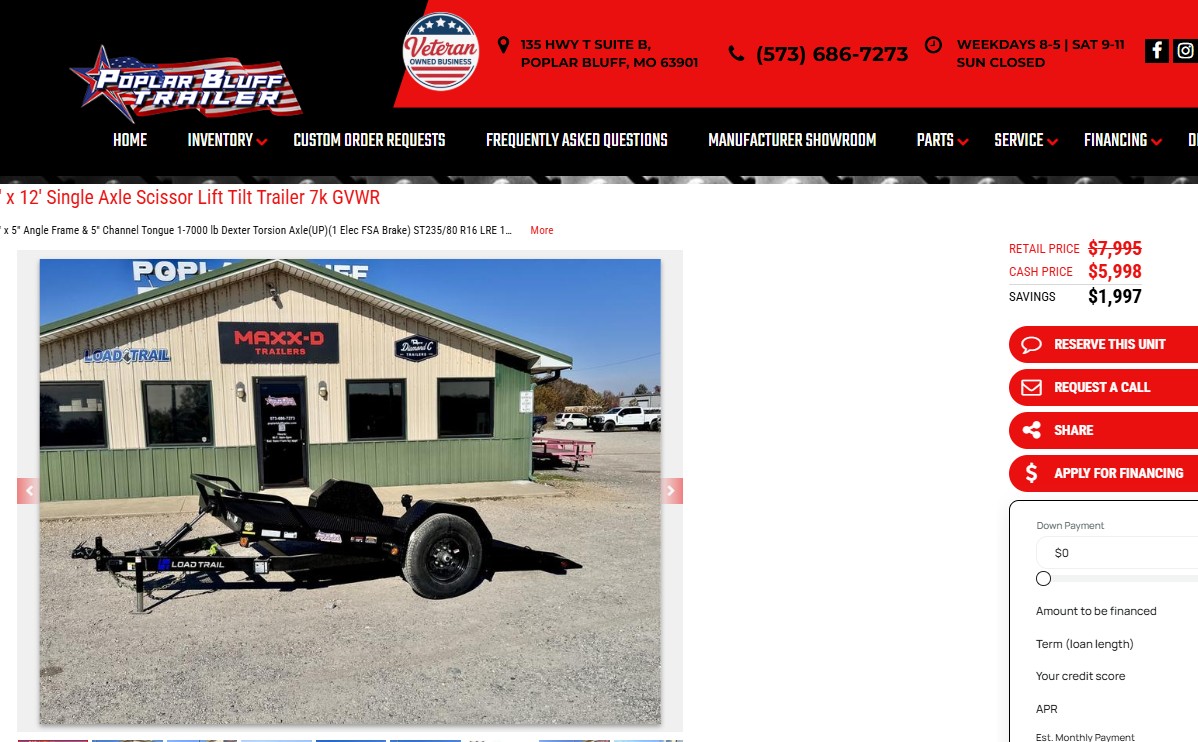

Hi, folks. I’m seeking advice and counsel about buying a tilt-bed trailer to transport a tractor to shows and parades. I have 22’ gooseneck car hauler that is now too big.   I want downsize to something like a 14’ bumper--pull  to haul my D 10 or CA or Farmall B. The idea of not dealing with ramps is attractive, but I have no experience with a tilt-bed and would like to have some advice before going in that direction.  What are the pros and cons? I have seen tilt-beds with either a single axle or tandem axles – I’ve had two tandem axle car haulers and don’t know if a single axle 7k trailer is a good idea. Your advice and comments will be welcomed.
Clarification: I have been known as BobDinNC for a number of years, but not active recently. So I had to re-register today as NewportBob.
