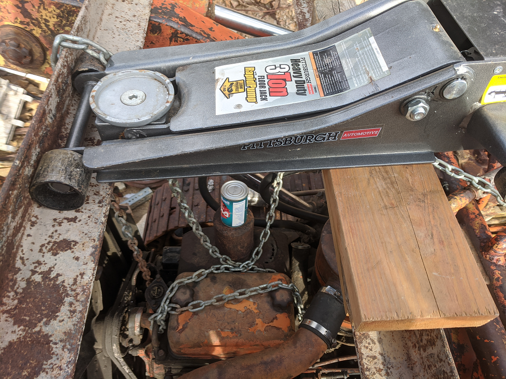

It may be above freezing for the first time in a while tomorrow.  With my limited resources, I've devised this rig to pull the head off.  Do you see any obvious absurdities I'm missing?
WaltDevore View Drop Down
Joined: 03 Jan 2020
Location: IdahoSprings CO
Points: 143
Post Options Post Options   Thanks (0) Thanks(0)   Quote WaltDevore Quote  Post ReplyReply Direct Link To This Post Posted: 25 Jan 2020 at 5:03pm
I'll put the chain on the back of the lift circle closest to the handle.  The pull won't be perfectly vertical.  Just hope to break loose without breaking anything.
Points: 55252
Post Options Post Options   Thanks (0) Thanks(0)   Quote DiyDave Quote  Post ReplyReply Direct Link To This Post Posted: 25 Jan 2020 at 6:05pm
If you have everything on the head that holds it to the block removed, take #2 piston, and re-assemble it, with a piece of something like carpet, or a circle of wood, on top.  Put the old bearing halves in, around the crank, and turn the crank, to pop the head off...Wink
Edited by DiyDave - 25 Jan 2020 at 6:08pm
Points: 55252
Post Options Post Options   Thanks (0) Thanks(0)   Quote DiyDave Quote  Post ReplyReply Direct Link To This Post Posted: 25 Jan 2020 at 6:12pm
[QUOTE=DiyDave]If you have everything on the head that holds it to the block removed, take #2 piston, and re-assemble it, with a piece of something like carpet, or a circle of wood, on top.  Put the old bearing halves in, around the crank, and turn the crank, to pop the head off...Wink [QUOTE]
Whoops, didn't remember that you don't have the pistons out.  Do you have an injector out?  If so, feed a length of rope, down the injector hole, to do the same thing as I said earlier, above!Wink
Joined: 03 Jan 2020
Points: 143
Post Options Post Options   Thanks (0) Thanks(0)   Quote WaltDevore Quote  Post ReplyReply Direct Link To This Post Posted: 25 Jan 2020 at 7:21pm
I do have the injectors out.  That is an amazing idea.  Thanks!!
Coke-in-MN View Drop Down
Location: Afton MN
Points: 42262
Post Options Post Options   Thanks (0) Thanks(0)   Quote Coke-in-MN Quote  Post ReplyReply Direct Link To This Post Posted: 25 Jan 2020 at 10:16pm
Head should come off easily without all this monkey business .
Injector tube is copper and flared at end into head - the hole through is not large enough to pass much through .
 IF all the bolts are removed head should be able to be lifted - looks like you have the lift rings on head secured to your lifting device , next get a soft blow hammer and tap on head .
 Now pistons and liners come out from top , pistons can be removed with liners intact yet in block - liners are shimmed into block to get a proud dimension from top of block face of about .005 .
 With all the crusty crud in the bottom of the blower housing - evidently the drain hole on bottom of housing is closed off - it's a 1/4" threaded hole in bottom of the housing and it MUST be open to allow drainage .
Edited by Coke-in-MN - 25 Jan 2020 at 10:18pm

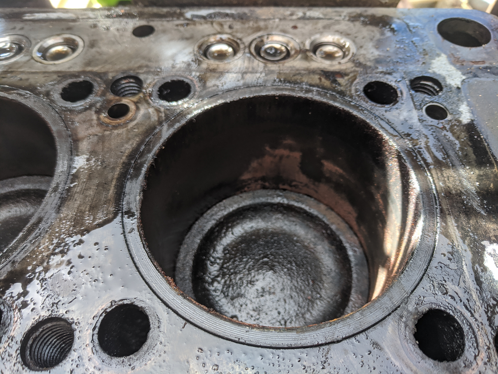

Cylinder1
Joined: 03 Jan 2020
Points: 143
Post Options Post Options   Thanks (0) Thanks(0)   Quote WaltDevore Quote  Post ReplyReply Direct Link To This Post Posted: 26 Jan 2020 at 3:20pm
Is this worth saving?
NomoreJohnDeere View Drop Down
Joined: 24 Jul 2017
Location: Missouri Ozarks
Points: 308
Post Options Post Options   Thanks (0) Thanks(0)   Quote NomoreJohnDeere Quote  Post ReplyReply Direct Link To This Post Posted: 26 Jan 2020 at 3:32pm
tolerances determine that
Hows the crosshatch?
HD3
Points: 35641
Post Options Post Options   Thanks (0) Thanks(0)   Quote DMiller Quote  Post ReplyReply Direct Link To This Post Posted: 26 Jan 2020 at 3:36pm
Cannot see it for the Red Rust!! Rings will be stuck if not scrubbed raw.
Joined: 03 Jan 2020
Points: 143
Post Options Post Options   Thanks (0) Thanks(0)   Quote WaltDevore Quote  Post ReplyReply Direct Link To This Post Posted: 26 Jan 2020 at 3:38pm
Is cross hatch the hone on the cylinder wall?  I guess I should get each piston to its bottom and see what it looks like.  I should clean it up with some oil and check it then?  The exhaust stems  as seen through the ports are rusted.  I'll try to do this now.  Need to charge up my battery.
Joined: 03 Jan 2020
Points: 143
Post Options Post Options   Thanks (0) Thanks(0)   Quote WaltDevore Quote  Post ReplyReply Direct Link To This Post Posted: 26 Jan 2020 at 4:39pm
The liners feel pitted in areas.  At this moment it seems a valve job, liners, and rings.  Any guess as to the bucks that involves?  Thanks
Points: 35641
Post Options Post Options   Thanks (1) Thanks(1)   Quote DMiller Quote  Post ReplyReply Direct Link To This Post Posted: 26 Jan 2020 at 6:17pm
Google Detroit 71 Series Cylinder Kits. Gonna be in the $200 Each hole range.
