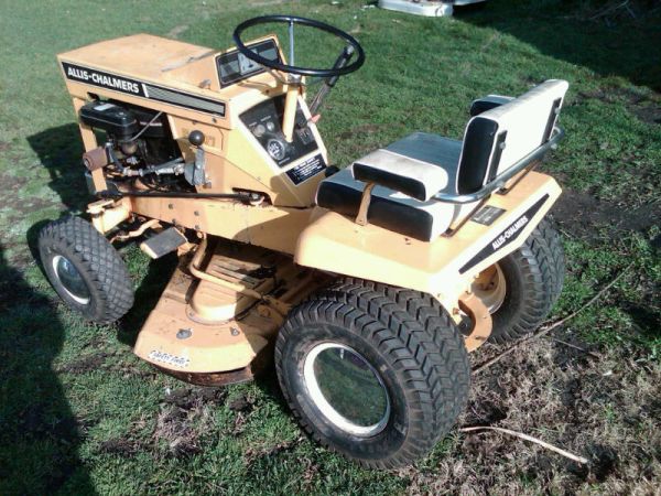

Hi all. I just put a seal kit in the carb on my 917, which still has the original kt17 in it. It was leaking gas and that problem is now solved, but now it sits overnight and the right cylinder fills with gas to the point that it won't turn over. Its just that cylinder because the intake manifold runs downhill on that side. The kit came with a new float valve and seat and I replaced them and made sure the float wasn't sticking so I'm out of ideas. I just want to get it fixed so I don't have to constantly change oil in it from the gas leaking down. Hope someone has run into this before.
