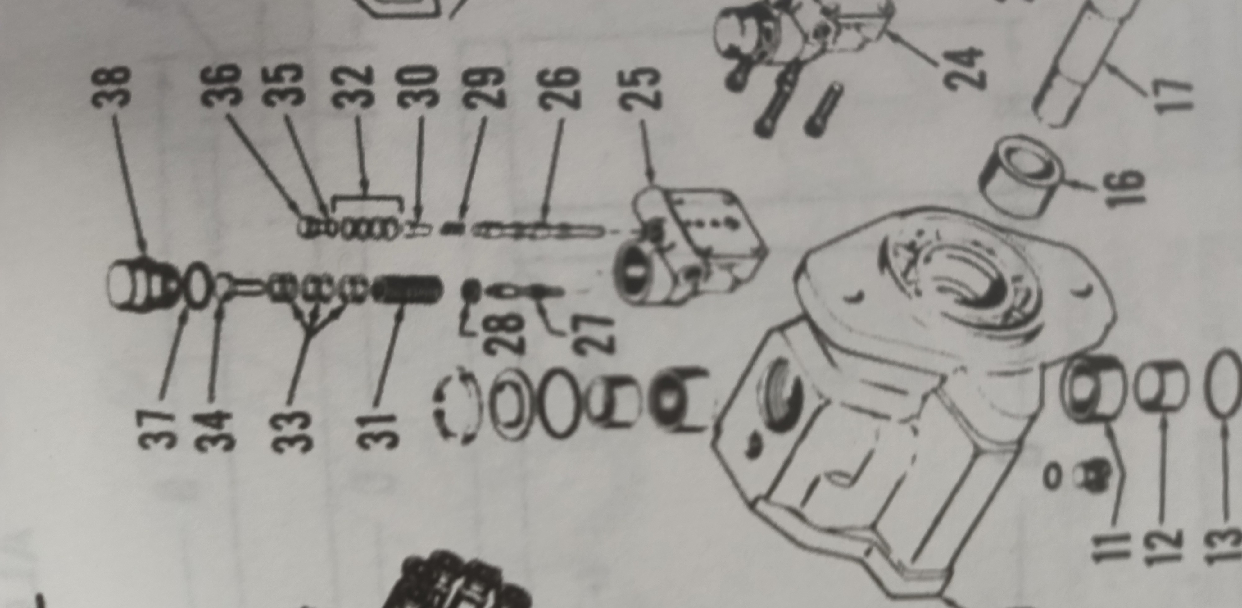

Ok, I changed the oil filters and continued trouble shooting from there And determined there was no charge pressure. When I pulled the compensator spring (number 29) it was broken in half. Does anyone know where I can get a new spring? It's for the piston pump on a 7060. Thanks

An AGCO/Allis dealership is the only place and you will possibly need shims to adjust the pressure.

Post Options Post Options   Thanks (0) Thanks(0)   Quote 8070nc Quote  Post ReplyReply Direct Link To This Post Posted: 7 hours 45 minutes ago at 8:53pm
You will probably have to get a complete compensator
Finding that spring for a cesnna pump is iffy im afraid. That design was bought out by eaton. You might get lucky at a really good hydraulic shop. Some of the salvage yards should have a compensator. I hope you can because i priced a compensator a few years ago from agco and it was 800 dollars
