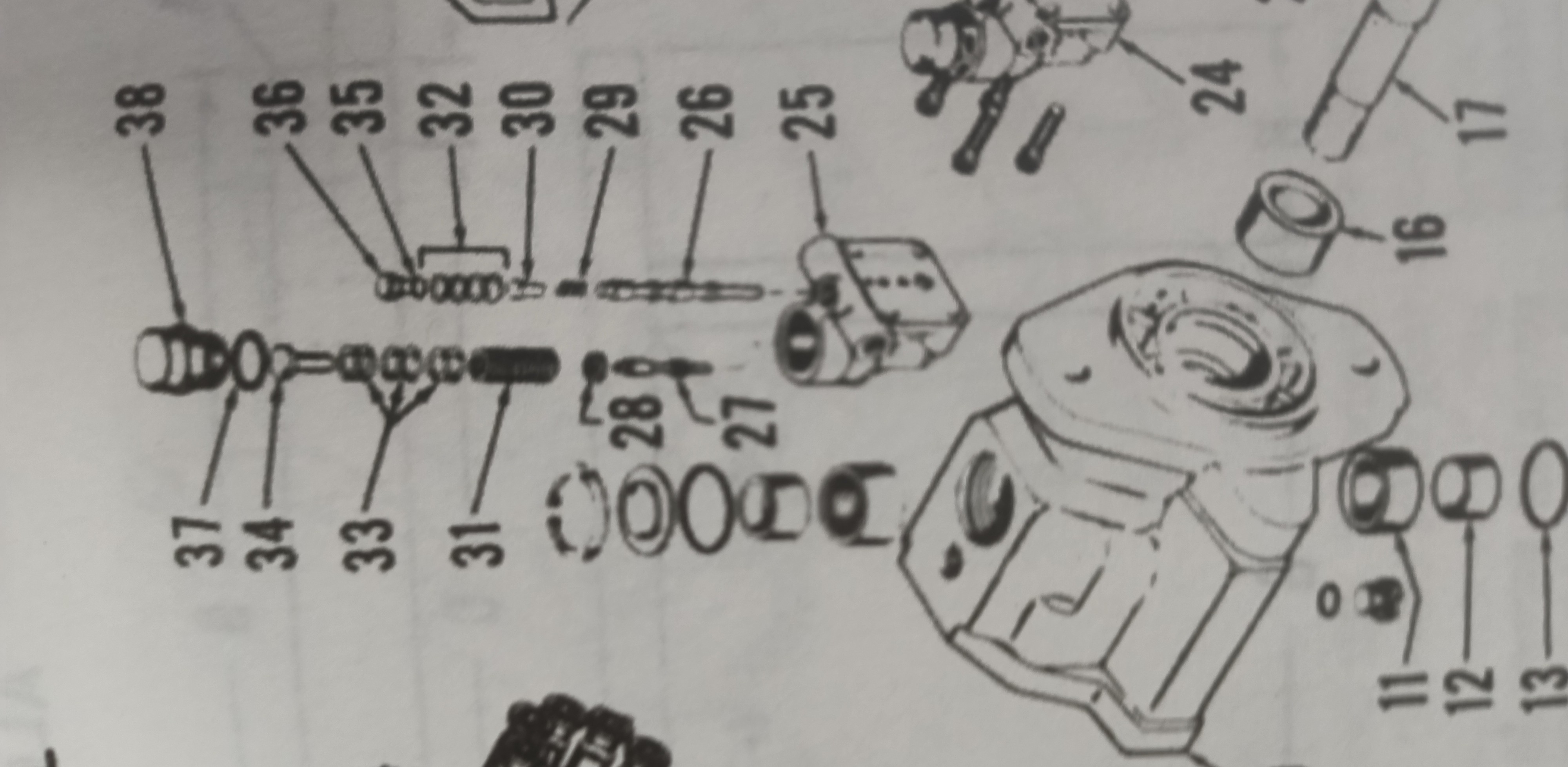

Ok, I changed the oil filters and continued trouble shooting from there And determined there was no charge pressure. When I pulled the compensator spring (number 29) it was broken in half. Does anyone know where I can get a new spring? It's for the piston pump on a 7060. Thanks
Points: 22305
Post Options Post Options   Thanks (0) Thanks(0)   Quote DrAllis Quote  Post ReplyReply Direct Link To This Post Posted: 20 Jun 2025 at 8:52pm
An AGCO/Allis dealership is the only place and you will possibly need shims to adjust the pressure.

You will probably have to get a complete compensator
Finding that spring for a cesnna pump is iffy im afraid. That design was bought out by eaton. You might get lucky at a really good hydraulic shop. Some of the salvage yards should have a compensator. I hope you can because i priced a compensator a few years ago from agco and it was 800 dollars

70267160 is the PN  several dealers stock and any Agco dealer can order get a few of those high dollar shims as well..

I was able get just a spring from midway Power parts for 41 USD. I am looking through the service manual right now to see if I can figure out how to test the charge pressure.i did t get any shims so hopefully the old ones will be sufficient

Ok to wrap up this thread, I got the new spring put in and it fixed the ol girl right up. Huge shout out to @allisdoctor for helping me get the charge pressure set. With the thick shim and 3 thin I ended up at 549 psi. I appreciate all the input on the thread. Thanks everyone.
