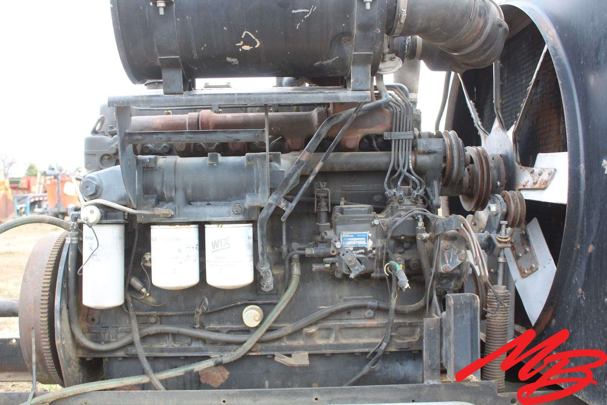

It hasn't been mentioned on this post but is there a governor issue with putting the N5 670I into the 7060?
I have a 670I with the Ambach 100 pump that i was thinking about putting in my 7060 and have read else where the governor from N5 not compatible. is this correct?
MT7050 View Drop Down
Joined: 10 Nov 2024
Location: Montana
Points: 17
Post Options Post Options   Thanks (0) Thanks(0)   Quote MT7050 Quote  Post ReplyReply Direct Link To This Post Posted: 1 hour 9 minutes ago at 1:40am
pic of 670I motor and pump
