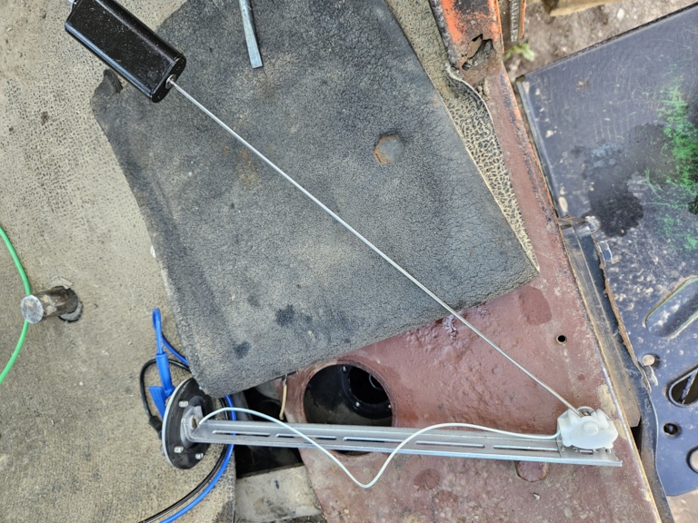

My new fuel gauge isn't registering properly.  I have a new fuel gauge and what looks to be a fairly new Fuel Sending Unit.  I have done a test where I hooked the + and - and sending wire to the guage and directly wired with test leads to the sending Unit.  I can move the sending Unit Float up and down it will move the needle from below empty to almost Full.  So everything works.  I bought the gauge from Agco but it appears to be a chinese knockoff that everyone sells.  I don't know the history of the sending unit but it looks pretty new although I have owned the tractor about 5 years so predates me owning.  It is not original though.
The problem is that when the sending unit is in the tank, it won't register empty at all.  The needle won't move when the key is turned on and "full" registers only about 5/8 tank.  I don't mind full not being full, but I would really like empty to be on the mark.  When I see empty now, it seems it really has 1/4 of a tank.
I see there are two adjustments.  One the entire sensor arm can slide up and down the steel channel.  The other adjustment is that the float can be moved up or down the steel rod.  My thought is that I should lower the float to the bottom of the steel rod and that the entire sensor should be also at the bottom.  This should cause the float to work when empty but it does not.
Is there another adjustment that I need to make?  The float is plastic so I think it works but maybe not?  I could put it in a bucket of water and see what happens.  I suppose a different float could help?  There are two metal clips that can be taken off to add a different float?  Anybody calibrated one of these?  I don't think this is a electrical resistance issue but rather a float issue but maybe I am wrong?  Any guidance is appreciated!
Here is the sending unit:

Make sure you have a good ground wire from sending unit mounting screw to the tank  And the sending unit float must face front

This is a long sordid tale but the details matter to me.  I have gotten a solution to work on the empty end.  The lack of accuracy on empty and full is a combination of factors.  First, the rail that holds the sensor is too short to read empty correctly.  I cut the rail about 1/3 from the end and spliced an aluminum flat stock piece to lower the sensor.  The limiting factor on lowering it is the wire length.  They give you some play so I lowered until I ran out of wire.  After doing this, when turning on the key, the gauge read below empty but at least the needle moved when the key was on.  Prior to lowering, the needle didn't move with key on.
The next thing I did was put a slight bend into the steel rod attached to the float.  After doing research, you don't want to bend the rod any more than necessary.  If you do, then your full reading will not be correct.  However, if I lowered the sensor anymore, I would have had to splice the wire.  This bend now got my needle to hit the empty mark on the gauge when key turned on.  I don't know exactly how much fuel I had in the tank because the old gauge didn't work.  I dipped a rod into the tank from the fuel sending hole and I had about 2 inches of fuel.  So, I am guessing I had about 5 gallons of fuel but I could have 6 or 7 gallons.  I just don't know without draining the tank.  This wouldn't really be empty but better than having a 1/4 of tank under the previous empty reading.
I believe the tanks hold about 68 gallons.  I then proceeded to put about 30 gallons of fuel into the tank.  This put my gauge at 5/8 of a tank.  If I had about 5-7 gallons to begin with and I added 30 then over half would be correct although 5/8 is probably a little on the high side.  Close enough though for my desire to get a better empty and half reading.  Those are critical for knowing when I need more fuel.
If you read my beginning post, I did a test with the sending unit out of the tank and hooked up to the gauge with test wires thereby eliminating all of the tractor wires and ground wire issues.  On my test, empty took the movement of the float quite a while before it registered anything on the gauge.  Also, full never caused the gauge needle to achieve making it to the absolute full mark.  So, once I put another 25 gallons in the tank,  the needle did the same thing.  Never hit the absolute full mark on the gauge.  So, I believe the resistance of the sensor does not match the requirements of the gauge.   Otherwise, absolute full should hit the full needle mark when done outside of the tank.  According to the Fuel Gauge Ohm readings specs included in the box, 10 Ohms is Empty and 88 Ohms is Full.  The gauge is not getting 88 Ohms when the float shows full is my guess.  I might need to add a resistor in the 2-10 Ohm range to get that needle to get to Full.  This same resistor might cause my empty to be a better reading.  If empty only needs 10 Ohms, it couldn't be more than 2-5 Ohms.  I can test this theory by measuring the resistance with a multimeter as the float moves through the range.  I ran out of time to do this.  Now that the fuel is completely full, I will have to take the sending unit out of the tank and do the resistance measurement.  I may have to "bend"  back the float arm to original position, if I get the ohms targeted correctly.  Also, "Full" may never be correct since I lowered the sensor.  This means it will achieve full, long before it is full.

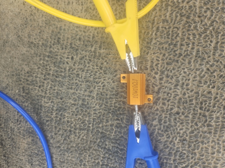

I put a 10 ohm resistor in place and it caused the needle to hit Full as I suspected.  I won't know what that 10 ohm resistor does to the Empty needle though for awhile.  Going to put it into a place where I can easily change it out, if it negatively impacts Empty.
So, the correct fix is to definitely use a resistor to tune the needle.
Here is what I used and got it on Amazon for about $6.00.

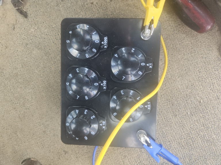

Maybe buy a variable resistor so you can ""dial it in"", then measure what works and buy a resistor???

I did as you suggested to figure out the 10 ohm setting.  I bought a variable resistor on amazon for about $18 that I used to test out various settings.  I wished I had it when the tank was empty.  I will get another chance to try it out on another tractor.  I have about 3 tractors to fix up the fuel gauge on.  Thanks for your reply.
