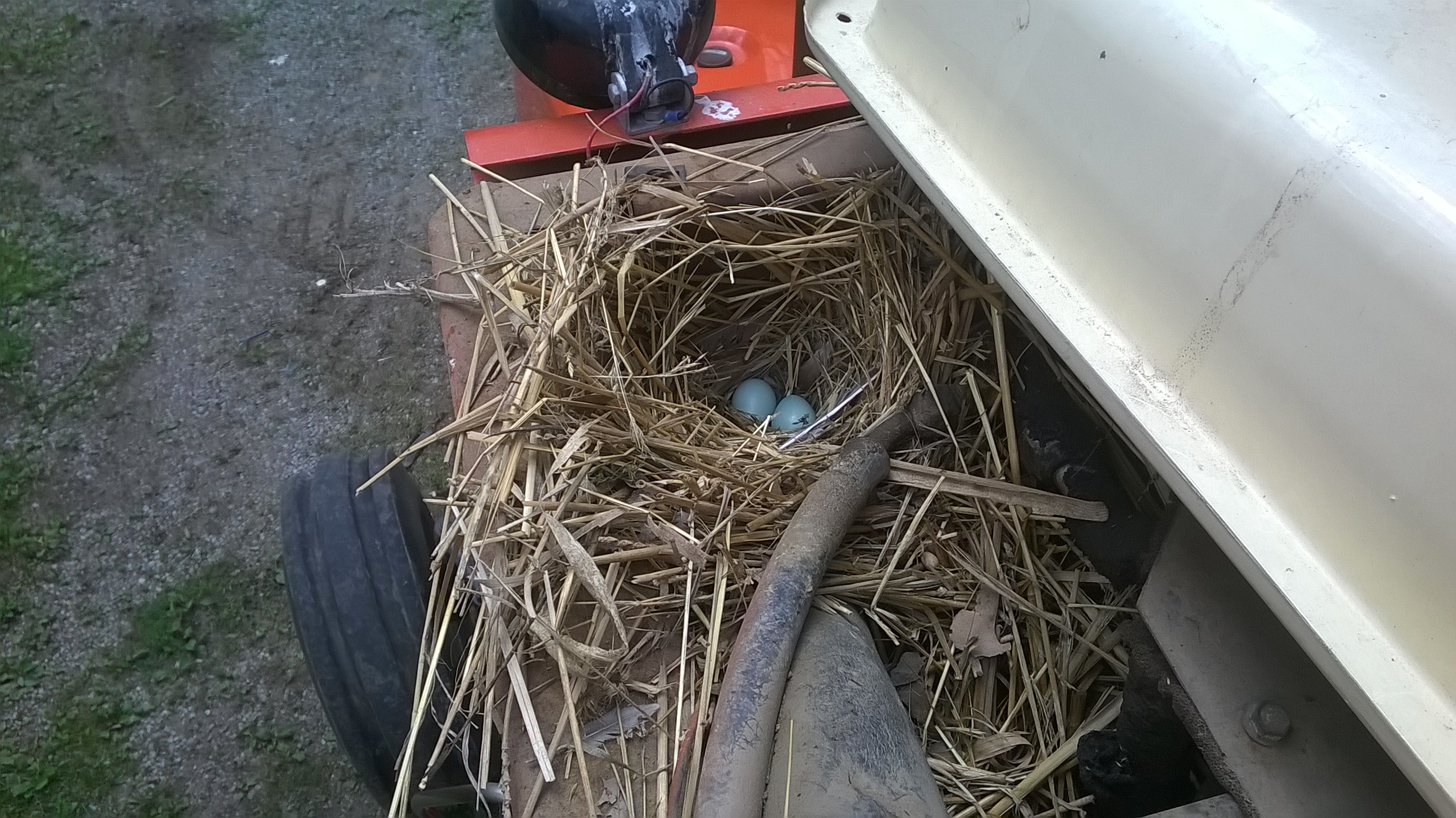

Seems I either have a hose leak or a bad heater core in my 7010. Any surprises to look out for before I pop the top?

Might get ready to find a massive mouse nest. I just did about same except my AC drip lines had come loose. If so, a trash bag, vacuum, & air compressor nozzle come in handy, after you pop the top.

there will also be a lot of dust/dirt up there. while you have the top off, run a wire down thru the drain hoses for the ac condenser, they will usually be plugged with dirt. will hafta take the one way valves off the bottom of the hoses. (then leave them off).

Did it. Mama's gone and been gone. So clean out time. I already got a wren in my gas grill
making it a maturity ward.

Dead simple. Two man job to get it on the ground. Unfortunately it was the heater core leaking . But I did determine that the fan works and the ac switch is new. Check out the compressor clutch and if I get lucky there I may have A/C soonish.
