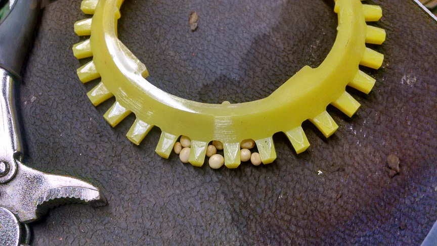

Post Options Post Options   Thanks (0) Thanks(0)   Quote mgraham112 Quote  Post ReplyReply Direct Link To This Post Posted: 14 Apr 2016 at 6:27am
I thought I put a description with the picture but I don't see it. That is the smallest soybean plate from Lincoln ag and as you can see almost 3 beans fill the cell. These are eagle soybeans from 2 years ago, hopefully they haven't gotten smaller. I filled my false ring with devcon metal patch and fill and it was easy to do and sand smooth. Hopefully this will help with doubles.
