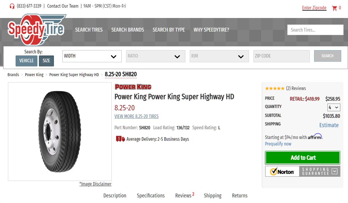

Post Options Post Options   Thanks (0) Thanks(0)   Quote steve(ill) Quote  Post ReplyReply Direct Link To This Post Posted: 04 Feb 2022 at 1:32pm
Edited by steve(ill) - 04 Feb 2022 at 1:37pm
Points: 90868
Post Options Post Options   Thanks (0) Thanks(0)   Quote steve(ill) Quote  Post ReplyReply Direct Link To This Post Posted: 04 Feb 2022 at 1:33pm
Points: 90868
Post Options Post Options   Thanks (0) Thanks(0)   Quote steve(ill) Quote  Post ReplyReply Direct Link To This Post Posted: 04 Feb 2022 at 1:50pm
