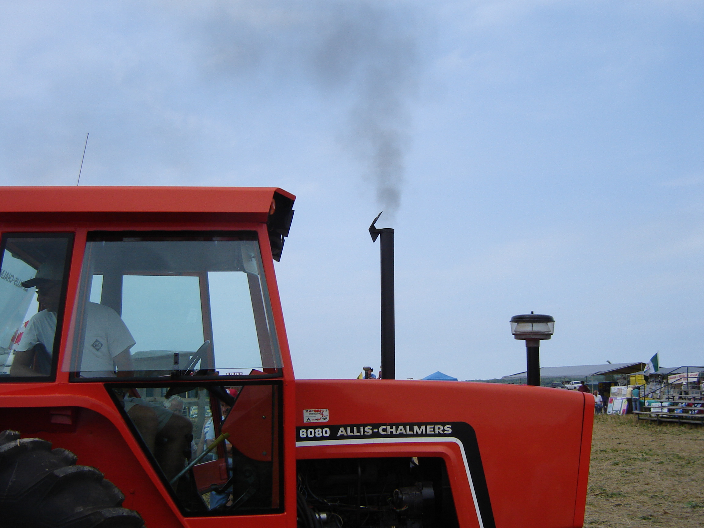

Our local club has an M&W PTO dyno that they would set up and use at their shows in the summer.  I have used it on many of my tractors.  Does a good job of clearing carbon out of some of those diesel engines!
