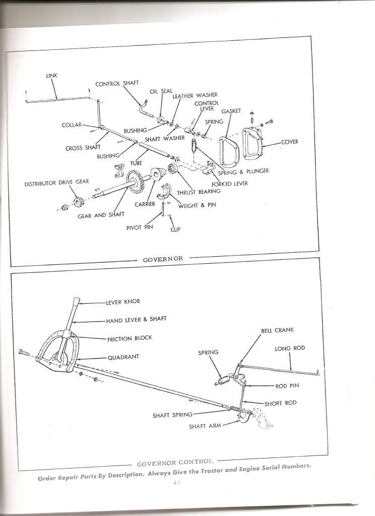

Post Options Post Options   Thanks (0) Thanks(0)   Quote CTuckerNWIL Quote  Post ReplyReply Direct Link To This Post Posted: 07 Jul 2019 at 5:40pm
I don't think the WD ever had the anti surge spring like the C,B and CA. It could be added to help remove slop from the linkage though
 You could hook a tension spring in place of the cotter pin at the carb and run it forward to some anchor point. The CE engine had a small cross hole in the "LINK"  pictured below. The spring ran up to a manifold stud toward the front of the engine.
http://i813.photobucket.com/albums/zz54/thebigyellowtruck/tractor/governorandthrottle.jpg

Post Options Post Options   Thanks (0) Thanks(0)   Quote bhaynes Quote  Post ReplyReply Direct Link To This Post Posted: 07 Jul 2019 at 6:50pm
Thanks guys! I took the carburetor off and moved the throttle rod. There were two holes it could hook up too on the carb. a lower and upper. I moved it to the upper and its running smoother. still moves some, but better.
I think the gov. needs adjustment (however you do that) and still needs a new carb.
