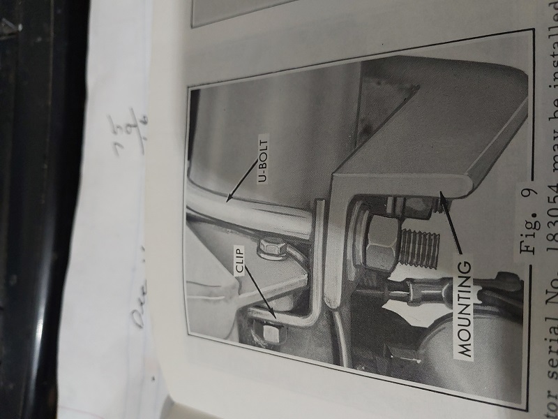

Kenny this is exactly the picture I needed
My manual doesn't have that! Does it also show how the angle clips from u bolt to finder brackets that Dr. Talked about?
My manual mentions or shows no clips

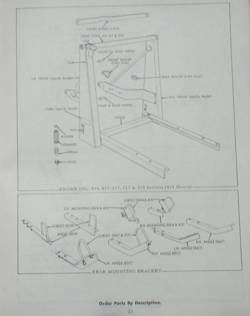

Josh
Looking at Kenny's P. 10 Fig. 8 Picture, the R/H Loader Frame is outside the Fender Bracket, and you probably need to Power out the Power Shift Wheel to provide clearance for the Loader Frame.
As someone mentioned earlier, you'll need to keep an eye on the spacing between the 2 up-rights so that the Loader Boom will fit easily between them.
When you purchased the Loader, did you get the 2 cross braces that bolt to the side Frames.
The one that goes at the very top between the up-rights would be the important one to help maintain the correct spacing.
G
See Brians picture, last one, page 23

Kenny's 1st picture (of a Ser,IV with the Traction Booster Linkage mounted to the R/H Axle Housing) was from Operators Inst. Form TM-374
G

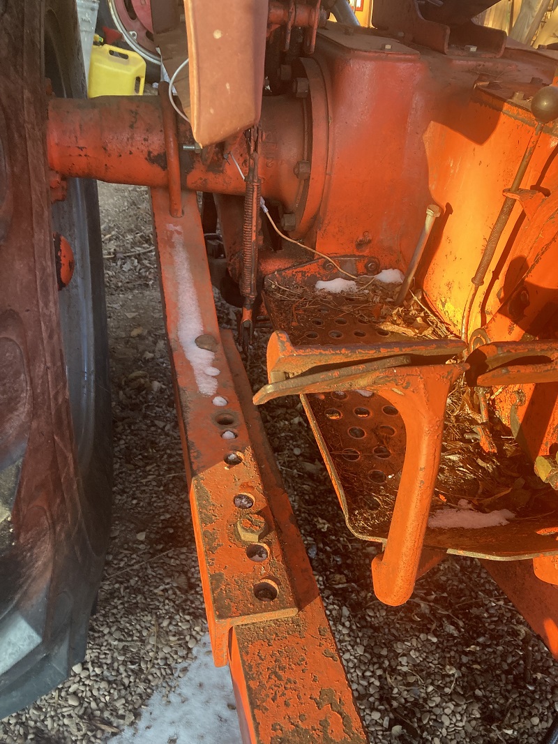

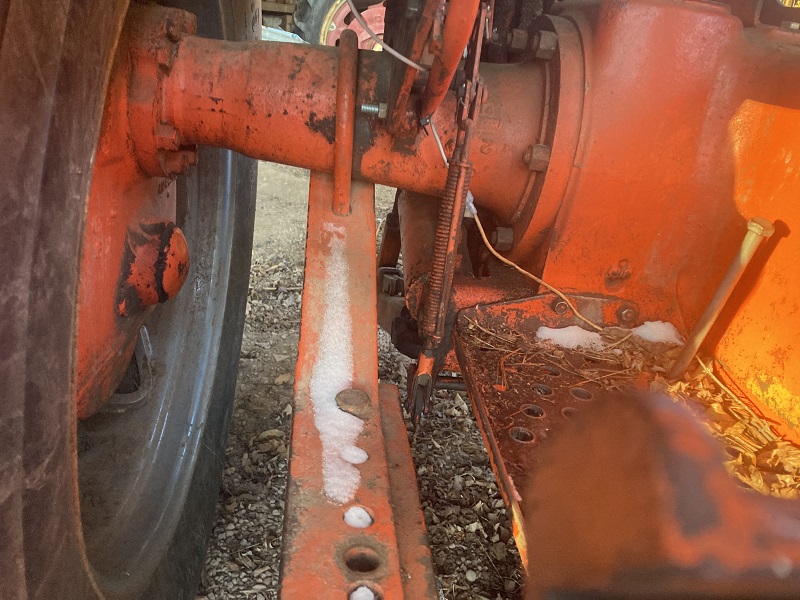

  One more thing to think about, who know what the loader been through the frame could be sprung I've one that is and couldn't tell until I tried to replace the bucket, put your top cross over on but leave the bolts loose now go to the rear mounts and get your bolts to line up you may also have to waller out a hole or two. You may or mayn't need a lot of patience. :)

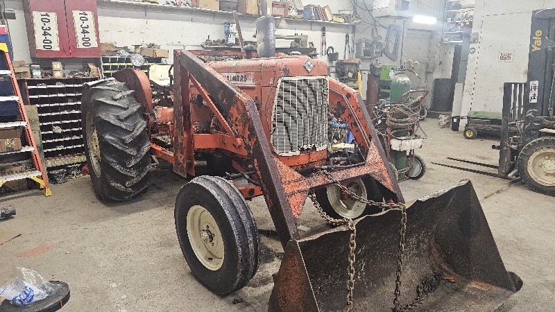

Post Options Post Options   Thanks (0) Thanks(0)   Quote Oldwrench Quote  Post ReplyReply Direct Link To This Post Posted: 23 Jan 2025 at 3:38pm

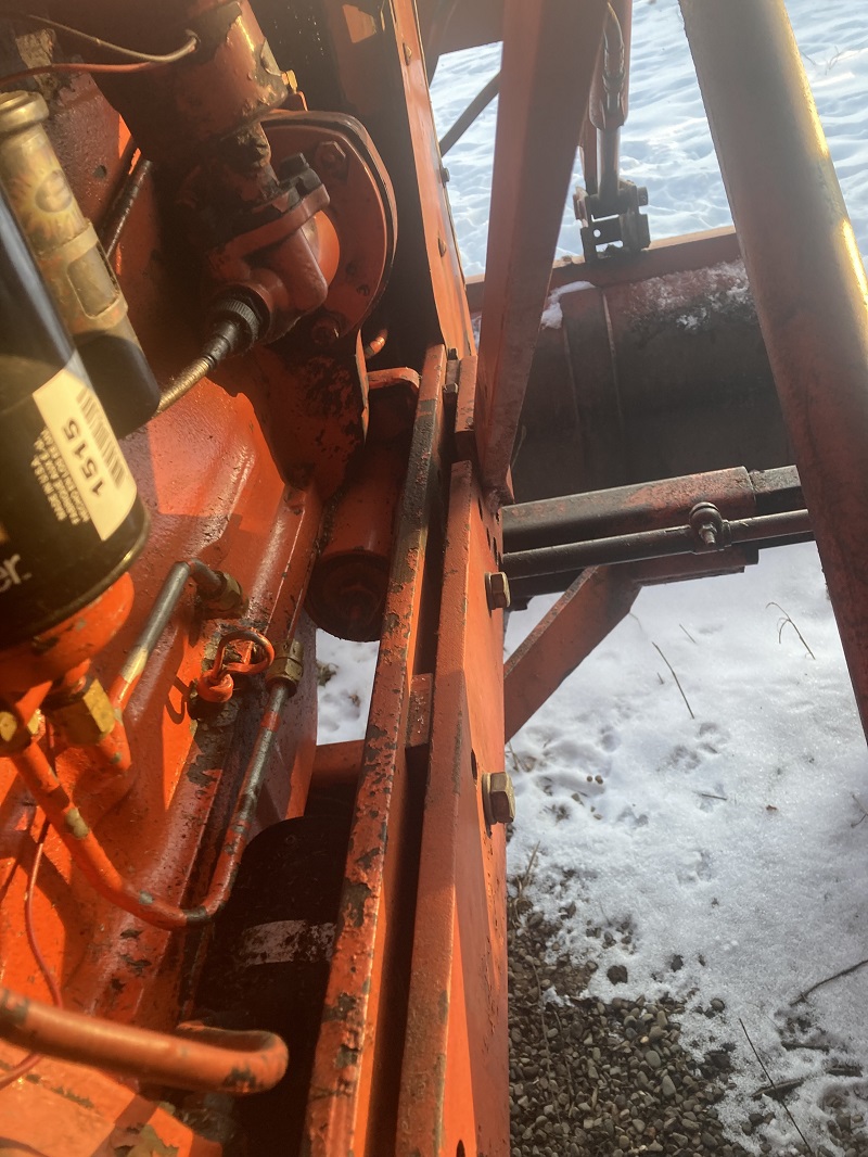

Sorry I'm late getting these photos, but here are some of the 500 loader on my Series IV.  There are spacers (~ 1/2"?) on the frame.  The rear attachment U bolts are outside the fender brackets.  The rear end of the main frame doesn't interfere with the traction booster linkage, but without the spacers, it would be close.
Points: 22171
Post Options Post Options   Thanks (0) Thanks(0)   Quote DrAllis Quote  Post ReplyReply Direct Link To This Post Posted: 23 Jan 2025 at 4:57pm
A 500 loader on a D17-19 is supposed to use spacers. No spacers on 180-185-190-200.

Post Options Post Options   Thanks (0) Thanks(0)   Quote JoshDay94 Quote  Post ReplyReply Direct Link To This Post Posted: 27 Jan 2025 at 10:18am
Loader is on. Now just need to plumb up. Thanks for the help guys
