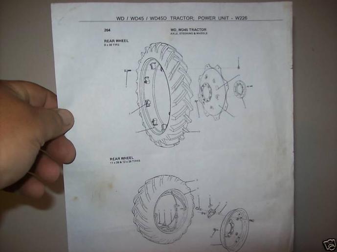

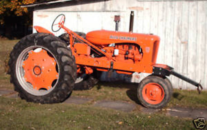

Fields
Joined: 25 Apr 2011 Location: Reedsburg, Wi Points: 359 |
Post Options
Thanks(0)
Quote Reply
Posted: 30 Sep 2014 at 11:18pm |
Here is the page out of the manual. And the puller I was going to buy.
