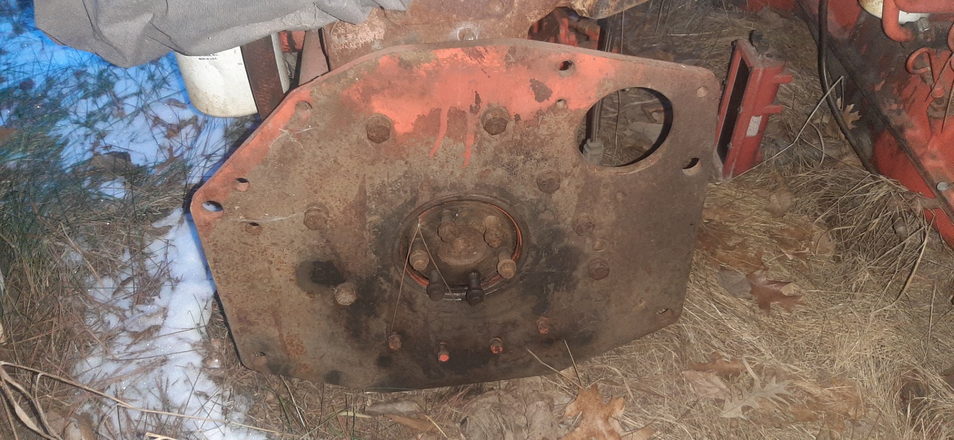

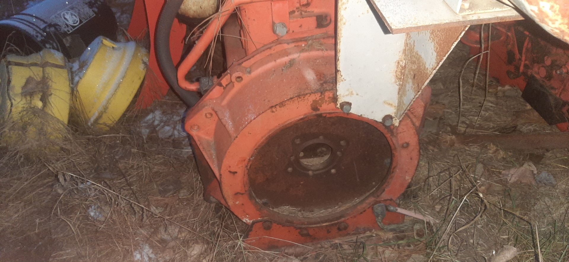

Post Options Post Options   Thanks (0) Thanks(0)   Quote orangereborn Quote  Post ReplyReply Direct Link To This Post Posted: 10 Jan 2024 at 11:28pm
The tag is from the power unit and the other two are  301 power units..that is as much as I know about bellhousings.......Dale
Edited by orangereborn - 13 Jan 2024 at 1:53pm
