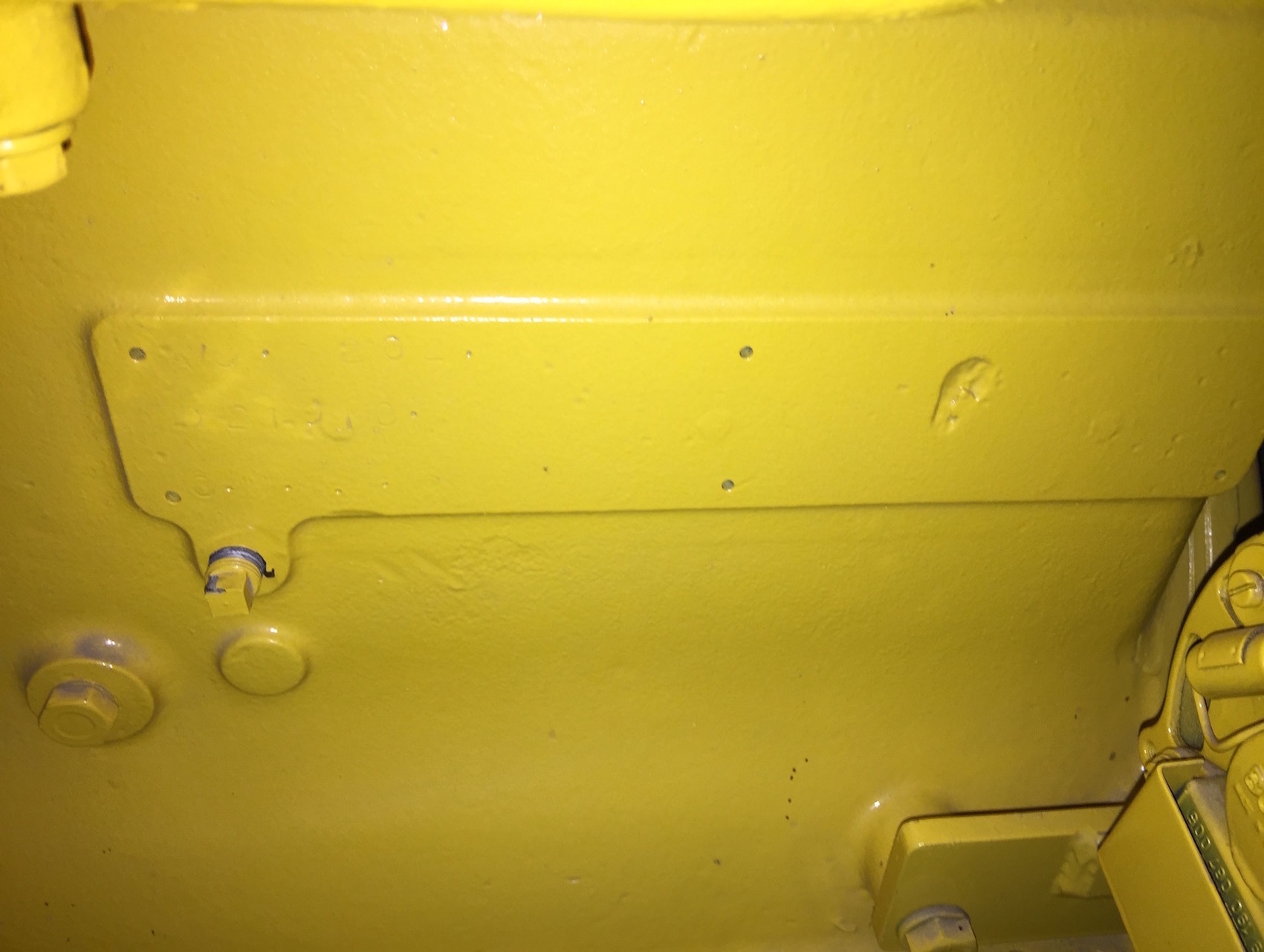

OK thanks for the info , mine is in an m65 grader it has six small holes where it looks like a tag has been so just thought i would try and get a new one i will try and load some pics

Please post a picture of that area on the block. If it's what I  think it is, that's where the factory (Harvey engine plant) would install the "Options" metal stamped tag. When an engine was built for a customer other than AC it would go over to department 76 (commercial products) for a build as per customer order. What was added to the engine wether it be clutches, alternators, sheet metal, radiators, starters, ect. The catalog number for each options group was stamped onto a metal plate and attached to the block with rivets. That "tag" was about 1 1/2" tall and about 8" in length.

Post Options Post Options   Thanks (0) Thanks(0)   Quote ACjack Quote  Post ReplyReply Direct Link To This Post Posted: 11 Apr 2016 at 9:29am
That is the pad where the Harvey engine plant would attach the options plate when the engine was built for a customer other than Allis Chalmers.
