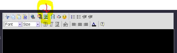

How do you post a picture on here?

You post a photo by clicking on the button indicated in the photo below.  this only works if you DO NOT use "quick reply".
After you click on that button, a pop-up will ask you to choose a file from your computer.  .jpeg files seem to work best for me.
