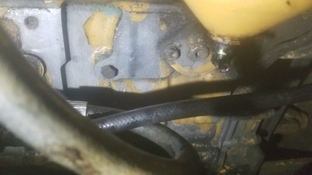

Going to pick up the freshly built/rebuilt 39MT starter this afternoon. Basically an older case with everything new inside. Wanting to get this old TLB out of where it's at and back to the shop for further evaluation; but the power shuttle seems to be worn out. Fine cold but as it warms, begins to slip and the tractor won't pull itself unless in low gear. Not much use pushing into a pile this way at all......

What a circus. Rebuilder did a nice job building up a new starter but installed 24VDC field coils instead of 12VDC and won't work in the application. Too late in the day when I arrived to correct so will be addressed the first of the week. Forecast is very cold for the next few days so no real loss of time.

Got a call and starter is rebuit to 12VDC but it's one degree here now and going to remain cold today so probably not even going out of the house.....

Warmed a bit yesterday so picked up the starter and installed. Engine fired readily and settled into an anything but quiet, smooth idle. I need to top off the shuttle reservoir as it was found too low to move the tractor so further delay..... Tractor has a single speed B-W power shift transmission in front of a B-W T-18 series four speed manual transmission minus the reverse gears on both the main, and counter shafts. It works well when cold, (and obviously has oil) but needs a rebuild.

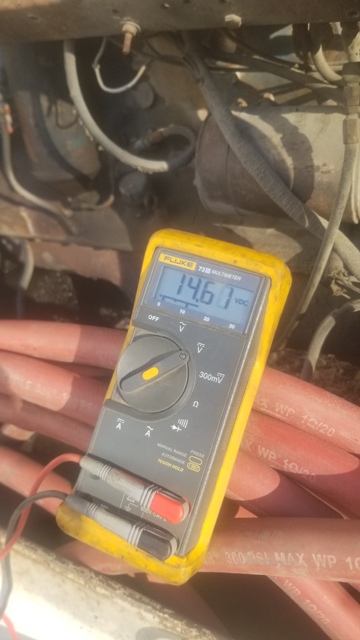

Got to rooting in the junk at the shop and low and behold, I found the non working old 37A 10SI alternator originally from the backhoe that was corroded all to hell from being outside many years. Regardless, I busted it open, metered both the stator and rotor with both checking good. I then removed the rear case from the compressor alternator (which was overcharging) and installed the old stator into this rear case. I then reinstalled the back end onto the alternator, reconnected electrically and started the engine. At about 1200rpm the alternator picked up and here is the voltage output:
It did start dropping the charge rate as the battery recharged but nowhere near the 17.7VDC I was seeing earlier.
