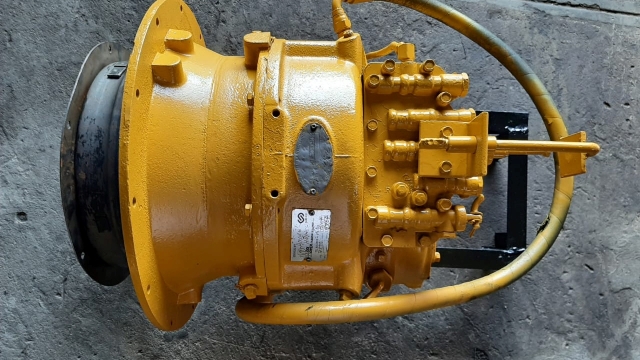

Warmed a bit yesterday so picked up the starter and installed. Engine fired readily and settled into an anything but quiet, smooth idle. I need to top off the shuttle reservoir as it was found too low to move the tractor so further delay..... Tractor has a single speed B-W power shift transmission in front of a B-W T-18 series four speed manual transmission minus the reverse gears on both the main, and counter shafts. It works well when cold, (and obviously has oil) but needs a rebuild.

This is the same transmision that is installed:
