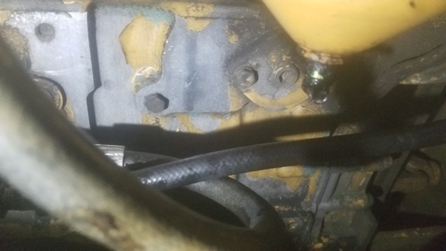

Talked to starter rebuilder this afternoon and not going any further with the 30MT. He also recommends a 39MT to replace this one. Didn't have one but will build one up from parts for me. Less $$$ to go with the 39MT too as two of the field coils of the original starter were out of spec, and one pole shoe was cracked/busted from the starter motor being waylaid with a hammer several times. There are actually dents beat into the housing. Also discovered the cylinder block in the tractor is aluminum. Head, and flywheel housing are iron, but most everything else is aluminum.

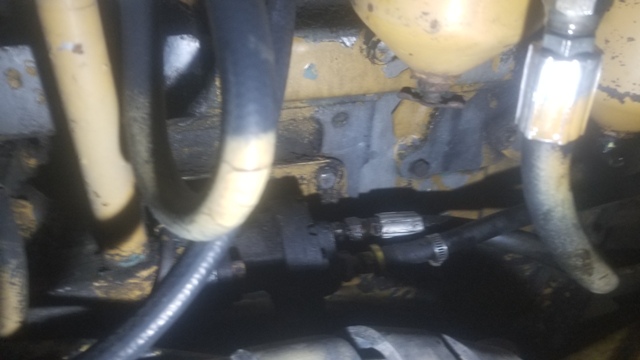

Surprised me. I've seen many 3-53 Detroit engines in both iron and aluminum when in the military but this is the first civilian aluminum block I've seen. However, I don't know much history on the tractor. It was very near dark when I was pulling the starter and a magnetic work lamp wouldn't stick to the block is how I found it before looking closer and snapping photos.

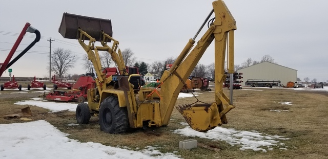

This engine is in a Clark backhoe loader but may go into that HD5G if the 2-71 is not good. I'd like to fashion a clamshell bucket, (or tines) for the HD5G as have a lot of brush and trees to take out at some family property. I have about 1/3rd of a rake built for the 11B and once all the relatively "heavy" groundwork is done, I'd like to leave this HD5G at the property for maintenance of the place. The TLB is shot but the Detroit engine runs well and the hydraulics are very strong. It came along to me in a trade when the former owner traded both the 11B, and this backhoe in on a new mid sized excavator.
