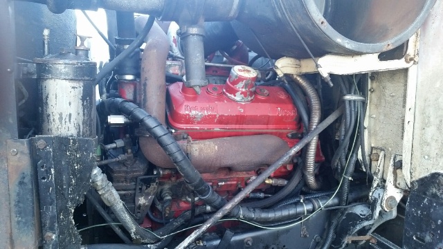

Ahhhh the sound of that 2-71 Detroit.....

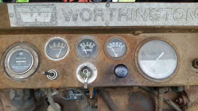

All levers and handles operate smoothly with even spring tension behind them. She said it pulled very easy with the 4020 Deere tractor. I didn't sit in it so don't know about the transmission shifting but the hand clutch feels as it should.
Drizzling out when the photos were taken and my phone shuts down on "humidity" constantly if out of the holder in this cool weather very long. I'm told the machine ran/operated well but was loud in a push......

Some rather odd looking pads on the tracks, first time I've ever seen that.  Any story behind it?

Thanks Coke. No idea to any of this myself. Looks like it's been a long time, (if ever) this machine had counterweights installed. Those on your machine appear to be cast iron/steel composition. If the machine proves serviceable when it's back at the shop, I'll give it a good pressure washing and remove the tracks to evaluate u/c further, and fully. It looks fair setting there with plenty of adjustment left, and there was no mention of any track walking off, but I'd like to evaluate the front idlers, bearings, etc. before pressing it into any kind of service as it will be kept several miles distant from the shop.
I did snap this but neglected to post earlier. No idea if it reveals anything to the discerning eye or not:

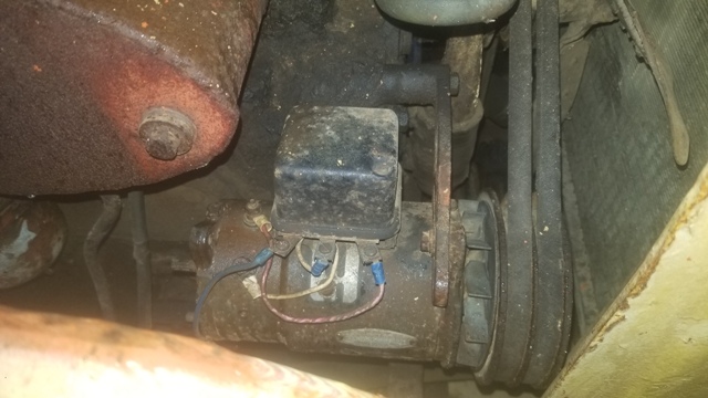

The 2-71 DD in my Son-in-law's HD5G has a twin belt drive; I removed the pulley from the generator and put it on a Delco one-wire 10SI alternator, then modified the mounting to suit.

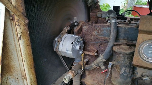

I did like Les and took the pully off the generator. It fit the Delco alienator with no modification.

I took the pulley from a alternator off a 70 series GMC that was double belt , then put in lathe and widened groves to accept the B width belts , so still running 2 belts

Was over there yesterday in the rain and the generator with two belts is still in place. Definitely B series belts so if that sheave will fit I'll reutilize it.

The twin belt sheave fit right on my 10SI unit perfectly and I re-used the belts as well, you will need to get a bit creative with mounting it Wink

The generator that was on my Son-in-law's HD5G is a Delco-Remy third brush type that uses the third brush for current (amps) limiting but has a two-coil regulator for voltage regulation. The previous owner told us that the generator did not work, and he was correct, so I swapped it out for the 10SI alternator, which I do not regret.
I later checked out the generator on the bench and found that the regulator was not making ground contact, when properly grounded it produced voltage while being spun with a drill. I did not give it a full workout at the time but I plan to when I get my test bench set up.
Your generator appears to be a different type and has what might be a three-coil regulator, is it possibly a Prestolite? If it functions properly I would just run it.
