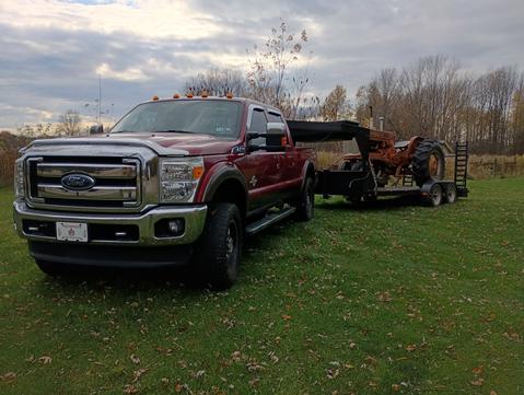

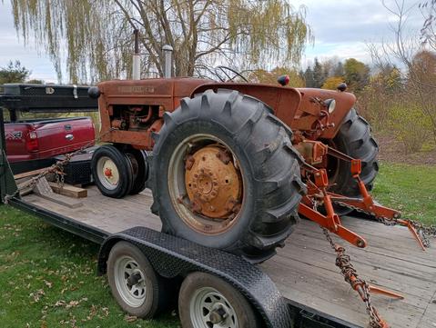

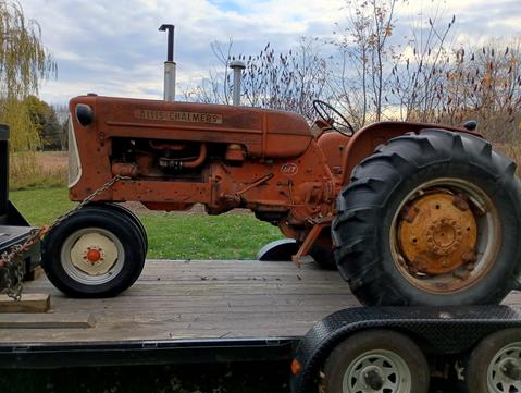

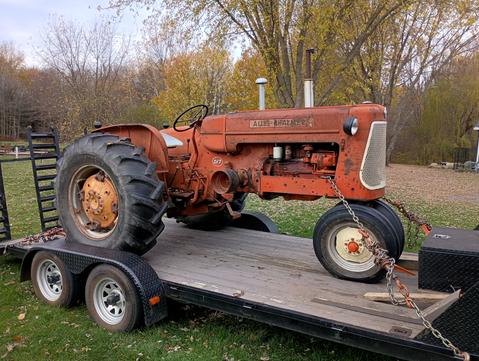

Allis guys,
It is hard to believe its been 5 years since I posted anything on the D17. Yep its still here. It goes to the daughter in the spring and sets outside most of the summer.I told here it might stay at her place if she had a building! Hint Hint!
So its home in the tractor mini shop and dry again for winter.
I had a hard time starting it.
