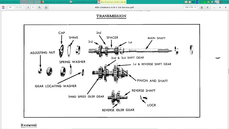

1. Does anyone have a picture of how those forks go onto the gears? I aligned them to the grooved collars on the insides of the gears to reassemble. The gears slid back and forth by hand, but tractor would not roll by hand, regardless of gear position, whether clutch was in or out. There would be an audible click after a few inches of tire rotation and movement came to a standstill.

to get the shift cover back on, the gears have to be in NEUTRAL and the shift forks / lever need to be in NEUTRAL.... if you can slide the gears by hand, but can't get the TIRES to roll, then it will be hard to find Neutral ( assuming things are FROZE with ice).... with your other notes on the clutch and final drive, it is POSSIBLE that REV gear is froze and causing the problem, and the shift lever and forks are in the RIGHT POSITION now.. since you can turn the top shaft to the PTO, im thinking you are alread in NEUTRAL ??
When I moved the lever up, the pulley locked to the drivetrain and I couldn't rotate it by hand. When the lever is down, the belt pulley turns freely and spins the shaft heading forward to the sickle drive
so your Engine clutch is working OK and the trans TOP SHAFT is working OK and the PTO drive ( top) is working OK ..... sounds like stuck at BOTTOM of trans..

That indicates that the brakes and final drives are not locked up, but the pinion gear at the output of the transmission is not rotating for whatever reason.
Originally posted by CBenedict CBenedict wrote:
... Upon reassembly, I can click into any gear except reverse, so I must have done something wrong.
Probably need to pull the side cover again and take a very careful look at those gears meshing
