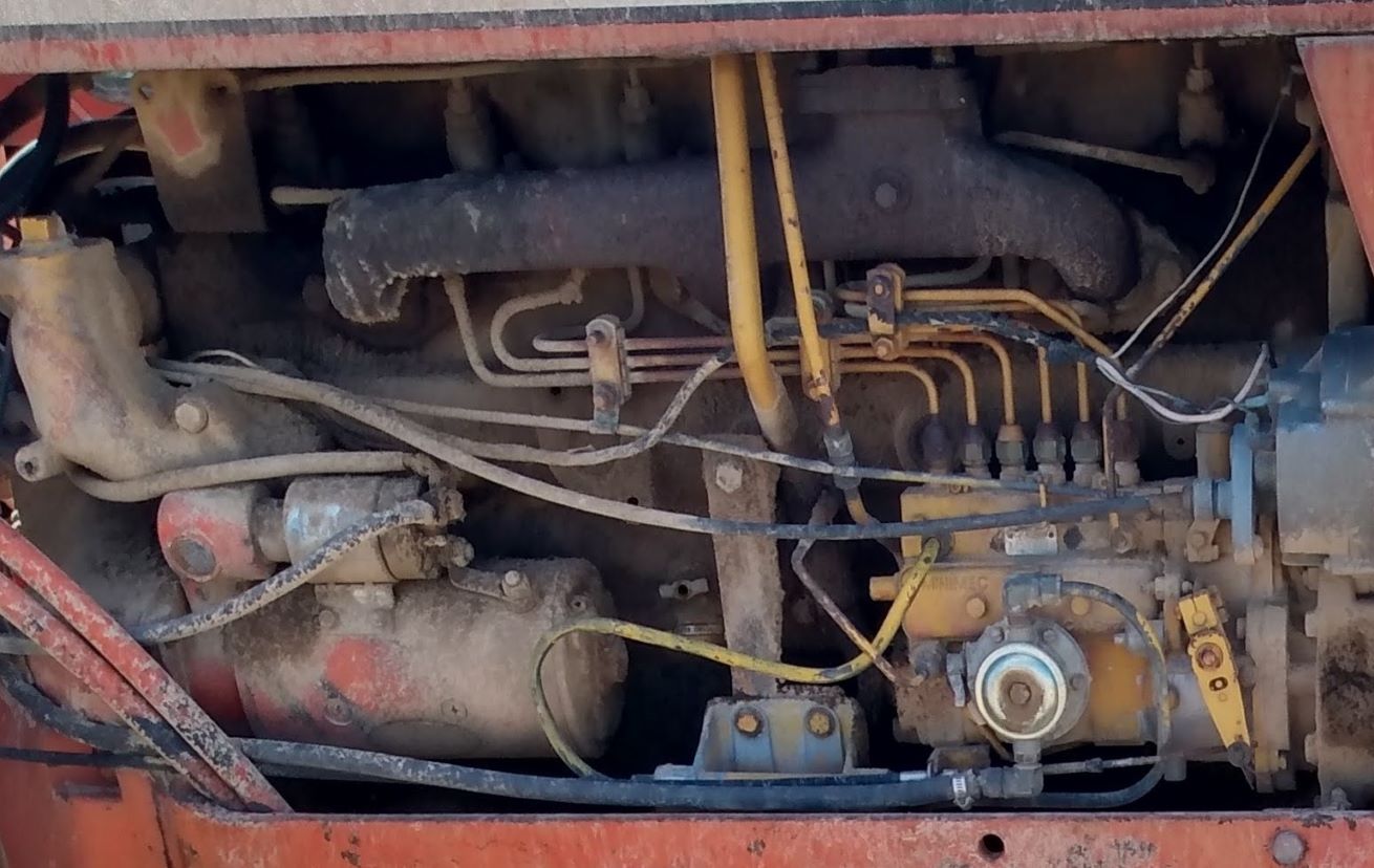

I finally figured out how to post pictures, and yesterday was reminded of one of the things I wanted to find out. I bought my 190XT at auction 35 years ago (sight unseen, a friend went for me as I didn't have the time) and it has been relatively problem free ever since. It has an obviously replaced engine, and when I asked the local Allis dealer about it they said it was probably from an MH Gleaner - this was based on my description of the injector pump and them not seeing it. So for many years I had an MH engine in my 190XT, replaced the water pump with an MH water pump, no problem. Then I found this forum, and was reading a thread one day where DrAllis stated that combine engines don't have hydraulic pumps. Mine does, and it looks like it belongs there. One thing I really like about it since I mostly run a baler is the engine speed, at full throttle it turns the PTO at 540 so I can run it half asleep and not have to worry about getting the throttle set right. Anyway, the suggestion yesterday was that it might be a loader engine.

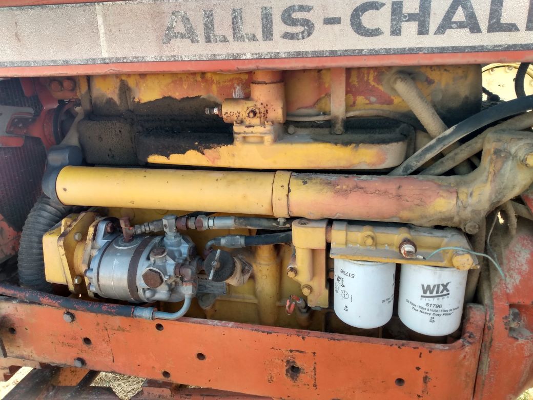

A Gleaner combine engine was never yellow. Construction equipment was yellow. The hydraulic pump drive and timing cover mounting area look strange to me, so that too could be construction.  The engine oil cooler and dual oil filters are early 1970's.  Water pump is left hand intake.  Alternator is right hand instead of left side like a tractor would be. The injection pump is a Simms brand similar to a 1972-73 model "L" Gleaner combine. So, I'd guess it came from an early 70's wheel loader.  It is clearly a Mark 2 engine which I think was 130 HP @ 2400 RPM.

Loader engine for sure. That's a dual oil cooler. One for engine one for transmission. The air compressor mounts where your hyd pump is. Just like my 78 545B.

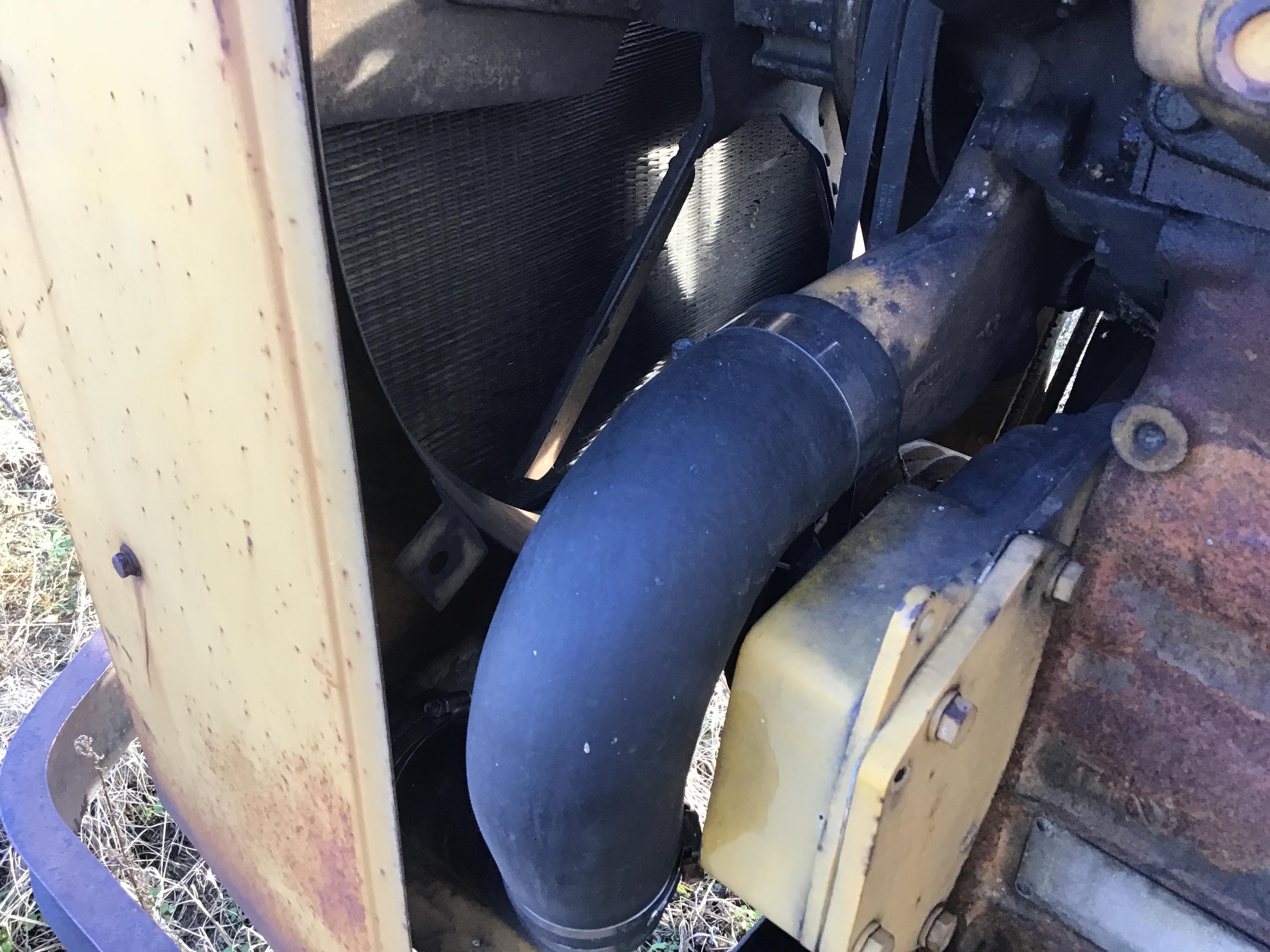

It is nice knowing a little better what it is. I think I paid $1200 for it, so it definitely doesn't owe me anything. I bought a New Holland 580 new in 1995 and have replaced the floor in it at least twice all with this tractor running it. Have a CaseIH 551sb now and it gets pulled by this tractor a lot too. Now that I have a 7000 the oil filters on this one make sense. Downside to buying at auction is I don't have the backstory on how and why the engine transplant happened, but the radiator has clues as to the why. It is nice finding a group that knows about most everything Allis, at least the farm and industrial equipment.

Thick front plate = industrial  loader application. As Doc stated - not a combine engine.

Uses same oil filters as 8000's with 426 engines
