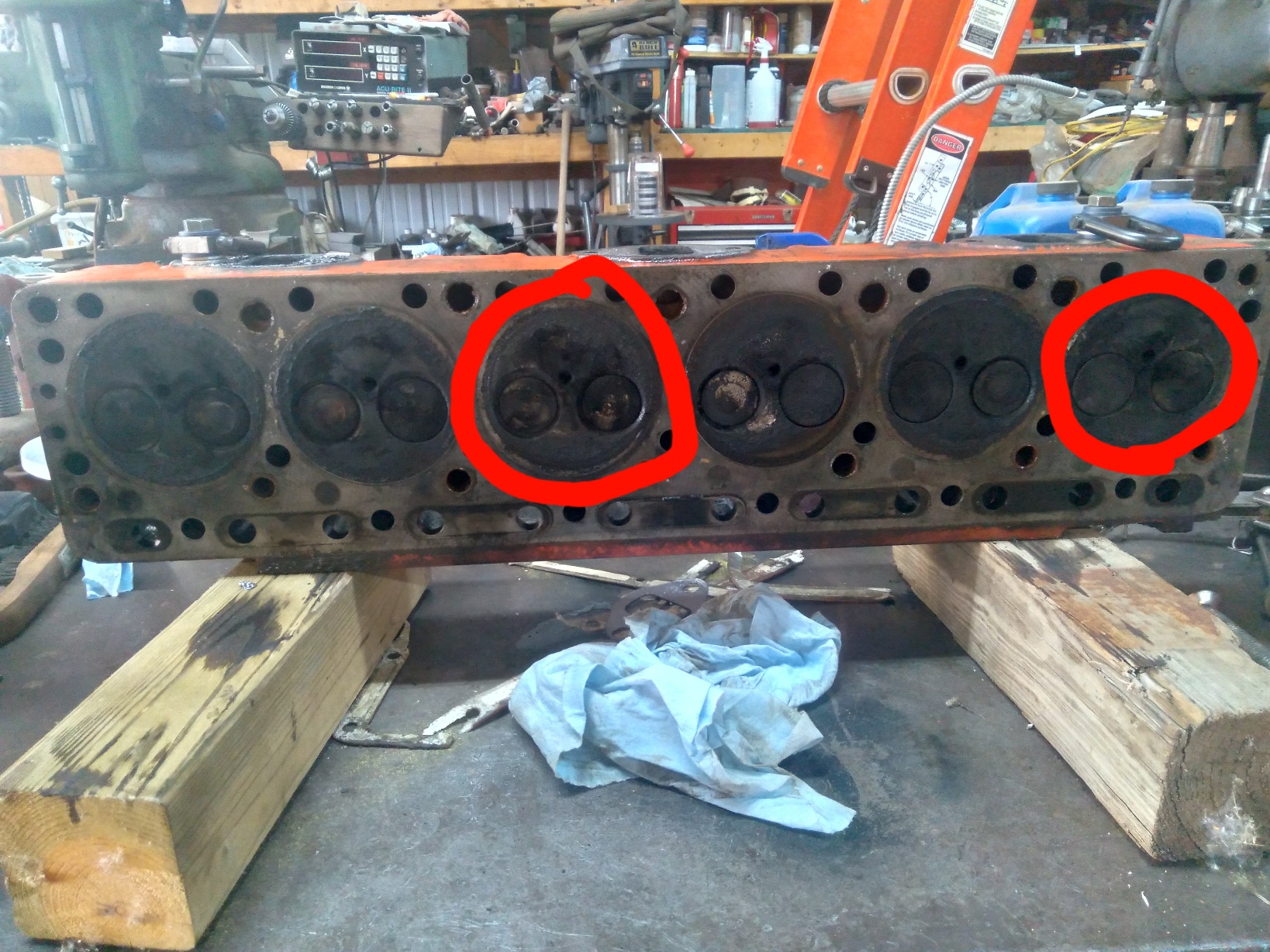

Post Options Post Options   Thanks (0) Thanks(0)   Quote marzer Quote  Post ReplyReply Direct Link To This Post Posted: 03 Aug 2021 at 1:09pm
This explains a lot.
marzer View Drop Down
Joined: 08 Dec 2014
Location: Saginaw valley
Points: 37

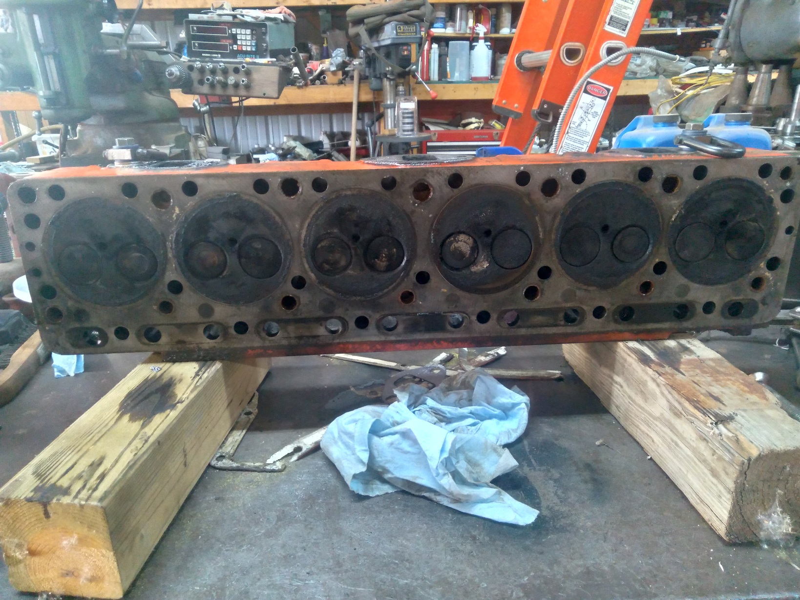

Post Options Post Options   Thanks (0) Thanks(0)   Quote marzer Quote  Post ReplyReply Direct Link To This Post Posted: 04 Aug 2021 at 7:35am
Red Bank View Drop Down
Joined: 18 Apr 2018
Location: Germanton NC
Points: 1051
Post Options Post Options   Thanks (0) Thanks(0)   Quote Red Bank Quote  Post ReplyReply Direct Link To This Post Posted: 04 Aug 2021 at 8:40am
Am I looking at that right? The valves are in the wrong spot?
Joined: 08 Dec 2014
Points: 37
Post Options Post Options   Thanks (0) Thanks(0)   Quote marzer Quote  Post ReplyReply Direct Link To This Post Posted: 04 Aug 2021 at 9:06am
Yup. This was not an easy one to figure out.
Points: 8308
Post Options Post Options   Thanks (0) Thanks(0)   Quote DougG Quote  Post ReplyReply Direct Link To This Post Posted: 04 Aug 2021 at 6:23pm
Oh my my my - interesting !
Amos View Drop Down
Location: Ontario
Points: 1318
Post Options Post Options   Thanks (0) Thanks(0)   Quote Amos Quote  Post ReplyReply Direct Link To This Post Posted: 04 Aug 2021 at 6:50pm
Now who the heck done that!!!!?
Points: 8565
Post Options Post Options   Thanks (0) Thanks(0)   Quote SteveM C/IL Quote  Post ReplyReply Direct Link To This Post Posted: 04 Aug 2021 at 9:07pm
Rebuild head and pump and should out last you. (new valves)
Joined: 08 Dec 2014
Points: 37
Post Options Post Options   Thanks (0) Thanks(0)   Quote marzer Quote  Post ReplyReply Direct Link To This Post Posted: 05 Aug 2021 at 5:21am
The valves where contacting at the very top edges. I don't know how it ran so long without burning the valves. The plan is to clean everything up and check contact. If it had a valve job, the interference
should be ok.
