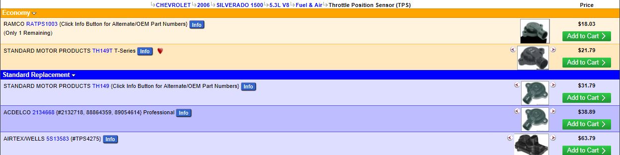

Post Options Post Options   Thanks (0) Thanks(0)   Quote Stan IL&TN Quote  Post ReplyReply Direct Link To This Post Posted: 24 Apr 2018 at 10:48am
I made some assumptions on engine/model.  These are from Rockauto.com

Post Options Post Options   Thanks (0) Thanks(0)   Quote thendrix Quote  Post ReplyReply Direct Link To This Post Posted: 24 Apr 2018 at 3:24pm
Those were some pretty good assumptions there Stan
