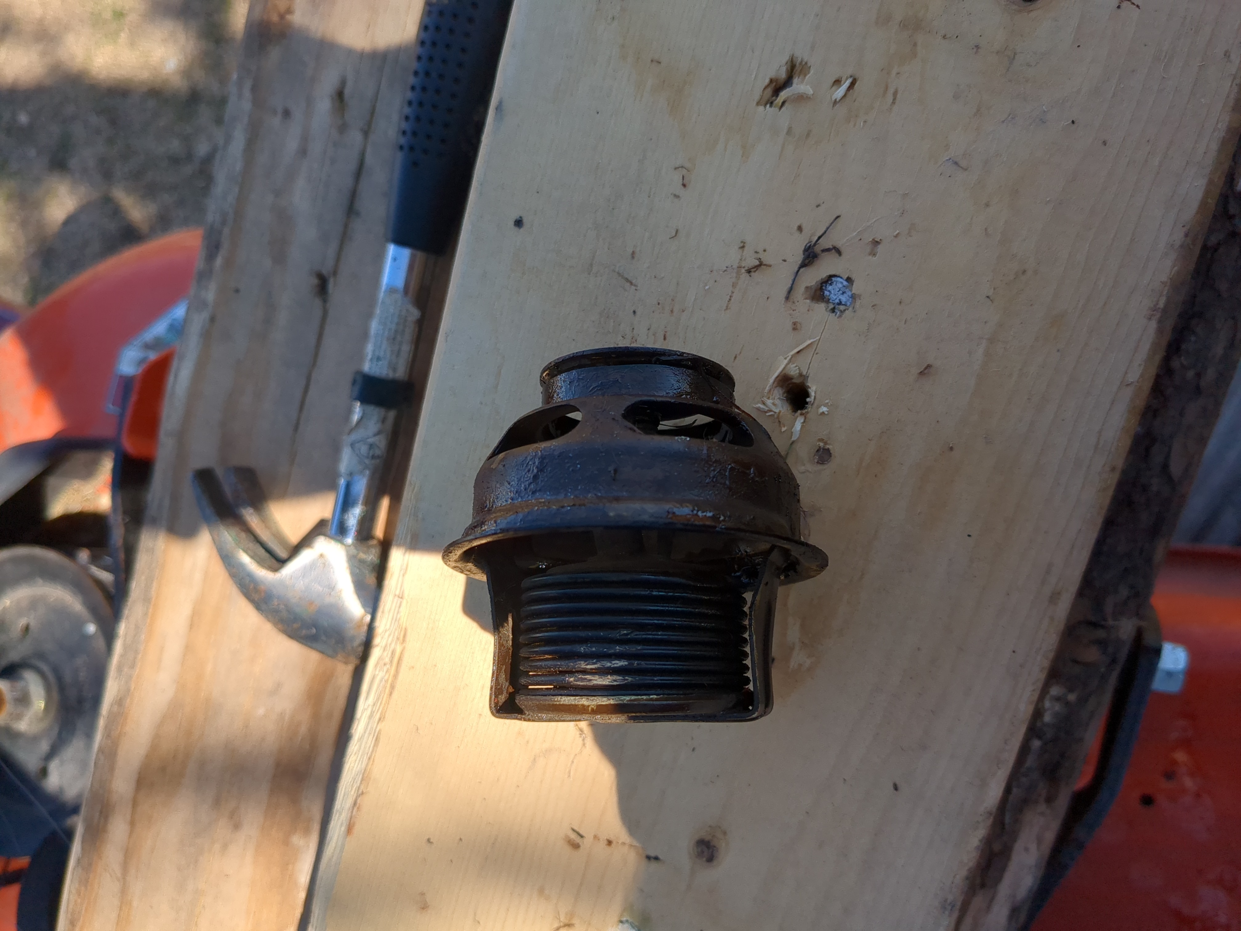

At what temperature is the thermostat supposed to open
sparky View Drop Down
Joined: 13 May 2011
Location: So. Indiana
Points: 1867
Post Options Post Options   Thanks (0) Thanks(0)   Quote sparky Quote  Post ReplyReply Direct Link To This Post Posted: 08 Apr 2023 at 1:14pm
Rule of thumb average I’d say is 180-190 degrees.
hunter321 View Drop Down
Joined: 11 Jan 2021
Location: 52320
Points: 520
Post Options Post Options   Thanks (0) Thanks(0)   Quote hunter321 Quote  Post ReplyReply Direct Link To This Post Posted: 08 Apr 2023 at 2:34pm
This is the thermostat I have.
I think parts are missing
