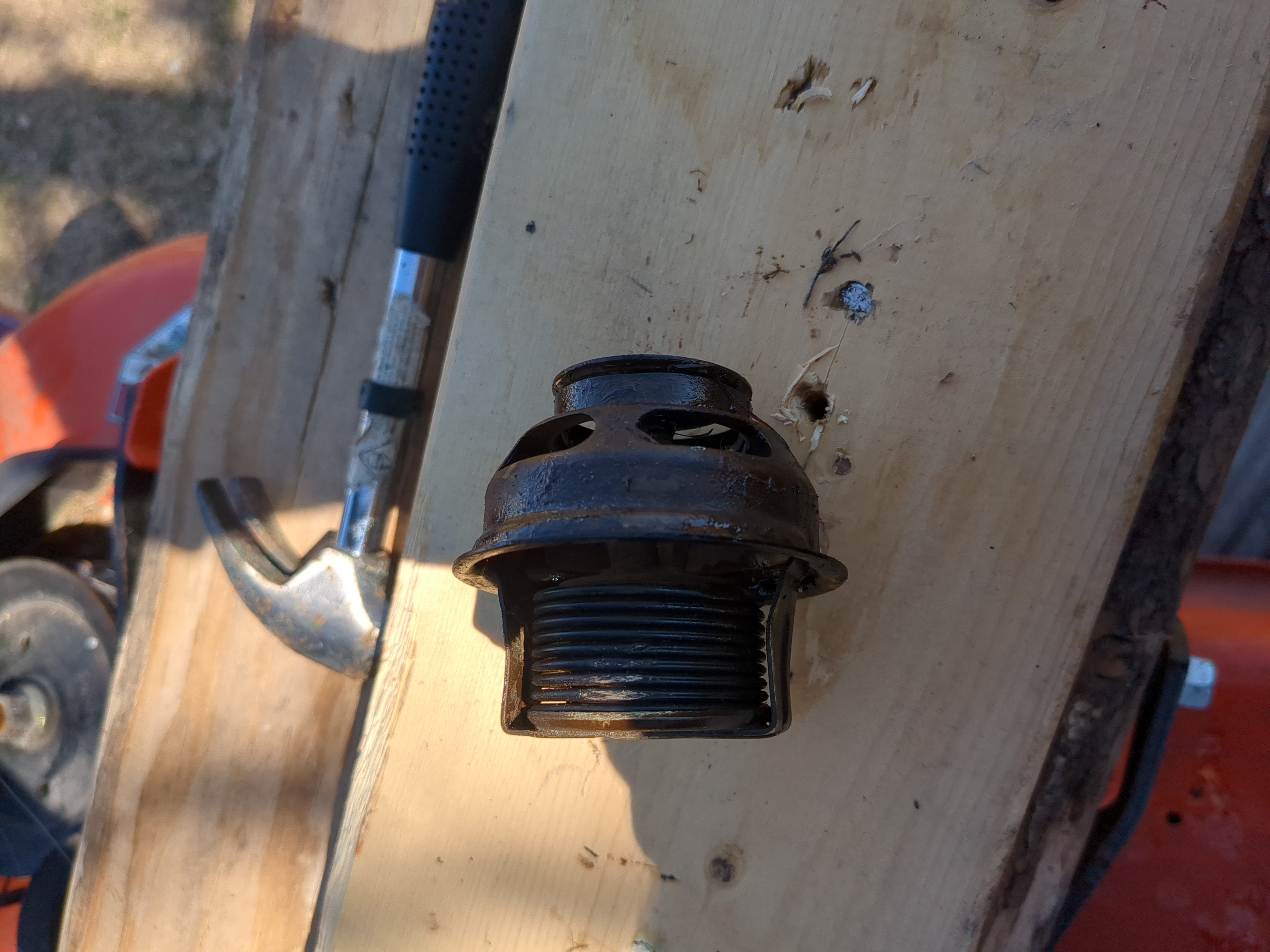

At what temperature is the thermostat supposed to open
Posted By: sparky
Date Posted: 08 Apr 2023 at 1:14pm
Rule of thumb average I’d say is 180-190 degrees.
Posted By: hunter321
Date Posted: 08 Apr 2023 at 2:34pm
This is the thermostat I have.
I think parts are missing

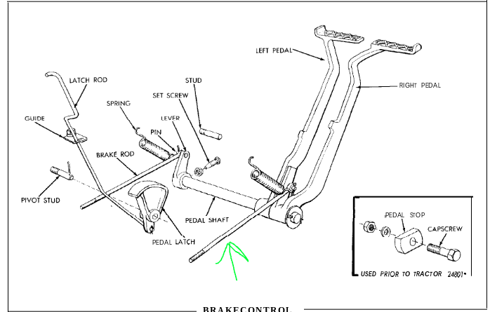

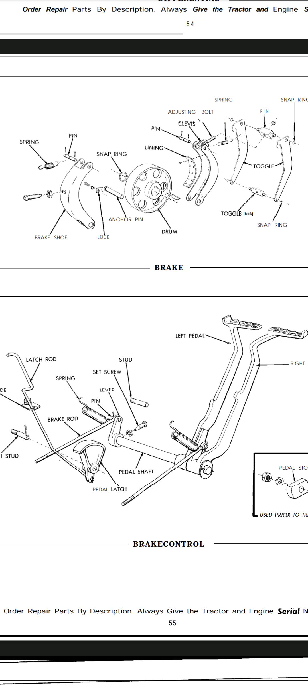

how does the rod with thegreen arrow pointing at it attach to the tractor. one of mine is broken.
Posted By: SteveM C/IL
Date Posted: 04 May 2023 at 10:53pm
Find the picture of the brake shoes....you'll see the part it screws into
Date Posted: 05 May 2023 at 8:11am
Can you mark the connection point
Date Posted: 05 May 2023 at 8:24am
bottom right ....it's called a toggle pin. That rod screws into it . They get rusty and twist off if forced to turn. Once everything is set up in correct  position/clearance with the brake shoes, that rod never needs adjusted again. Brake adjustment is done through top covers on rear housing.

Date Posted: 18 May 2023 at 10:32am
If the wd and wd45 have the same brake rod I could replace it easy
Date Posted: 18 May 2023 at 1:10pm
If they are not the same where can I get them
Date Posted: 18 May 2023 at 1:37pm
same according to parts book

It started and the pully plug blew out
Posted By: DrAllis
Date Posted: 25 May 2023 at 7:23pm
So, put the belt pulley plug back in the hole and get a large 1/2" flatwasher to stick under one of the three bolts near the belt pulley hole to hold the plug so it cannot fall out again.
Date Posted: 26 May 2023 at 7:56am
Is there supposed to be hydraulic fluid behind the plug
Date Posted: 26 May 2023 at 9:49am
It leaked a lot of hydraulic fluid from the belt pulley plug
Is that bad that fluid came out of there
Posted By: DrAllis
Date Posted: 26 May 2023 at 9:54am
On the left side of the tractor ahead of the battery box is a short dipstick. This is for the hydraulic pump. Refill it with hydraulic oil. This oil is what came out of the belt pulley hole.
Date Posted: 26 May 2023 at 10:31am
Ok so when the plug comes out it emptys the hydraulic pump reservoir
Posted By: DrAllis
Date Posted: 26 May 2023 at 11:02am
It doesn't "EMPTY" it. It loses a quart or two out of a 6 quart compartment. Refill until the dipstick says it's full.
Date Posted: 26 May 2023 at 11:03am
Ok I will.
So it is normal for it to have fluid in it
Posted By: DrAllis
Date Posted: 26 May 2023 at 11:51am
YES. If you had a belt pulley, the oil is what lubricates the gears and bearings.
