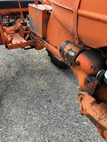

Allis B Starter rod
john2189 View Drop Down
Location: Minerva,Ohio
Points: 444
Post Options Post Options   Thanks (0) Thanks(0)   Quote john2189 Quote  Post ReplyReply Direct Link To This Post Topic: Allis B Starter rod
    Posted: 17 Jun 2026 at 10:21am

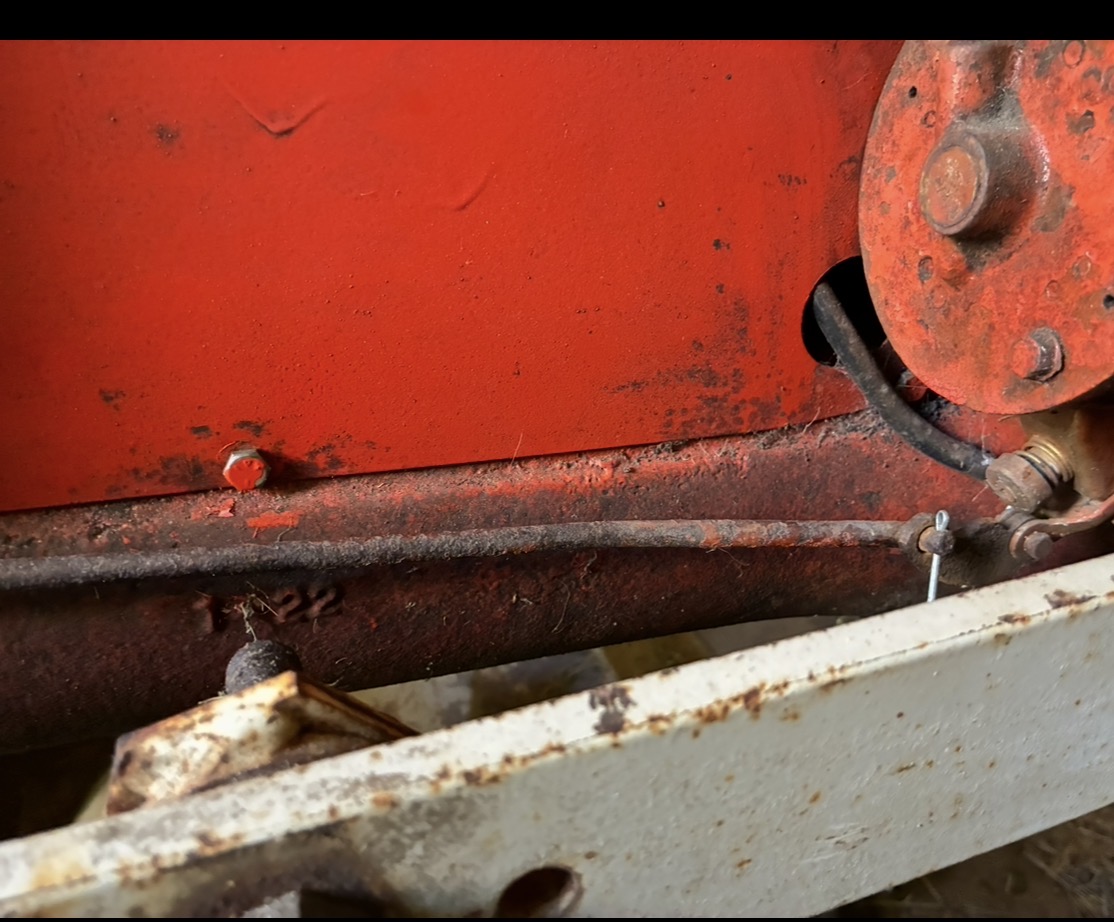

What is missing that holds the rod up to the starter button? It is very hard to push the rod when sitting on the seat. If you are standing next to it, you can hold the rod up.

The rod needs to moved slightly forward which in effect moves it slightly upward. Right now you have a straight line push against the lever that pushes on the starter button. You may need to drill a small hole in the rod and insert a cotter pin that will prevent the rod from retracting as much through the L bracket that mounts it to the torque tube. If that cotter pin is already there you can make a longer L bracket to accomplish this adjustment. HTH

Thanks, I can see what you’re saying.
There is no cotter pin by the bracket . I don’t know if it has a hole or not. I will look tomorrow when I’m at the property.

Found this on fleabay. Where does the spring go? Mine does not have a spring. I can’t find any pictures of the rod the way it is supposed to be.

The spring goes between the 90 degree bend and the L bracket. It pushes the rod back away from the starter. I would use washer and cotter pin forward of the bracket to keep the rod from coming back too far.

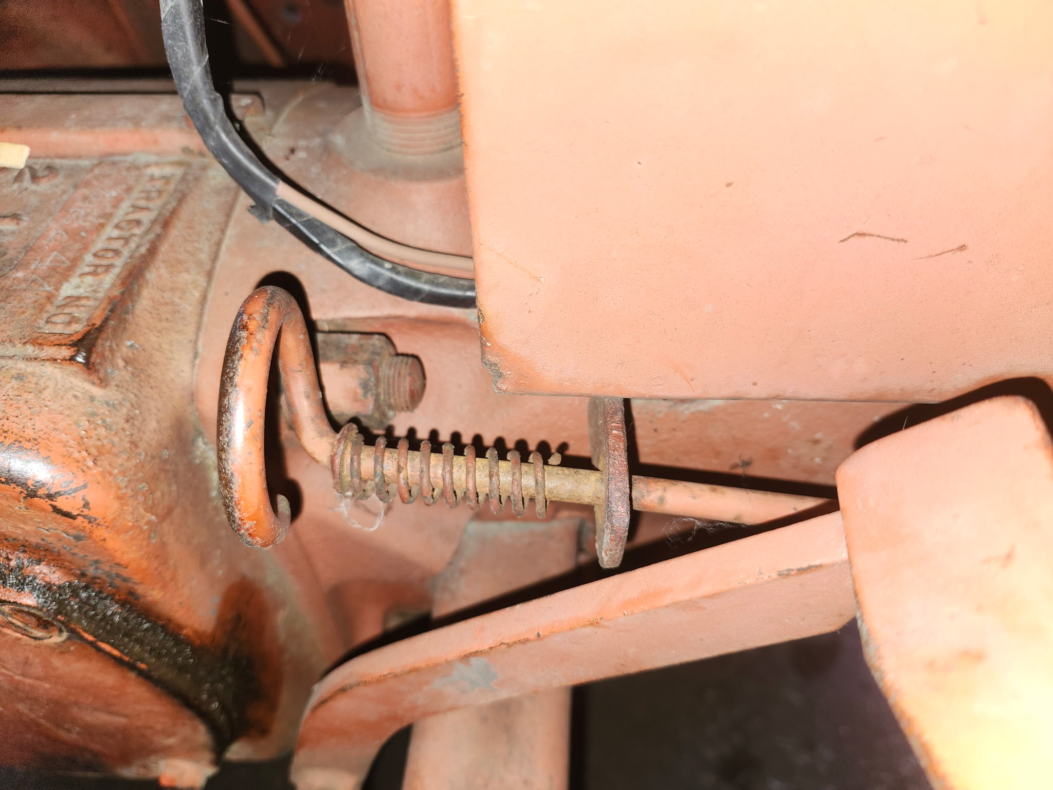

Post Options Post Options   Thanks (0) Thanks(0)   Quote plummerscarin Quote  Post ReplyReply Direct Link To This Post Posted: 17 Jun 2026 at 8:54pm
Here is mine.
It looks to me like your rod/lever setup lays a little flatter than mine. I suppose the washer and extra cotter pin acts as a stop so as to prevent the straight line push if you get my meaning
Edited by plummerscarin - 17 Jun 2026 at 9:02pm

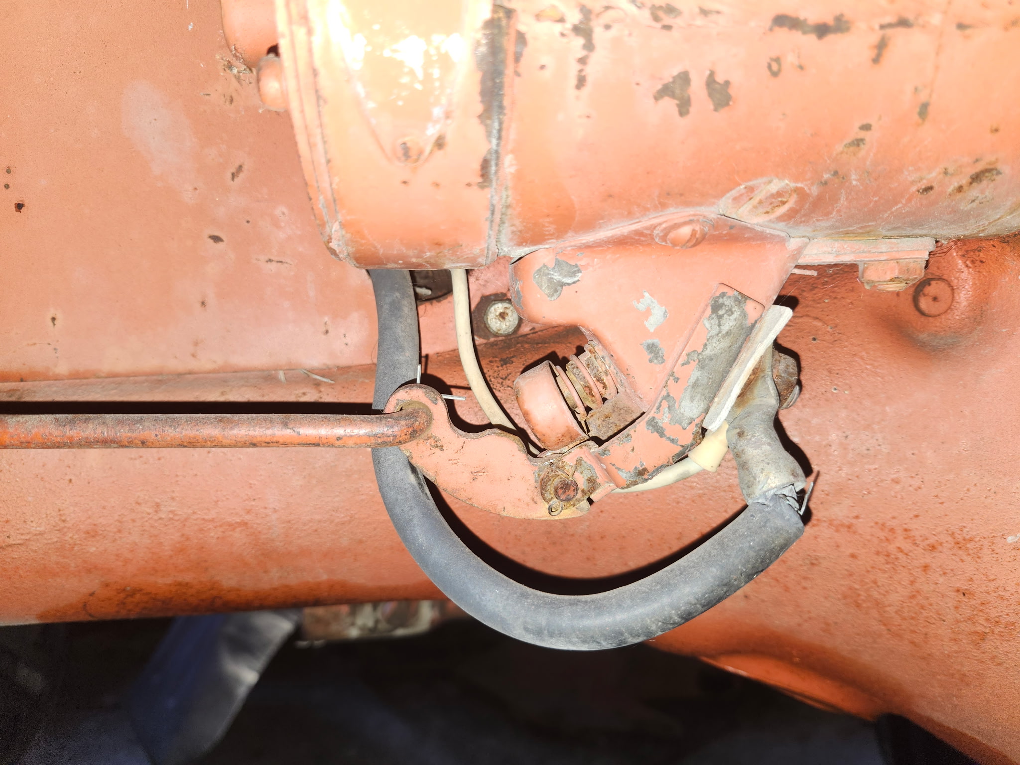

Post Options Post Options   Thanks (0) Thanks(0)   Quote john2189 Quote  Post ReplyReply Direct Link To This Post Posted: 17 Jun 2026 at 9:45pm
Your rod goes in the starter lever from the outside. Mine is from the inside, maybe my rod is just in backwards. I’ll change it and see if it makes a difference.

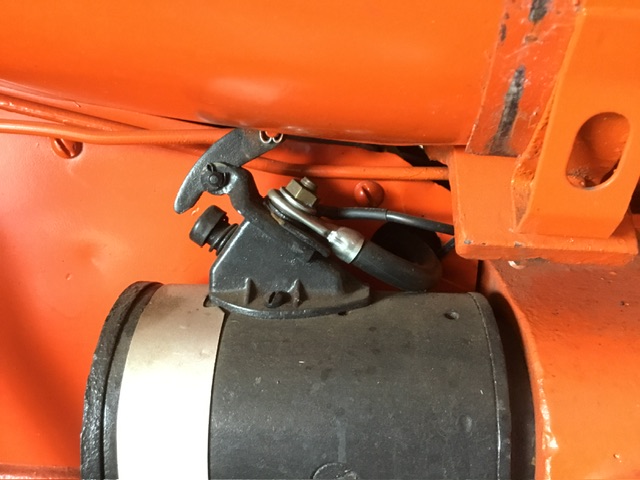

Post Options Post Options   Thanks (0) Thanks(0)   Quote HoughMade Quote  Post ReplyReply Direct Link To This Post Posted: 19 Jun 2026 at 12:09pm
Interesting. On my B, the button is on top and you pull the rod. Probably because mine is a later B. Seems like the configuration I have has better mechanical advantage.

Post Options Post Options   Thanks (0) Thanks(0)   Quote steve(ill) Quote  Post ReplyReply Direct Link To This Post Posted: 19 Jun 2026 at 4:27pm
note in JOHNS photo.... the SWITCH seems to have a CAST housing, instead of the standard sheet metal... and there is a BRUSH COVER STRAP around the  starter, similar to a generator.... neither of those is very common..

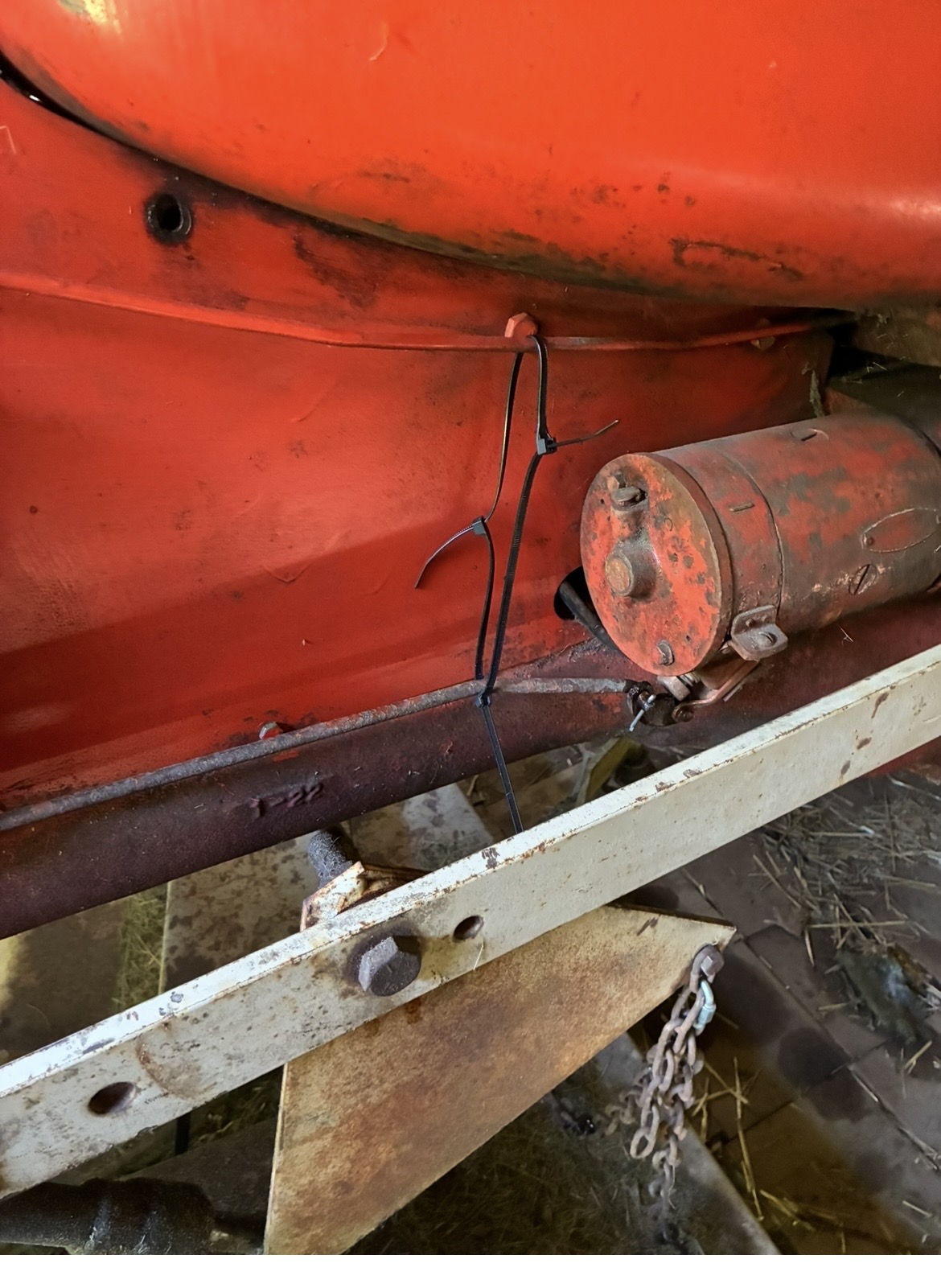

Post Options Post Options   Thanks (0) Thanks(0)   Quote john2189 Quote  Post ReplyReply Direct Link To This Post Posted: 19 Jun 2026 at 4:30pm

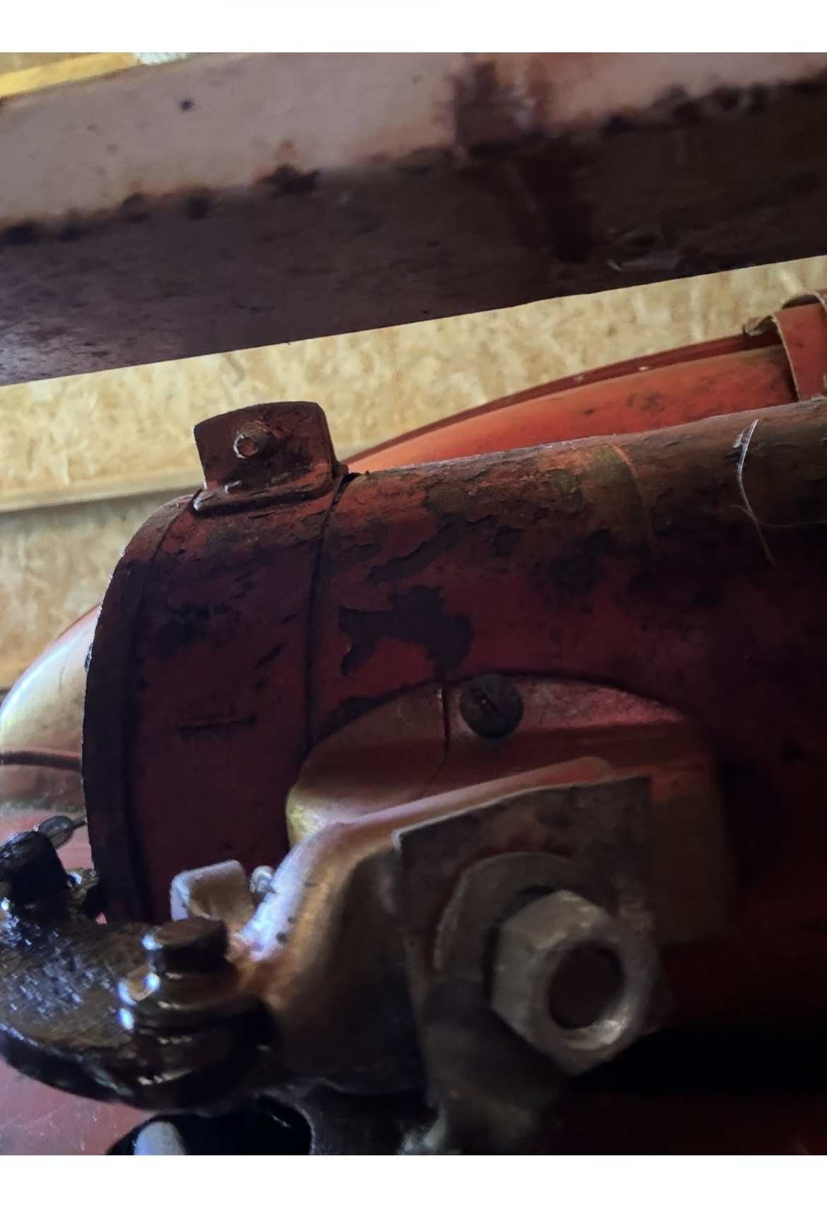

Works great now 🙂.

Post Options Post Options   Thanks (0) Thanks(0)   Quote john2189 Quote  Post ReplyReply Direct Link To This Post Posted: 19 Jun 2026 at 4:36pm
The switch is pressed steel and the brush cover is what was on it when I bought it, so I don’t know what it is supposed to be

Post Options Post Options   Thanks (0) Thanks(0)   Quote steve(ill) Quote  Post ReplyReply Direct Link To This Post Posted: 19 Jun 2026 at 4:44pm
OOOPS... i mean Hough photo that you reposted... That switch housing has gussets so it must be cast ??
Your tie strap lifting the rod , solves the problem... The problem was the rod PIN and the pivot PIN are too much in line with the starter rod... The two pins should be offset as much as possible.. 90 degrees is perfect.... but  zero or close to that would cause a bind...

Post Options Post Options   Thanks (0) Thanks(0)   Quote john2189 Quote  Post ReplyReply Direct Link To This Post Posted: 19 Jun 2026 at 5:26pm
Ok Steve, What is supposed to hold it up? What is missing? Or is the pins and holes worn causing slop?

Post Options Post Options   Thanks (0) Thanks(0)   Quote Alberta Phil Quote  Post ReplyReply Direct Link To This Post Posted: 19 Jun 2026 at 7:01pm
I've run into this issue a couple of times.  The little lever that pushes on the button gets worn and causes the lever to rest in more of a horizontal position, causing the problem you're having.  The lever has a stop on the underside where it rests against the pivot mount on the switch. I've had to build up the stop with weld on the small lever so it doesn't drop so low.  There were some replacement levers several years ago that had that little stop not made right and they would cause the exact problem you are having.
Build up the end of that lever and then grind or file it to a more pronounced shape and that should solve it.

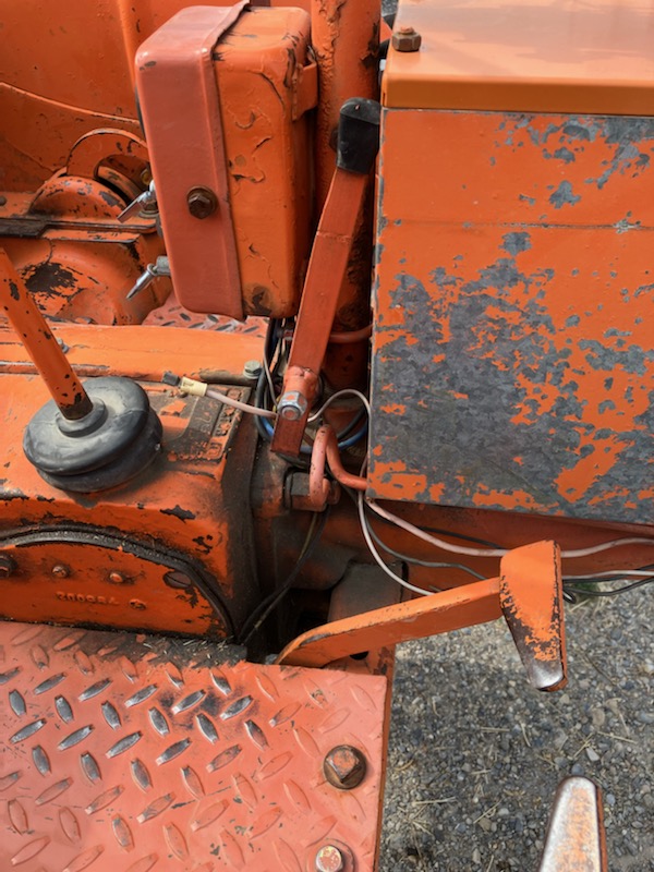

this is my c i fabbed a little lever  very user freindly  and looks like it belongs thier

Post Options Post Options   Thanks (0) Thanks(0)   Quote john2189 Quote  Post ReplyReply Direct Link To This Post Posted: 20 Jun 2026 at 12:55pm
The lever looks good. I like the floorboards, do they make it easier to get on and off?

Post Options Post Options   Thanks (0) Thanks(0)   Quote HudCo Quote  Post ReplyReply Direct Link To This Post Posted: 20 Jun 2026 at 10:05pm
same on the left side with a step on the left that was biult when the mower was mounted so it clears about every thing
