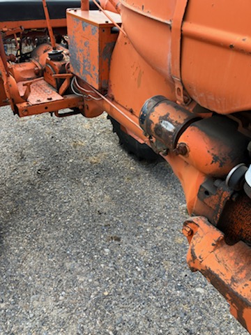

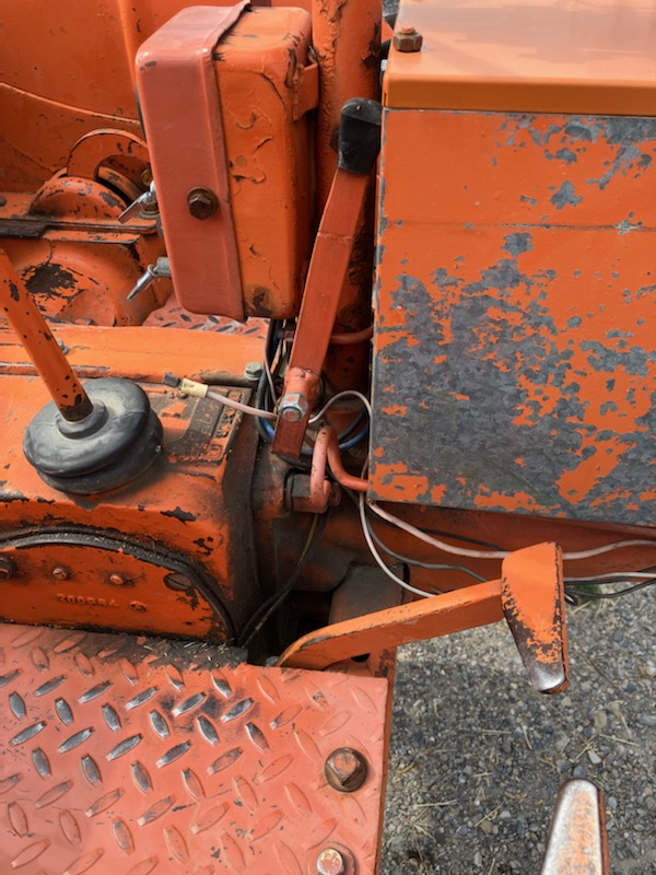

What is missing that holds the rod up to the starter button? It is very hard to push the rod when sitting on the seat. If you are standing next to it, you can hold the rod up.

The rod needs to moved slightly forward which in effect moves it slightly upward. Right now you have a straight line push against the lever that pushes on the starter button. You may need to drill a small hole in the rod and insert a cotter pin that will prevent the rod from retracting as much through the L bracket that mounts it to the torque tube. If that cotter pin is already there you can make a longer L bracket to accomplish this adjustment. HTH

Found this on fleabay. Where does the spring go? Mine does not have a spring. I can’t find any pictures of the rod the way it is supposed to be.

The spring goes between the 90 degree bend and the L bracket. It pushes the rod back away from the starter. I would use washer and cotter pin forward of the bracket to keep the rod from coming back too far.

Here is mine.
It looks to me like your rod/lever setup lays a little flatter than mine. I suppose the washer and extra cotter pin acts as a stop so as to prevent the straight line push if you get my meaning

Your rod goes in the starter lever from the outside. Mine is from the inside, maybe my rod is just in backwards. I’ll change it and see if it makes a difference.

note in JOHNS photo.... the SWITCH seems to have a CAST housing, instead of the standard sheet metal... and there is a BRUSH COVER STRAP around the  starter, similar to a generator.... neither of those is very common..

Works great now 🙂.

The switch is pressed steel and the brush cover is what was on it when I bought it, so I don’t know what it is supposed to be

OOOPS... i mean Hough photo that you reposted... That switch housing has gussets so it must be cast ??
Your tie strap lifting the rod , solves the problem... The problem was the rod PIN and the pivot PIN are too much in line with the starter rod... The two pins should be offset as much as possible.. 90 degrees is perfect.... but  zero or close to that would cause a bind...

Ok Steve, What is supposed to hold it up? What is missing? Or is the pins and holes worn causing slop?

I've run into this issue a couple of times.  The little lever that pushes on the button gets worn and causes the lever to rest in more of a horizontal position, causing the problem you're having.  The lever has a stop on the underside where it rests against the pivot mount on the switch. I've had to build up the stop with weld on the small lever so it doesn't drop so low.  There were some replacement levers several years ago that had that little stop not made right and they would cause the exact problem you are having.
Build up the end of that lever and then grind or file it to a more pronounced shape and that should solve it.

this is my c i fabbed a little lever  very user freindly  and looks like it belongs thier
