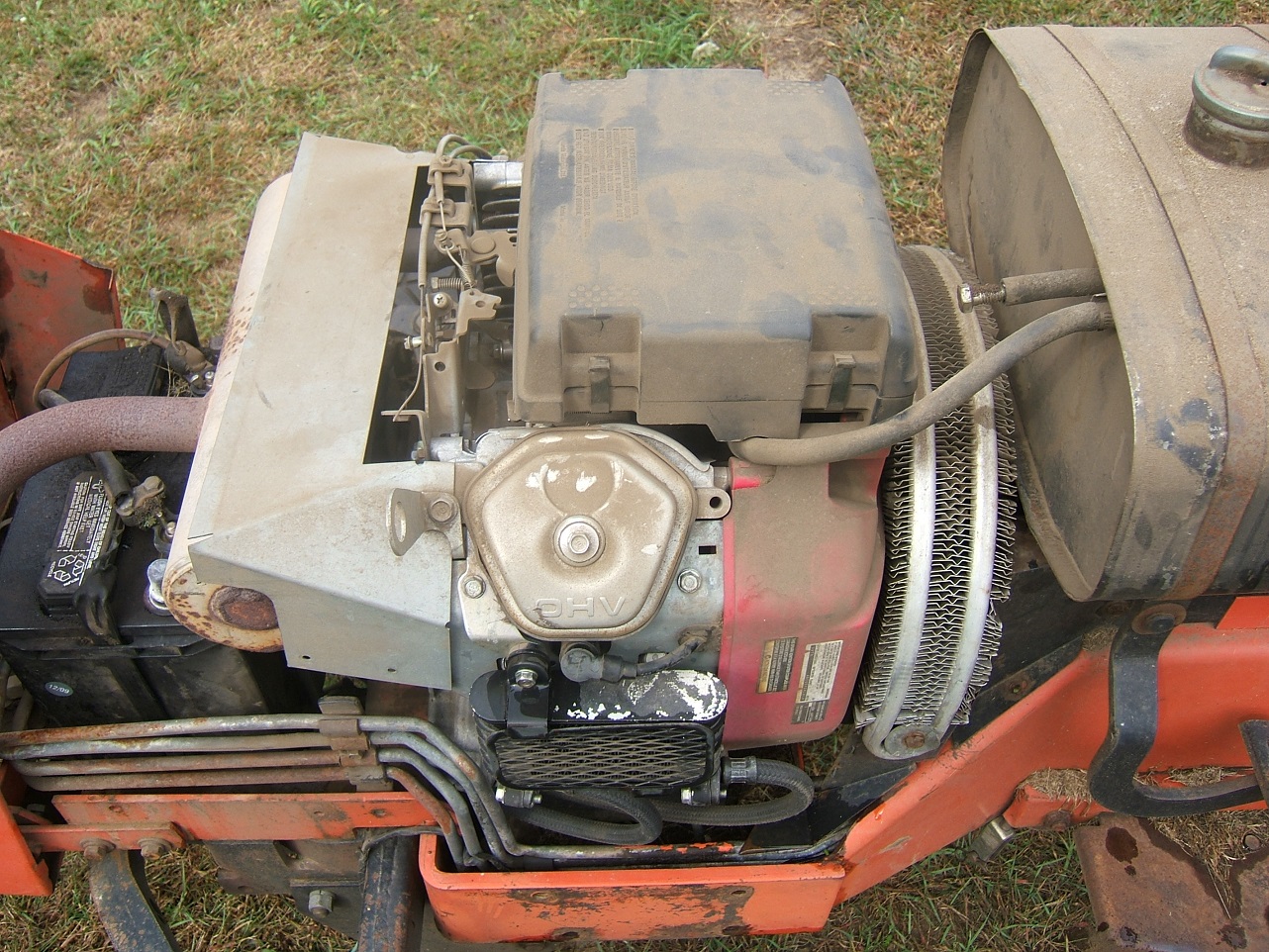

Complete repower 24 hp Honda kit. In tractor now. I am going bigger yet. The engine has new coils, 10 degree timing key, Carb gone through, Valves redone. Runs great. 1000.00 o.b.o. Thanks P.M. with replies

Not sure on the hrs. Cylinders looked great when the heads were off to do the valves. I will get pics later today. Valves were carboned up not burnt. Thanks

Posted: 17 Sep 2015 at 12:03pm |
fasstman
Joined: 07 Aug 2014 Location: Whitehall,WI Points: 150 |
Post Options
Thanks(0)
Quote Reply
Posted: 17 Sep 2015 at 12:05pm |
fasstman
Post Options
Thanks(0)
Quote Reply
Posted: 17 Sep 2015 at 12:06pm |
It's all dirty from dragging the fresh yard.

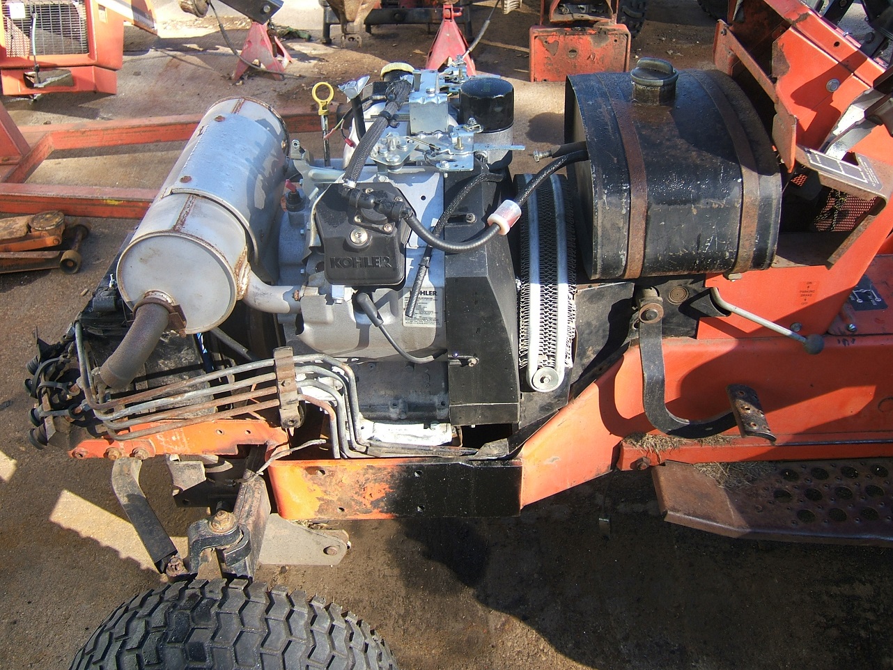

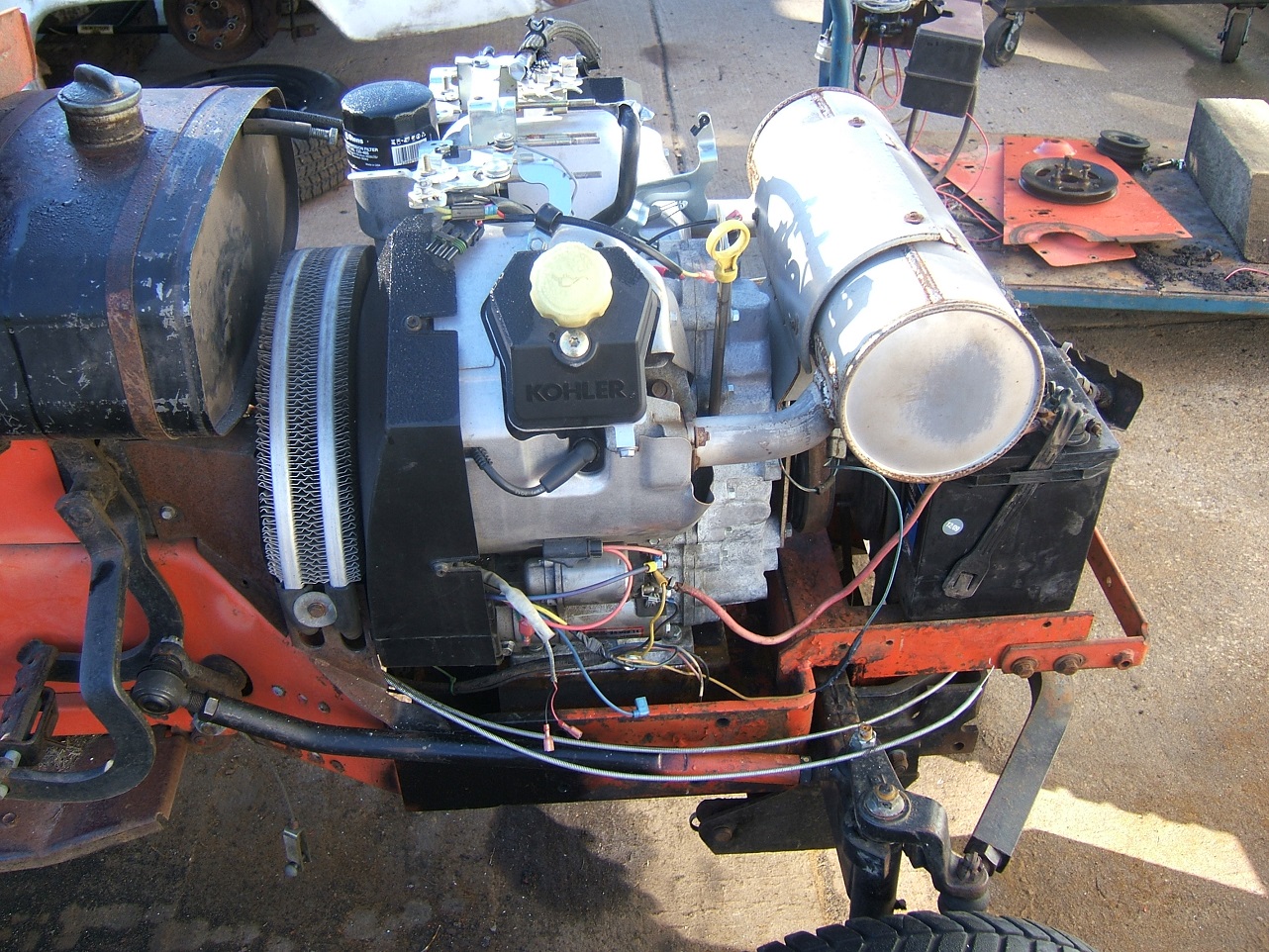

I am between Eau Claire and La Crosse. I put in a Kohler Command Pro 37 HP.

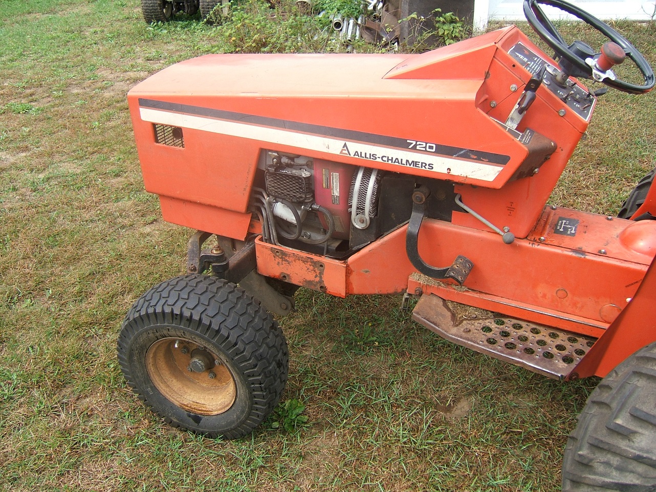

That big dude should make that 720 talk man! 37HP, my wife would like that.. LOL!

fasstman
Post Options
Thanks(0)
Quote Reply
Posted: 30 Sep 2015 at 5:14pm |
fasstman
Post Options
Thanks(0)
Quote Reply
Posted: 30 Sep 2015 at 5:19pm |
Still have front clutch and rear pto. Lengthened 3 1/16" and a 1 5/8" spacer between flywheel and pulley. Working on relocating air cleaner. I need another hood if someone has a spare.

Posted: 30 Sep 2015 at 6:01pm |
I once worked my stock 620 hard enough to have the transmission oil temp light come on. How is it going to handle 17 more horsepower. What is driving the quest for more power? With a handle like Fasstman, is
it the more speed, more power philosophy? The air cleaner looks like a tight fit. Is that why you need a new hood, will it have to be reworked? We had some pictures posted here showing extended 720 (3cyl diesels). They must of had to make new hoods. Perhaps contact that poster for hood info, maybe they have a sheet metal wizard contact. How is the vibration and smoothness and sound of these v-twins compared to the opposed Onan? Looks like you can get to the started with out pulling the engine, yeah. |

Posted: 30 Sep 2015 at 6:42pm |
I just like power and because I can do it. The engine is smoother and more quiet than the onan. I am relocating the air cleaner for space.

Posted: 01 Oct 2015 at 7:13pm |
OH YEAH! Now yer' talkin' ! Looks great Trev! Tight but fits. How's it go?

Posted: 01 Oct 2015 at 7:27pm |
Goes fine. You can just idle up hill with hydro in full forward in third gear and engine hardly even knows it. Just about have the mower deck mods done. Have the air cleaner relocated. Still looking for a hood.

Posted: 02 Oct 2015 at 10:13am |
thats a good price for your honda , how much did you have to strech the frame , will you have to widen the hood to fit the valve covers
fasstman
Post Options
Thanks(0)
Quote Reply
Posted: 02 Oct 2015 at 1:20pm |
3 1/16" stretch and I will have to lengthen and widen the hood. I am tring to get stuff low enough so I don't raise the hood.

Posted: 04 Oct 2015 at 7:47pm |
I just painted my hood, and man, let me tell ya, those hoods are looong! LOL! Adding another 3+ inches is gonna make it look like a Funny Car body. LOL!
