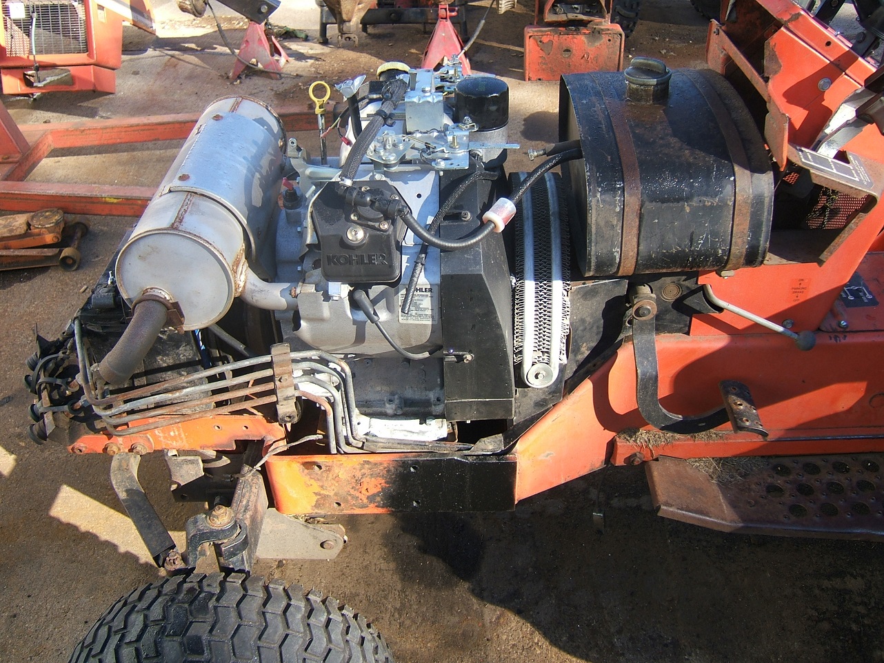

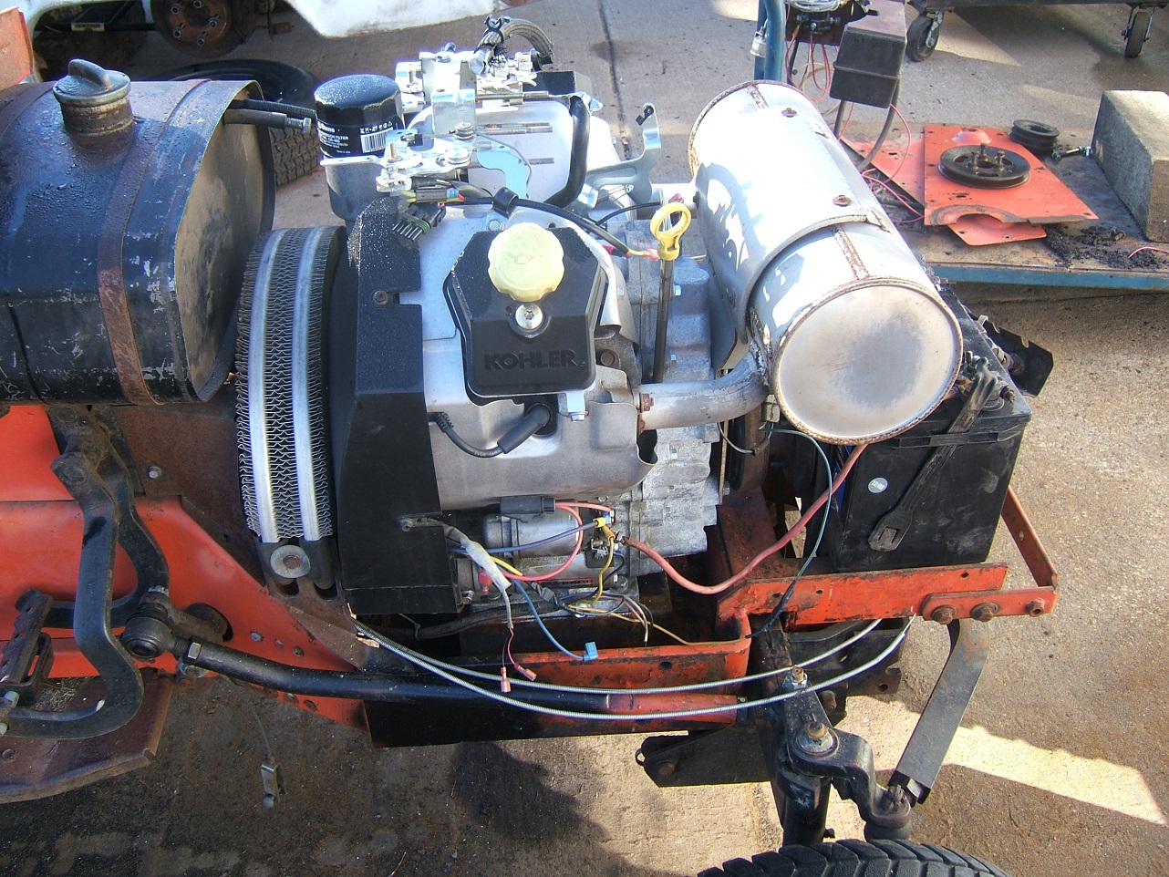

Date Posted: 30 Sep 2015 at 5:14pm
Posted By: fasstman
Date Posted: 30 Sep 2015 at 5:19pm
Still have front clutch and rear pto. Lengthened 3 1/16" and a 1 5/8" spacer between flywheel and pulley. Working on relocating air cleaner. I need another hood if someone has a spare.
Posted By: BrianC
Date Posted: 30 Sep 2015 at 6:01pm
I once worked my stock 620 hard enough to have the transmission oil temp light come on. How is it going to handle 17 more horsepower. What is driving the quest for more power? With a handle like Fasstman, is
it the more speed, more power philosophy?
The air cleaner looks like a tight fit. Is that why you need a new hood, will it have to be reworked? We had some pictures posted here showing extended 720 (3cyl diesels). They must of had to make new hoods. Perhaps contact that poster for hood info, maybe they have a sheet metal wizard contact.
How is the vibration and smoothness and sound of these v-twins compared to the opposed Onan? Looks like you can get to the started with out pulling the engine, yeah.

I just like power and because I can do it. The engine is smoother and more quiet than the onan. I am relocating the air cleaner for space.

OH YEAH!  Now yer' talkin' !  Looks great Trev!  Tight but fits. How's it go?
Posted By: fasstman
Date Posted: 01 Oct 2015 at 7:27pm
Goes fine. You can just idle up hill with hydro in full forward in third gear and engine hardly even knows it. Just about have the mower deck mods done. Have the air cleaner relocated. Still looking for a hood.

thats a good price for your honda ,   how much did you have to strech the frame , will you have to widen the hood to fit the valve covers
Posted By: fasstman
Date Posted: 02 Oct 2015 at 1:20pm
3 1/16" stretch and I will have to lengthen and widen the hood. I am tring to get stuff low enough so I don't raise the hood.

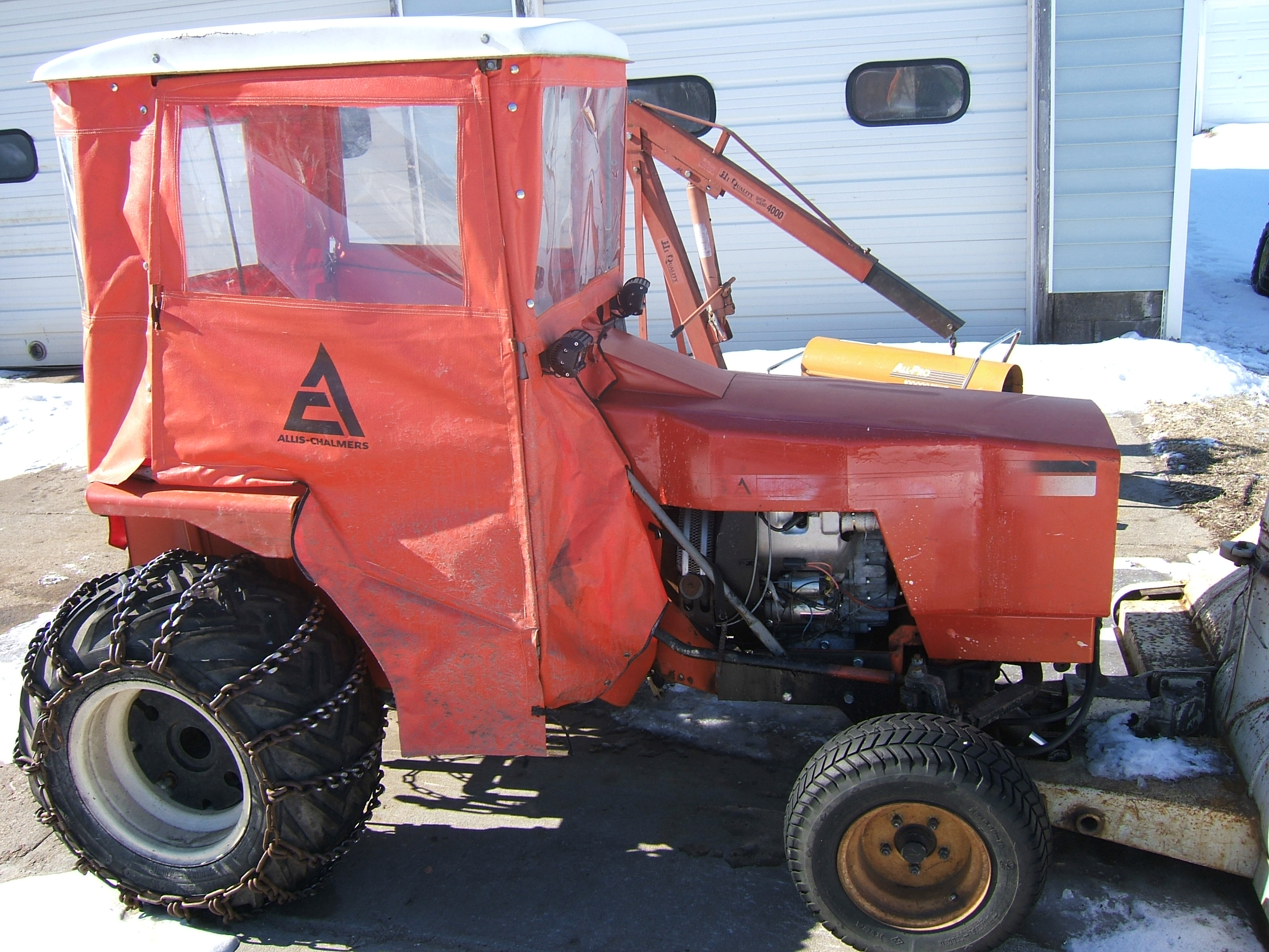

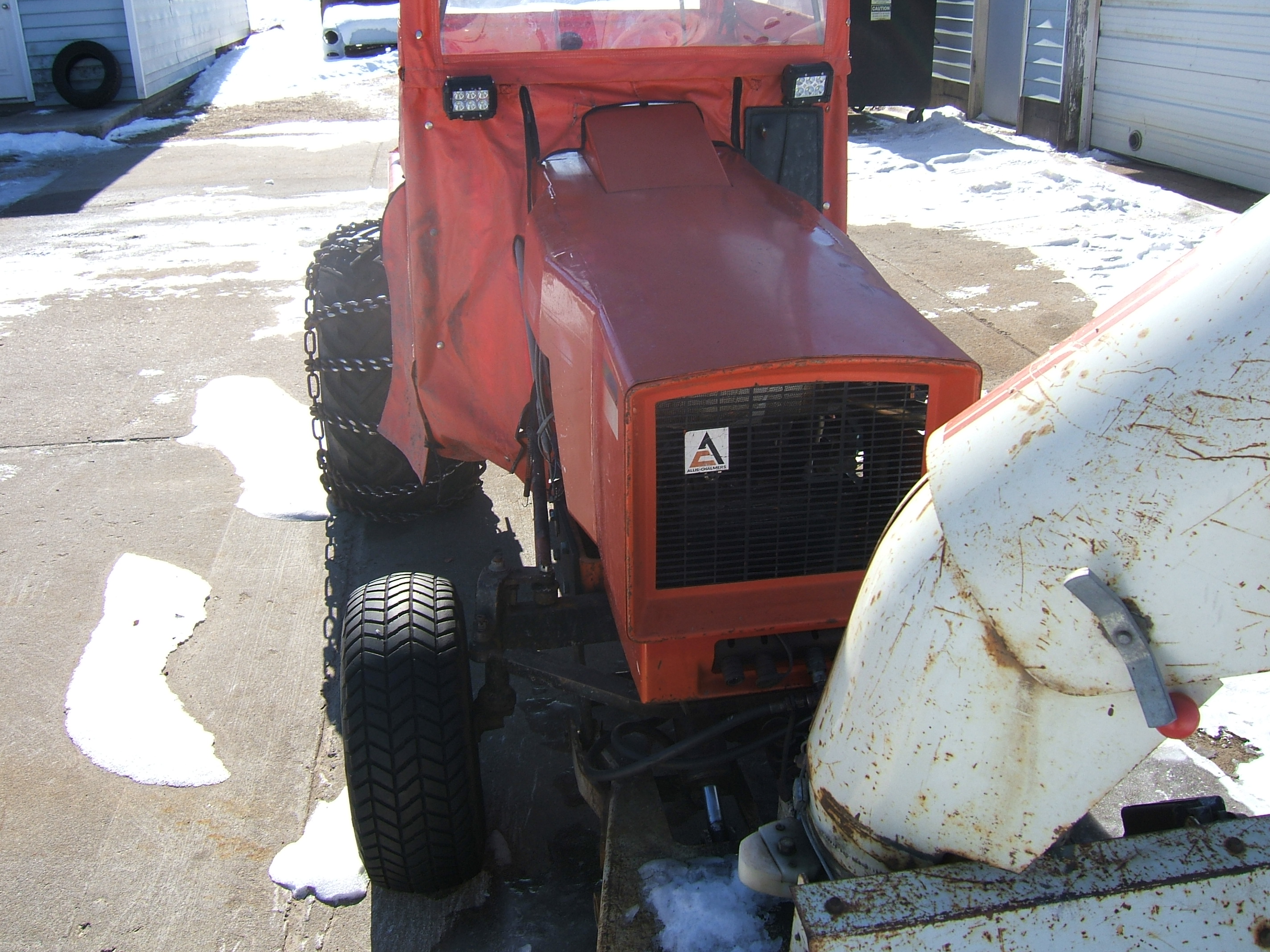

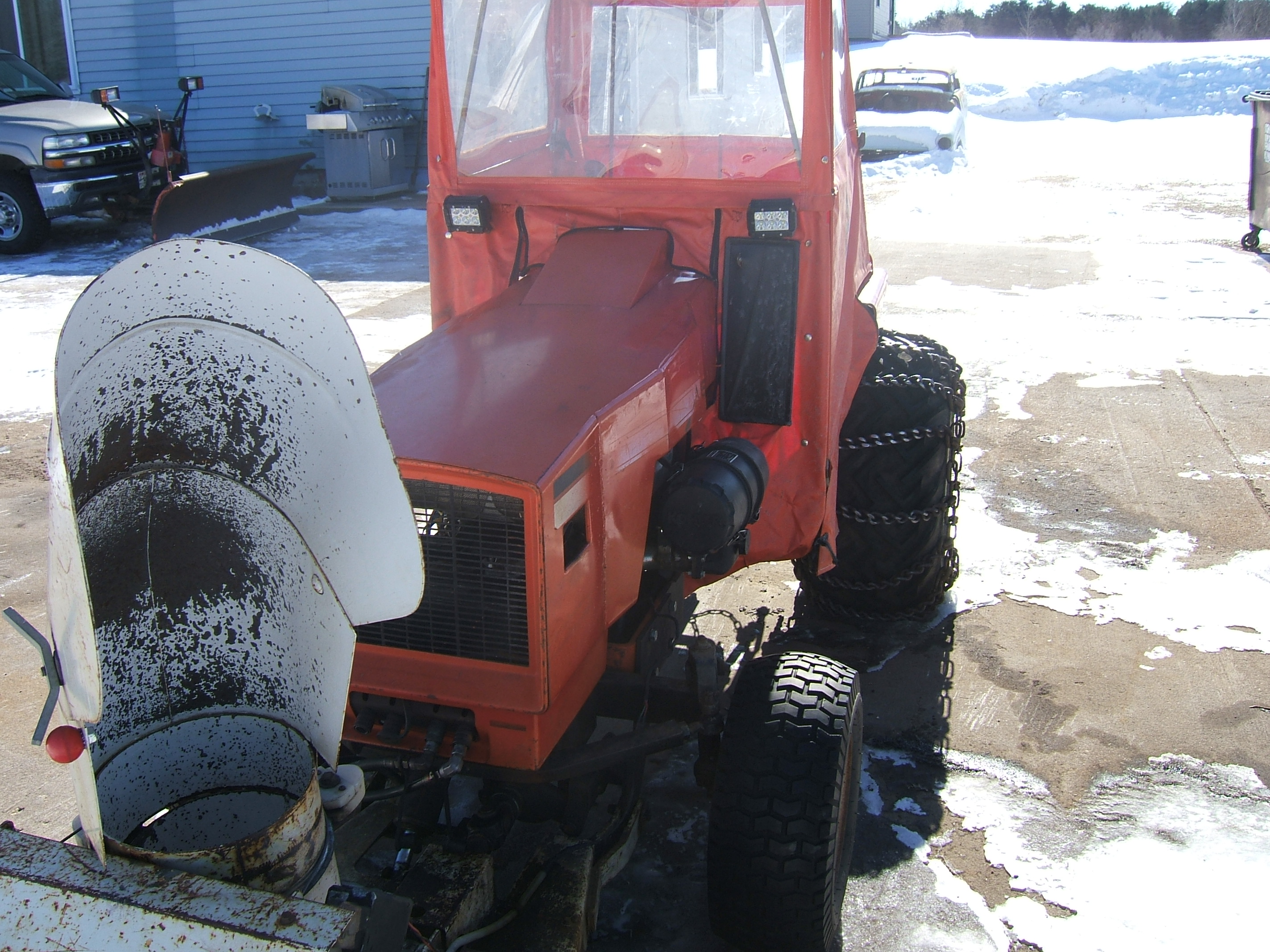

Hope i don't have heat problems. I header rapt the muffler seems to work good. The hood is widened and longer. I still have to do body work and paint. I will try to get some pics. It's cold around here now.
Posted By: fasstman
Date Posted: 13 Feb 2016 at 12:29pm
Posted By: fasstman
Date Posted: 16 Feb 2016 at 4:15pm
People wanted to see pics. here they are

Posted By: HudCo
Date Posted: 16 Feb 2016 at 10:16pm
 i sure like that winter cab what part #  it  probley very hard to find
Posted By: fasstman
Date Posted: 18 Feb 2016 at 8:45am
Looks like 9000022 allis #.
