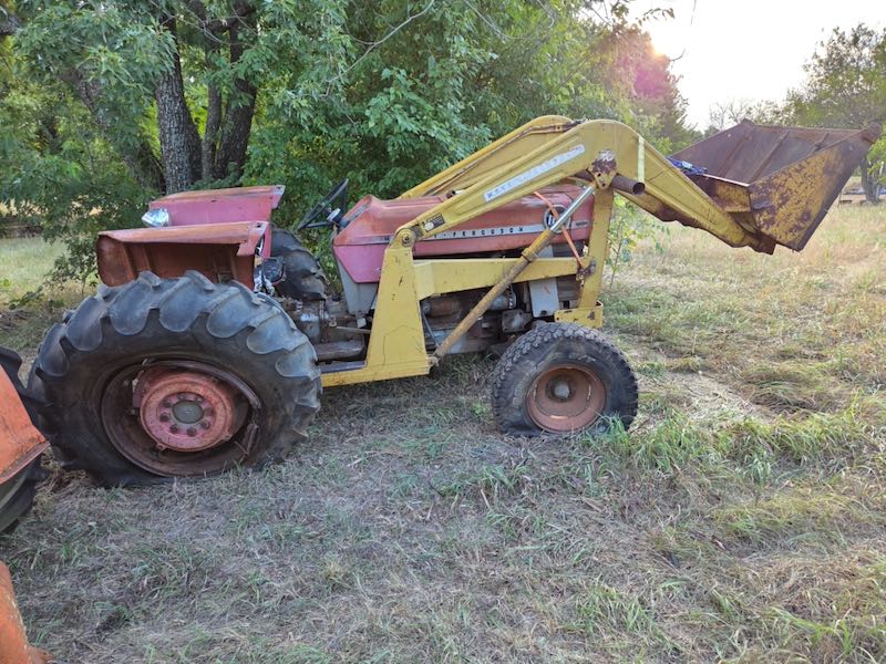

Assuming the bolt pattern is correct, if the wheel pilot hole is too large the studs/bolts will suffice for temporary loading and hauling, and if the wheel pilot is too small then longer bolts/studs would still hold the tractor up for transport.
True. For loading and unloading that is a good point... It should be fine even if the pilot doesn't fit or is too small.
Figured someone on here has probably stolen MF wheels for their AC, or vice-versa, and may know for sure...

My experience with trying to put MF wheels on a WD 45 was that the lug bolts are a different size. MF 165 was a good tractor except the multipower was difficult to keep operating and the power steering was not very good. P/S was expensive to repair and somewhat complicated, especially if you did not have experience working on it.

Originally posted by ac-mike ac-mike wrote:
My experience with trying to put MF wheels on a WD 45 was that the lug bolts are a different size...
Hmmm... if the MF bolts are bigger it may not be possible to mount WD45 wheels even for transport Cry
Thanks for calling that to my attention. I looked at the AGCO parts catalog and those are interesting... piloted (?) lug nuts. Not sure what the correct name is. It says the studs are 5/8 UNF... The WD wheels I have appear to be 5/8" holes, and use 9/16" lug bolts, so I wonder if it would just barely work if I get some normal tapered lug nuts and don't use the piloted MF ones. I guess things would have to be perfectly lined up. Probably shouldn't count on this plan as I think more about it. I may be just winching it up onto the trailer on the wheel hub.

To close the loop on this - I wound up just winching the tractor up on the rotten rim and it just barely held up long enough to get it on and off the trailer. I will try to remember to take some pictures of the wheel nuts and the bolt hole diameter in the hubs when I find some rims for this tractor and get to work on it.
Long story short I believe you would need to swap wheel centers between AC and MF. That probably explains the set of AC centers the seller had that he got with it when he bought the tractor... The guy he bought from probably found a set of complete wheels/tires from an AC tractor and then put the rims/tires on the MF, and had the centers leftover. Hopefully that helps some MF/AC guys in the future if they find this thread.
This tractor has the Perkins diesel and the Multipower transmission. The engine is loose. The serial number on the dash is out of the 165 SN range, and into the 265, so I can only guess someone swapped a dash/instrument panel over from a 265? Anyway, if it doesn't need an engine rebuild, there's a good chance I'll get to it before either of my 170s w/ loaders.

What is the serial number?  It looks like the 1975 MF 165 and MF 265 tractors had the same starting serial number range.  If it is prior to 9A232539 (the first 1976 265 serial number) it would be a 1975 MF 165.
I would get the right rims and keep the cast centers they mount on.
This is 9A227731. I was confused because all of the sources online currently show that the first 265 was 9A202190 in 1974, but your info indicates this is a case where the internet is wrong. This would make a lot more sense if mine were a very late 165.
Where did you find the more accurate SN info? The MF manuals I got with the tractor were probably printed before the 265 came out so they don't have that info.
I will definitely be keeping those heavy cast centers on it.

I have some Massey Fergusons.  I looked at Tractor Data for the MF 165 and MF 265 serial number ranges.  MF used a starting number for a year, and that starting number was the same for a number of models.  They did not give each model its own individual range of serial numbers.  Thus, the early MF265 serial numbers run along with the late MF 165s.
Multipower will free wheel (no engine hold back) in low.  High will hold back; you learn to get into high multi-power heading down hill.  Headed up hill in high if you push the clutch, it will not roll back.  Shifting into Low multi-power will generally allow for easier shifting of gears.
Proper clutch adjustment is a major factor with two stage clutches.  That means linkage/pedal adjustment and the release bolts of the second (PTO) stage pressure plate release bolts adjustment.
