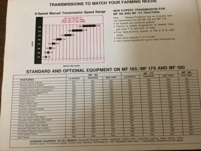

Posted By: Ed (Ont)
Date Posted: 05 Apr 2026 at 7:30pm
Posted By: Ed (Ont)
Date Posted: 05 Apr 2026 at 7:31pm
Posted By: Ed (Ont)
Date Posted: 05 Apr 2026 at 7:34pm
Posted By: Ed (Ont)
Date Posted: 05 Apr 2026 at 7:37pm

WJohn, looking at Ed (Ont)’s posted brochure photos, seems the Mf165 uses 8 bolt rear wheels? If in a pinch, an older gleaner (E,A,K?) 8 bolt drive wheel/tire combo might bolt right up to it?

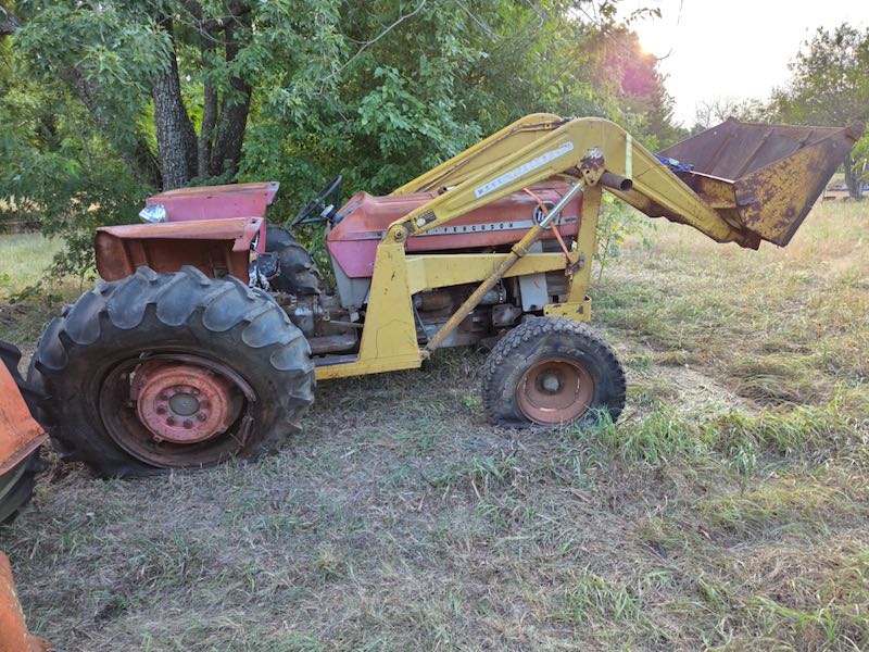

To close the loop on this - I wound up just winching the tractor up on the rotten rim and it just barely held up long enough to get it on and off the trailer. I will try to remember to take some pictures of the wheel nuts and the bolt hole diameter in the hubs when I find some rims for this tractor and get to work on it.
Long story short I believe you would need to swap wheel centers between AC and MF. That probably explains the set of AC centers the seller had that he got with it when he bought the tractor... The guy he bought from probably found a set of complete wheels/tires from an AC tractor and then put the rims/tires on the MF, and had the centers leftover. Hopefully that helps some MF/AC guys in the future if they find this thread.
This tractor has the Perkins diesel and the Multipower transmission. The engine is loose. The serial number on the dash is out of the 165 SN range, and into the 265, so I can only guess someone swapped a dash/instrument panel over from a 265? Anyway, if it doesn't need an engine rebuild, there's a good chance I'll get to it before either of my 170s w/ loaders.

What is the serial number?  It looks like the 1975 MF 165 and MF 265 tractors had the same starting serial number range.  If it is prior to 9A232539 (the first 1976 265 serial number) it would be a 1975 MF 165.
I would get the right rims and keep the cast centers they mount on.
