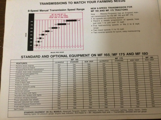

Ed (Ont)
Joined: 08 Nov 2009 Location: New Lowell, Ont Points: 1676 |
Post Options
Thanks(0)
Quote Reply
Posted: 05 Apr 2026 at 7:31pm |
Ed (Ont)
Post Options
Thanks(0)
Quote Reply
Posted: 05 Apr 2026 at 7:34pm |
Ed (Ont)
Post Options
Thanks(1)
Quote Reply
Posted: 05 Apr 2026 at 7:37pm |
Ed (Ont)
Post Options
Thanks(1)
Quote Reply
Posted: 05 Apr 2026 at 7:48pm |
I am surprised at some of the responses. We had zero problems with our unit. But it was purchased new and we did not abuse it. It had an Allied loader on it - dealer installed. I did a bit of work on my friends MF175 about 4 yrs ago. Water pump and thermostat, some new belts and oil change. Got all parts from my Agco dealer in a couple days. Price was fair and parts correct.
