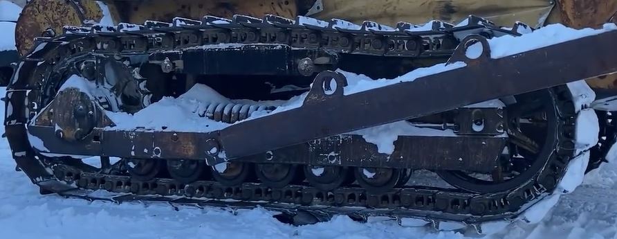

Pic below of the oak skid track carrier is on his D6 'Hood" crawler.    It shouldn't be to hard to make something like that to support the rail.
  Guess the biggest thing for the HD19 is to get the front idler assembly repaired and the slack adjusters working again and tighten the assembly up and get the slack out of the chain.  and maybe find a whole top roller assemblyin good shape.
