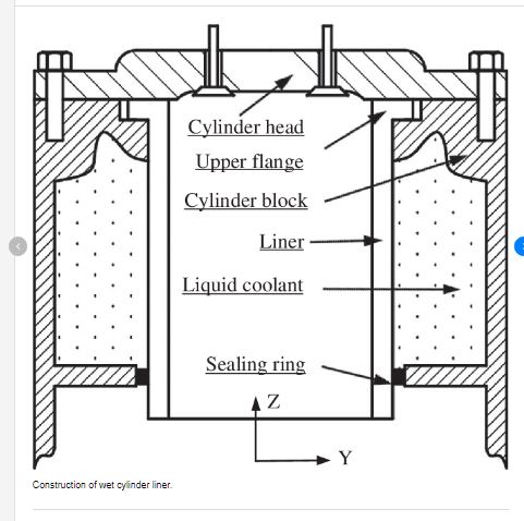

Post Options Post Options   Thanks (0) Thanks(0)   Quote steve(ill) Quote  Post ReplyReply Direct Link To This Post Posted: 03 May 2023 at 12:34pm
hunter... just for reference , here is a drawing of a "wet sleeve"... you can see the sleeve pilots into the block at the top, and seals with an o-ring at the bottom ... If you MOVE the sleeve up 1/2 inch, it pops free..

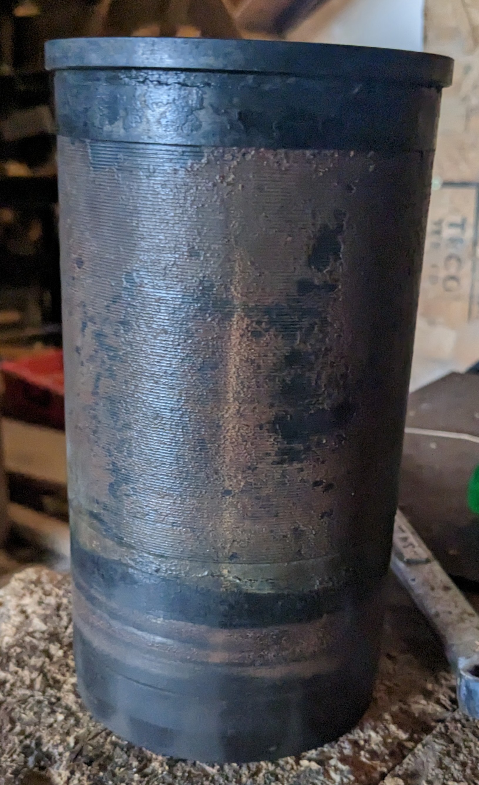

Post Options Post Options   Thanks (0) Thanks(0)   Quote hunter321 Quote  Post ReplyReply Direct Link To This Post Posted: 11 May 2023 at 8:19am
This is the piston sleeve I have
Points: 9240
Post Options Post Options   Thanks (0) Thanks(0)   Quote SteveM C/IL Quote  Post ReplyReply Direct Link To This Post Posted: 11 May 2023 at 8:46am
Wrong...that had orings in the block not the sleeve.
