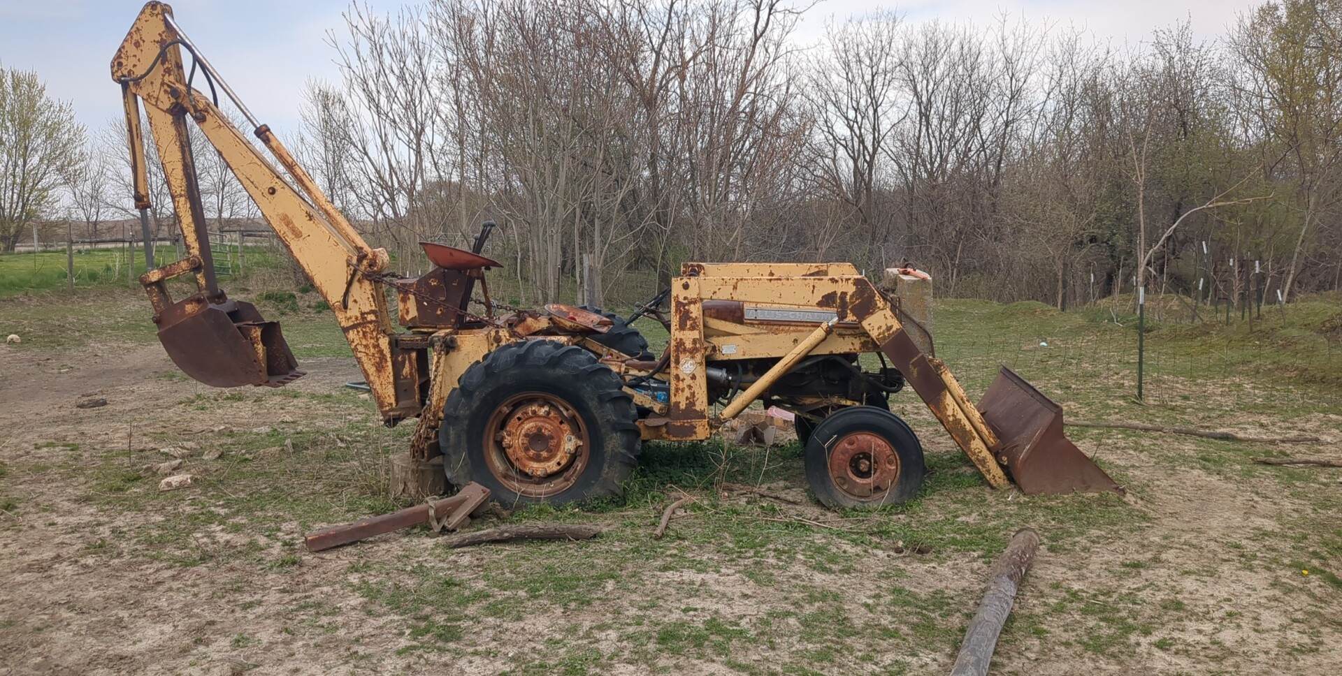

Forgot to mention this is a d12 industrial with a back hoe and loader

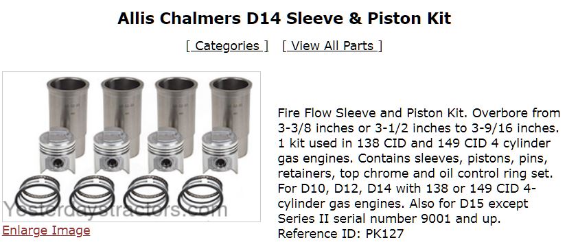

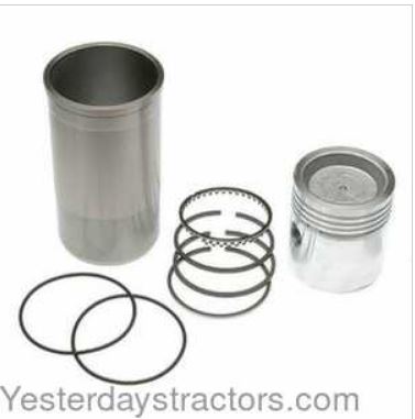

Date Posted: 27 Jun 2022 at 12:32pm
https://www.google.com/shopping/product/1?q=allis+chalmers+d12+aftermarket+piston+head&client=ms-android-verizon&biw=360&bih=647&tbs=vw:g&sxsrf=ALiCzsbI__rBUhOSvHxmyEH7QSpxud5KJg:1655326403209&prds=epd:8886771715549346648,pid:8886771715549346648,prmr:1,cs:1" rel="nofollow - https://www.google.com/shopping/product/1?q=allis+chalmers+d12+aftermarket+piston+head&client=ms-android-verizon&biw=360&bih=647&tbs=vw:g&sxsrf=ALiCzsbI__rBUhOSvHxmyEH7QSpxud5KJg:1655326403209&prds=epd:8886771715549346648,pid:8886771715549346648,prmr:1,cs:1
I found this
Posted By: DrAllis
Date Posted: 27 Jun 2022 at 2:08pm
That isn't what the other three look like is it ??????? They have to match in looks and bore size !!

Date Posted: 14 Feb 2023 at 2:34pm
is the pistion sleeve flush with the bottom of the engine block or is there a lip
Posted By: Gary
Date Posted: 14 Feb 2023 at 7:41pm
No the sleeve is not flush with the block at the lower end of the Liner.
The Liner protrudes probably more than an inch.
I would fabricate a lower pulling plate at least 4 1/2" diameter so you will be able to use it on other Engines, Eg WD with 4" pistons.
G

Posted By: hunter321
Date Posted: 01 May 2023 at 8:08pm
The sleeves are wet sleves
Date Posted: 01 May 2023 at 8:23pm
Is there anyway to not pull the engine and still replace the sleeve
Posted By: HudCo
Date Posted: 01 May 2023 at 10:02pm
you will probley have jack up one side of the front axle to get the pan out or remove the front axle to get the pan off then you can in frame it  but you need to mesure the crank journals you may have to pull it any ways to have crank work done
Date Posted: 03 May 2023 at 10:36am
I'm not sure if the sleeve I have is a wet sleeve or not. How do I tell.
If the replacement is not a wet sleeve I will need a new sleeve and Piston again
Posted By: steve(ill)
Date Posted: 03 May 2023 at 12:29pm
all of the small Allis engines are wet sleeve... You are going to have problems jacking the sleeve out from the bottom, etc, with the crank in the way..  You should be able to pull from the top with a puller. Sleeve only needs to move up about 1/2 inch and then it will lift out easier..
In the end, i would pull the motor and lift the crank out.. Sounds like a lot of work, but you will learn a LOT OF INFO for future jobs... A couple of extra weeks now "in the shop" will be good in the long run.
