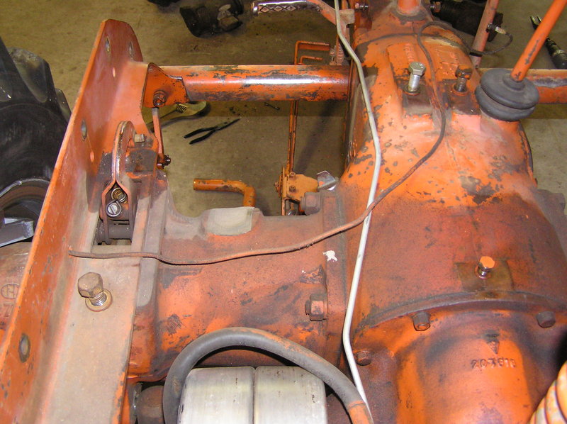

Post Options Post Options   Thanks (0) Thanks(0)   Quote Dakota Dave Quote  Post ReplyReply Direct Link To This Post Posted: 22 Mar 2012 at 4:15pm
Your correct no wire cover on a CA. Just a C and B., here is a picture. You notice I have no wire to the left side.  only to the right since I had a combo work tail light I took the left tail light off. Its easy to route the wire with the platform on since its not attached anyplace.

Post Options Post Options   Thanks (0) Thanks(0)   Quote JarrodACFan Quote  Post ReplyReply Direct Link To This Post Posted: 22 Mar 2012 at 6:18pm
Okay, I see the groove where it needs to be ran, thanks. If it would have been a snake, it would have bit me!
